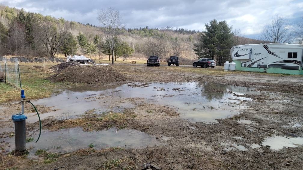

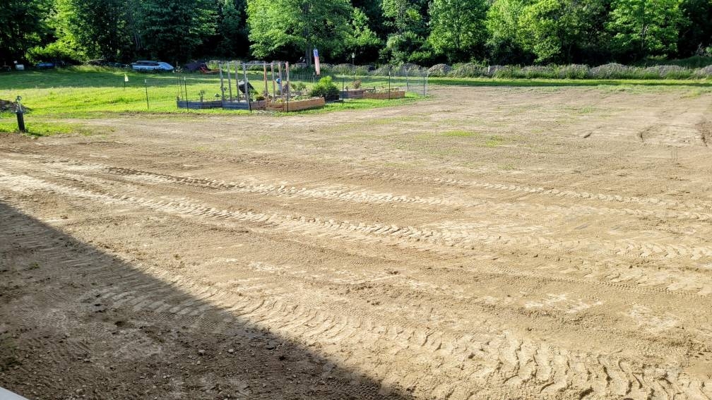

+1 on the 3pt Harley Rake. Found it on Marketplace, but it took a while before a usable one showed up. Before and after pics.

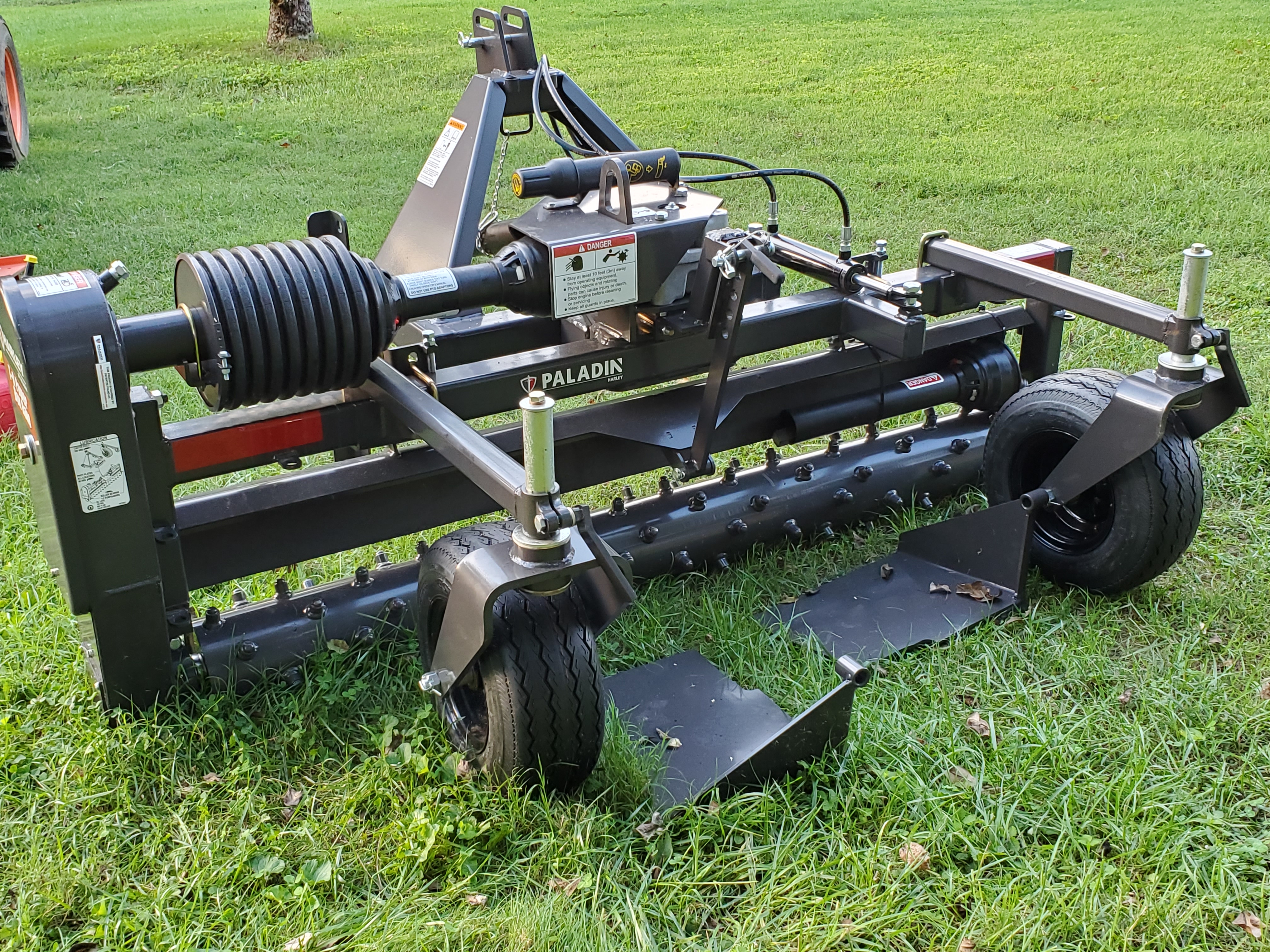

BackRoad, nice job and probably pretty quick with the 8 foot rake.
Here is pic of my rake just after receipt. I wonder how the two rakes compare given different soil types and buried debris ( rocks, roots, etc)? Your drum has bars whereas mine has carbide tipped studs.

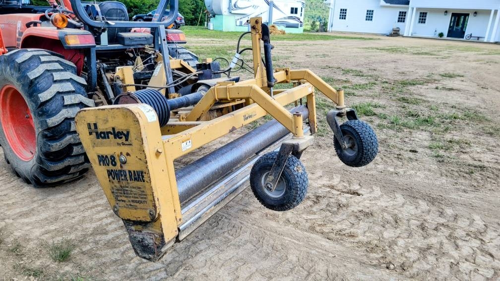

You've got a much newer version! Very nice!
If my understanding is correct, Paladin bought the the Harley Rake line from Glenmac about 2005 and mine is a Glenmac built, yours is newer and updated, made by Paladin.
Only mentioning this, as I've seen older Glenmac built units for sale which need a bit of TLC.
For mine, I had to replace a critical bearing assembly holding one end of the bottom roller. Even though they didn't build the original rake, Paladin was able to machine the new replacement part in about a week which bolted right up (but the part was not cheap!)
