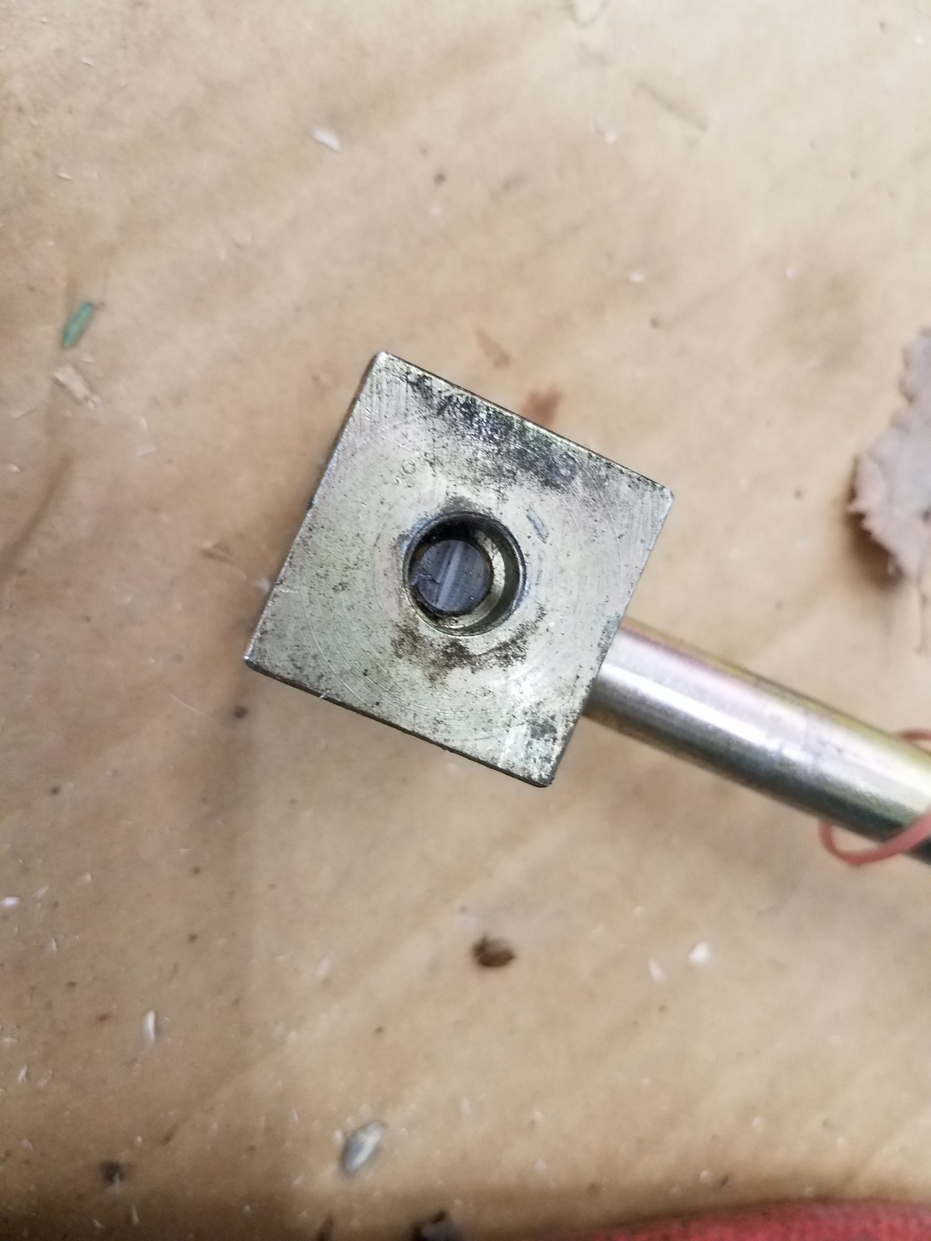

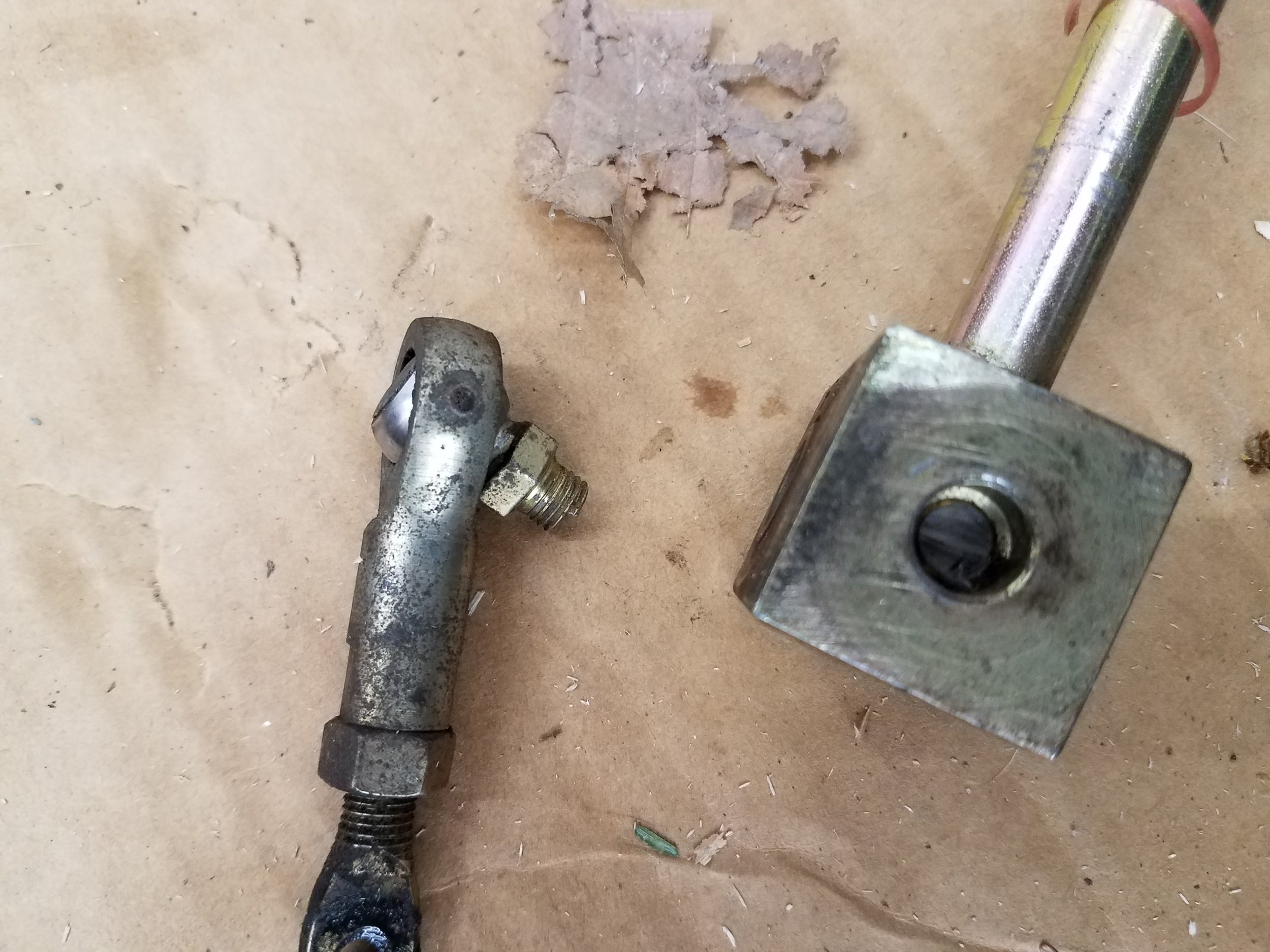

2000 or 2001 L3710.
I'm not exactly sure what to call these parts to be able to do a proper search:
control valve lever? the lever that maneuvers the bucket. as you can see, that heim joint broke off. and something tells me I'm not going to be successful getting that broken bit out of the lever itself. tractor's stuck where it is with a 9' plow on the ground. I may be able to welder or fab something up to get it to work in the meantime, but I really need to get this going.
Thanks.

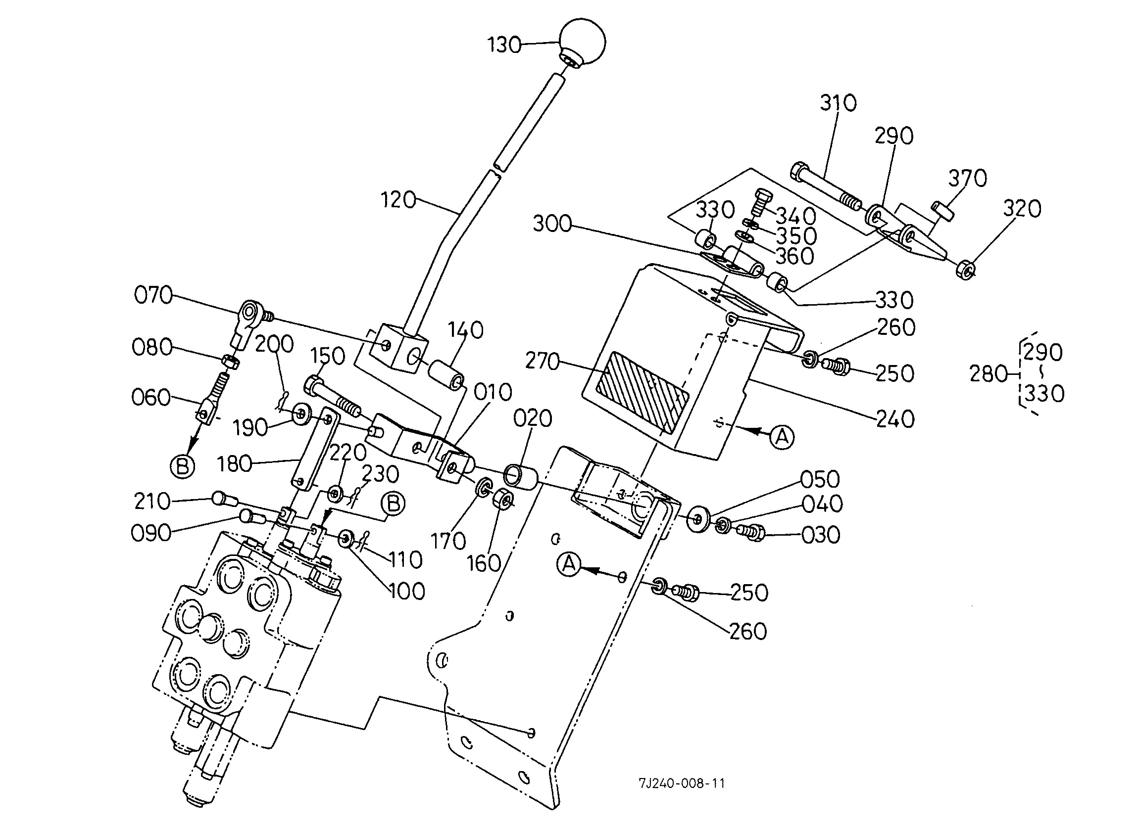

So I punch all that in, and right after I find that its the FEL, not exactly the tractor I need to look for.
LA6841.

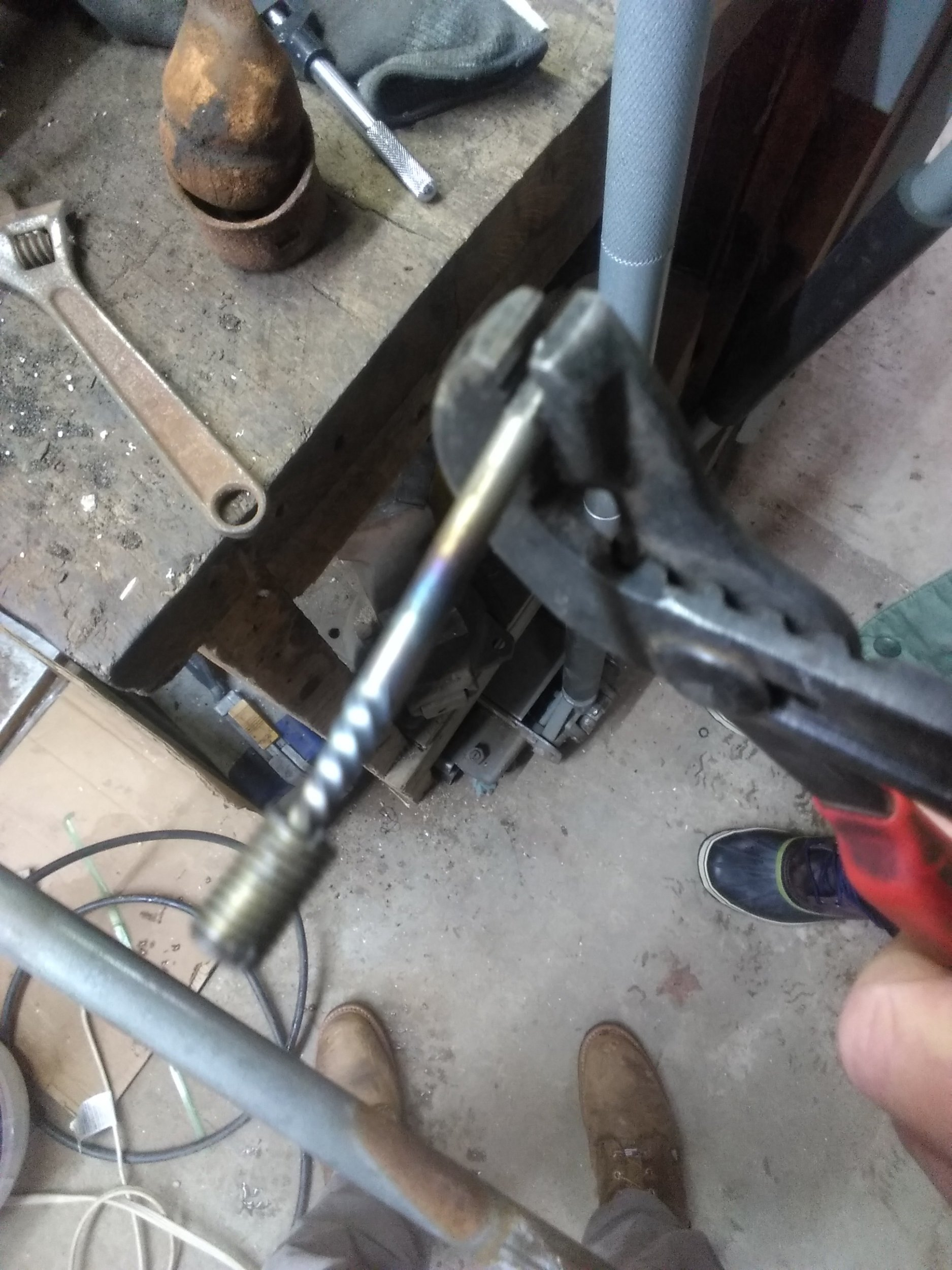

I think we're going to try to drill that one out. :oops:

Try this
Item #70 in the B01301 CONTROL LEVER breakdown.
JOINT, ROD END- replaces #75532-62260 JOINT,ROD END7K530-71180
75532-62260
$13.8310 in stock
Yep. Ordered two of them.
I looked for 20m for the parts breakdown, made this post, and the very next thing I learned was it was the FEL parts list, not the tractor. Found it shortly after.
Also order a proper bolt extractor set.
Just sucks because I have always used the welder to get a broken bolt out. But with the bolt recessed so far in like that, it won't work. I really hope I don't end up up having to buy another lever. I also have no real way to plow the driveway now either.
   / L3710 Lever and linkage part numbers?
well that's a relief. just have to wait for the other parts to come in. should be a quick fix from here.
