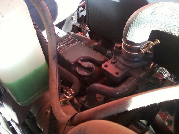

Where is that oil fill point on the valve cover for a L3800? I looked today but didn't see it.
Thanks.
   / L3800 50 hour service #24
Thanks.
Its on the side, just up from the dipstick. Hey there are a lot of good thread on here about methods to change the hydraulic and hydro filters without loosing too much fluid.. I used the vacuum cleaner method but it put fluid spray into the vacuum. Another method is the park on a steep hill sideways with intended filter up hill. I havent tried this. Other method is just be darn quick.. Good luck and get back to us if you need anything..
Thanks.
On my 07 L2800 it is right behind the radiator hose outlet on the front right side of the valve cover. It is recessed a little.
   / L3800 50 hour service #27
On my 07 L2800 it is right behind the radiator hose outlet on the front right side of the valve cover. It is recessed it little.
I wish mine was there, it's a PIA having it on the side of the engine where it's harder to get at with a full jug of oil.
Sean
   / L3800 50 hour service #28
Mine also has the side fill along with the valve cover fill. I did not find the valve cover fill until just before the 300 hour service so I know what it is like to add oil especially with the loader attached. I was a nice surprise when I found the valve cover fill. I have not looked at the other L-series to see if they have the valve cover fill.
   / L3800 50 hour service #29
