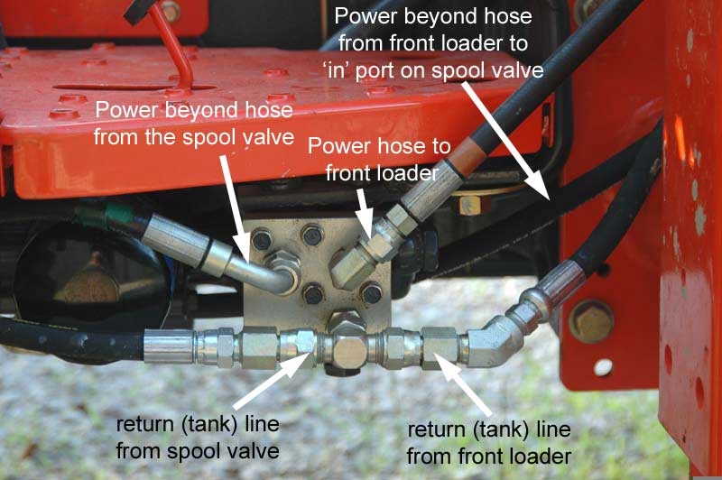

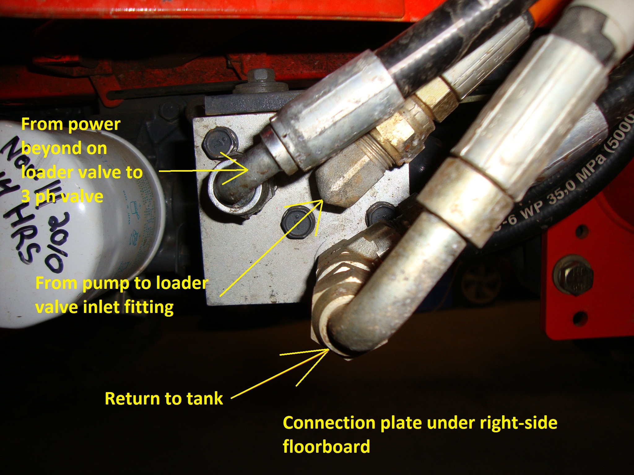

Mtn View -- what you show in these pics are 3 remotes with controls, right? Would that group of valves be fed from a power beyond port somewhere? ...and then a return hose back to the sump?
Yes, the power beyond port at the loader valve feeds the rear remote valves. The power beyond port of the rear remotes goes down and connects at the hydraulic block where the loader power beyond previously was connected.
The return to tank lines are teed together at the hydraulic block under the right side floorboard.
