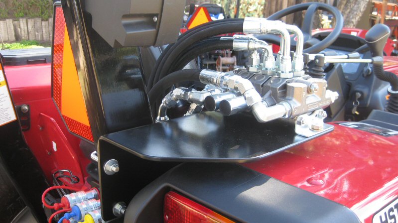

Off the ROPS above the fender. Until the last few years, even Kubota mounted the valves there on the std L models.
Something similar to the picture.

That's the valve I used -- well, almost. I got the 4 spool for $35 more. Even if you don't need all 4 now, it's pretty easy just to cap them for future.

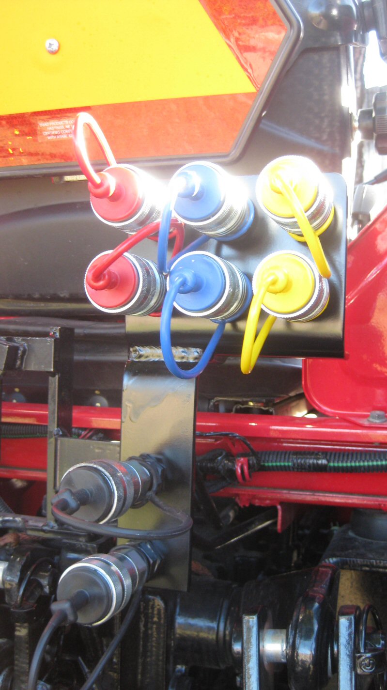

My 3 spool setup with float came from FitRite. I'd recommend him. I designed my system with his help. My only regret is where I put the quick disconnects. They crowd the 3pt to much.

I'm really happy with how I have the spools mounted & the joystick for TnT. Less so with the QDs. Part or the problem I'm sure is the fact I use a Quick Hitch, which crowds things back there even more. My first set of hoses for the TnT weren't the right length & got chewed up (toplink hose at one point snagged on the QH top bracket & was holding my box blade from dropping. The new hoses are a lot better, but have a few scrapes on them. This was my first hydraulic project ever & a very good learning experience (I.e. a bit expensive, I broke a few thing & ordered a few of the wrong things, etc). I'd do it differently a bit knowing what I know now, but would still do it all over again in a heartbeat. I'm happy with the support & advice I got from Brian @ FitRite, even though he wasn't enough of a psychic to know some of the hose lengths I ordered weren't quite right. :p
As far as where to move the QDs to? I'd say mount them a bit higher & possibly on the outside of the ROPS instead of inside. Would look uglier, but wouldn't jam stuff in back there as tight. The QH crowds things a bit & you are already fighting 6 axises for a whole lot of movement all over the place on a smaller tractor. Putting the QDs a little further away would put them farther from the QH & let you route things a little better.
   / L3800 HST Rear Remote Hydraulics #20
The factory kit puts the quick disconnects outside the ROPS, just above the right tail light. I contemplated putting the bracket to the inside, but honestly, there's just not enough space on this fairly narrow tractor. With placement to the outside, I use about a 60" hose length, with a loop, to run to the top link and side link. With that loop, the hose can coil itself when the 3-pt is raised, and stay tucked in. Without a loop, any hose that would be long enough to handle the lowest position would end up bunched up and sticking out the back 12-16" when raised to the highest position.
Here's a photo of the hose and loop before I put a hose cover over the pair.
I should note that I tried a whole bunch of configurations and hose lengths before I settled on this arrangement. Sometimes I look at it and wonder if it could be improved, but I remember all the trial and error and realize this is probably as good as I can get it.
