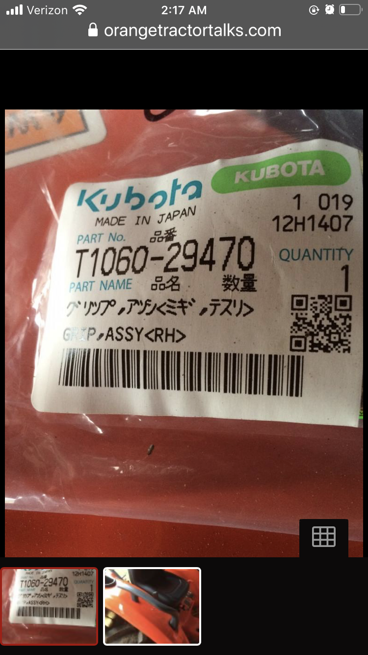

From Messicks. Didn’t show a grip for a 3800. Had them on a 3830 I once had. Fenders looked similar.
70.1
ASSY, GRIP RH (see notes)
- replaces #T1060-29450
T1060-29470 $49.97. 19 in stock
If you log in on their parts site you can see parts and pictures.

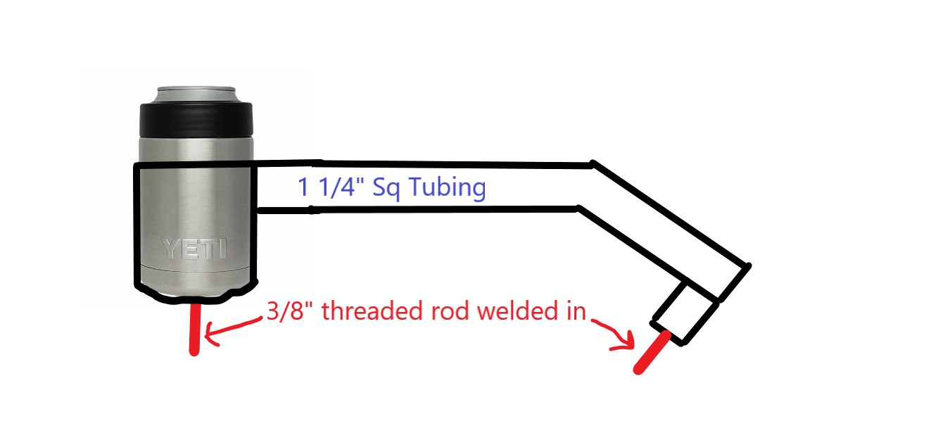

I made my own and had the back end of it be a cup holder.

Mine went on a Kubota L3010GST. I can't get pics right now, but I used the left handle as a pattern for length and angles. Used 1 1/4" square tubing and a bit of round tubing big enough to hold a Yeti can cooler. Welded 3/8" bolts to go through the attachment holes in the fender. Here is an artist's concept.
