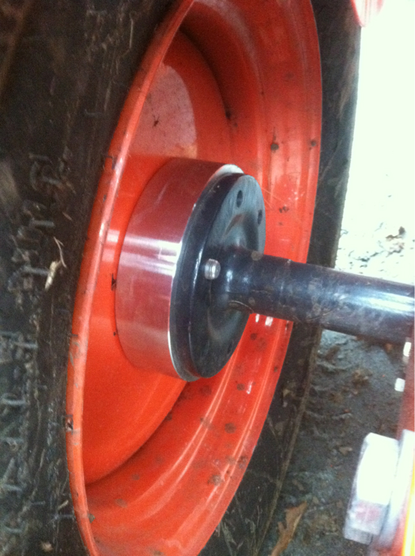

   / L3800 wider stance w/ rear tires, how easy to do? #19
Here are my 2" Bro-Tek rear spacers installed.
#20
Followup...Plenty of clearance w/ chains on and stabilty on side slopes greatly improved. Highly recomment adding spacers, really a necessity if you plan on using chains in the winter.
