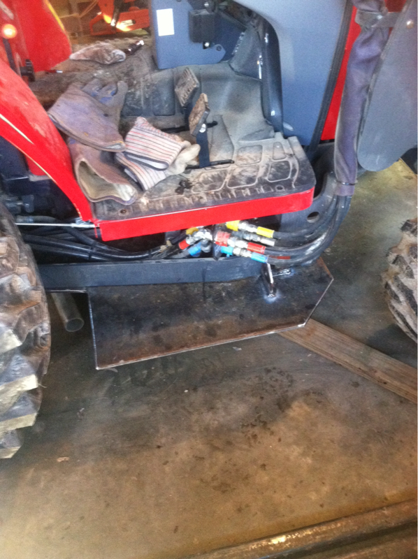

I have been doing some brush hog work at a local park. Mowing some brush and some I root out with my loader. I apparently hit my fuel bowl with a stick as it was leaking, I turned it a ways and it kind of skipped, still leaked, then I turned it a little more after the skip, it stopped leaking. I had sticks pole up through by the foot plates and other areas to. Does anyone make a skid plate that would cover a good part of the belly of the tractor that could be added to protect parts like the fuel bowl, hydraulic lines, etc? I will have to take a look under the tractor and see what could be done to protect it. The lines from my 3rd function valve seems to hange down a bit, open to getting hooked and damaged. I will use some plastic zip ties to help hold them in place better but a shield would work better.

Rob, I don't know of anything you could buy off the shelf. I think you will either have to design and build them yourself, or take is to some welding fab shop and have them make something up. The trouble with that approach is that it is likely to cost you some serious coin. It would not cost all that much to make something yourself, but you need to be able to measure accurately, and design and fab up the guards. I don't doubt that some members here have fabbed up some of their own guards. Some guys here are pretty "handy".

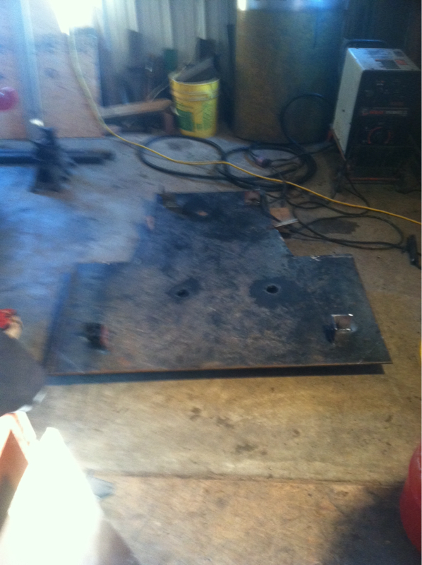

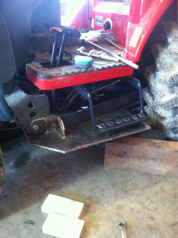

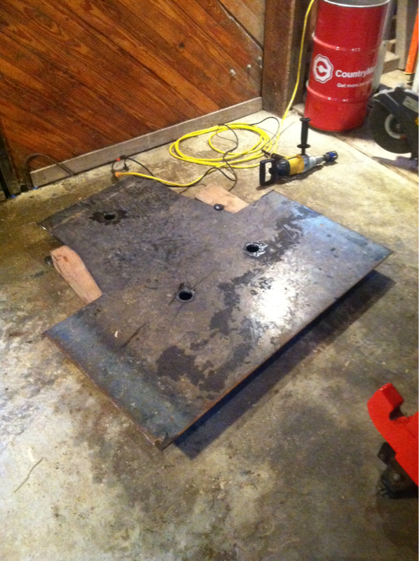

Built this skid plate for my dads 1529 massey.
