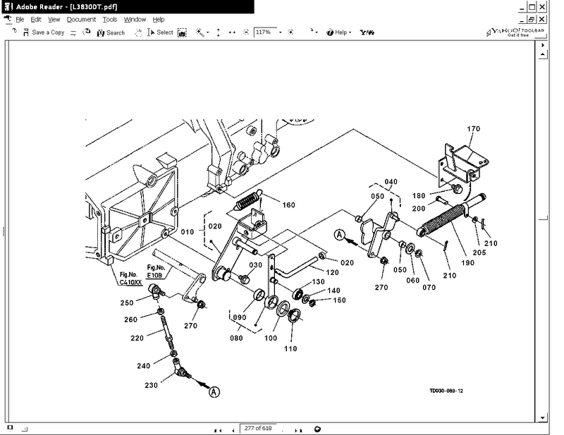

I also own a L3830. I have not had any surging problems on bumpy ground. Here is a blow up I found of the previously mentioned assembly
   / L3830 HST Feather Step Pedal #12
The parts being alluded to are #160 and #190 in the information posted by "goneandbrokeit."
The part number for #160 is 76611-43320 and the number for #190 is, 32721-43350. Kubota calls number 160 a spring and number 190 damper hst. They are located where "Dargo" advised.
It would be interesting to ask the "Service Manager" what role/function these two part numbers play.
   / L3830 HST Feather Step Pedal #13
Yeah, and ask him why he thinks they're "internal"!

Sorry to hear about your troubles. I looked in the WSM and it does not show this symptom in its trouble shooting tree. I do have some educated guesses that may be just as bad as the dealers, but ....
If it is fluid related, what could it be:
is the fluid up to the correct level?
is the filter clogged up?
is the screen clogged up?
is the relief valve popping at a very low pressure? Both charge pump and high pressure pump reliefs.
If it is not hydraulic (and I don't think it is as cruise works) then it must be mechanical.
Question, when you press the peddle with your hand, is it real easy to move or is there some fairly significant back pressure? (Engine off for this one!!) There should be some significant pressure, and it shouldn't work fast.
When you bottom the peddle, how long does it take to rebound to the neutral position? It may be interesting to time your tractors peddle vs ones on the lot.
I would inspect all of the linkages for looseness especially the neutral holder arm and the dampner.
Then drive a similar model on the dealer lot bring some bricks or 4"x4" posts to run over to simulate rough terrain. If they are ok, ask the service tech to swap the dampner and springs to your tractor.
I know there were some other pictures of the linkages posted, but here is the one from the WSM for the "10" series. It should be the same as the "30" series.

So far, it matches up exactly with what I had; dealer telling me that it was "internal" when I saw it was external. Also, when I pointed that out to my dealer, they missed on their first try. They used a wrong size dampener (they have several sizes - don't let them tell you they don't) and they have several different strength springs (don't let them tell you they don't). It did take a couple tries to get the right combination, but that fixed it. Actually, my dealer gave me 3 dampeners and a sack of springs and said "you know more about it than us, could you please see if you can fix it? :eek:
So, that is how mine actually got fixed. If you look at it's design, and with cruise working, you can see where what I'm describing will be the only way it can be fixed. I don't have time to train your dealer, but you did teach him that it was "external", didn't you? Try the others if you don't mind. It doesn't take 2 minutes to change the springs and dampener to check different settings. Good luck!!
   / L3830 HST Feather Step Pedal #20
I have a B1550, so this may be completely irrelevant. My tractor took an unusually long time to come to a stop after removing my foot from the speed control pedal. Upon the service tech's advise, I removed the pedal and polished the bushings. No change. I ordered an new return spring and installed it today. During the process I noticed that there was a spring tension adjustment bolt. I installed the new spring, but the problem turned out to be that the tension was adjusted too loose.
Based on the photo of the parts drawing posted by John Bud, yours has an ajusting bolt too. If the spring is #8, the right end of it ataches to this bolt. Moving the nuts on the oposite end adjust the tension.
Tha dampener is designed to prevent exactly what you are discribing. I would suggest that you also check the parts manual against the part number he gave you.
