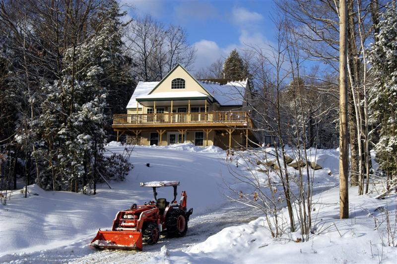

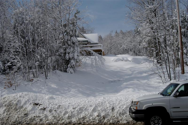

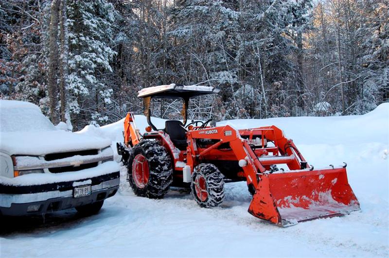

I feel your pain, I have the driveway from he** and a mountain behind me with almost constant running water which freezes constantly on the driveway. I could not clean my snow without my chains. I bought double ring self cleaning for the back and square ring chains for the front. The double ring chains work great in the snow and are also very good in Maine's "mud season". The square rings grab well and don't tear up the driveway as much as v links.
My suggestion, Bite the bullet and get the chains You won't be sorry.
I 'm posting some pics the one of the plowed driveway shows the driveway from about halfway up looking down, notice the ice after the snow has been cleared.
Another shows the driveway before clearing, it starts straight turns right behind the utility pole the up about 150' then turns a sharp left to go behind the house. Always an adventure.
The last is my baby at work. smaller than yours but close, a 37hp Grand L.

As they say... When you're going through he**, keep going! Beautiful property and setting however.
/ L39 Tire Chains Question
Thanks Casco for the suggestions. A lot of water moves down toward me from mountains above as well. I may start with front chains, but will also try to budget for rears in the near future.
Gorgeous place you have there, and a nice machine to care for it too!
