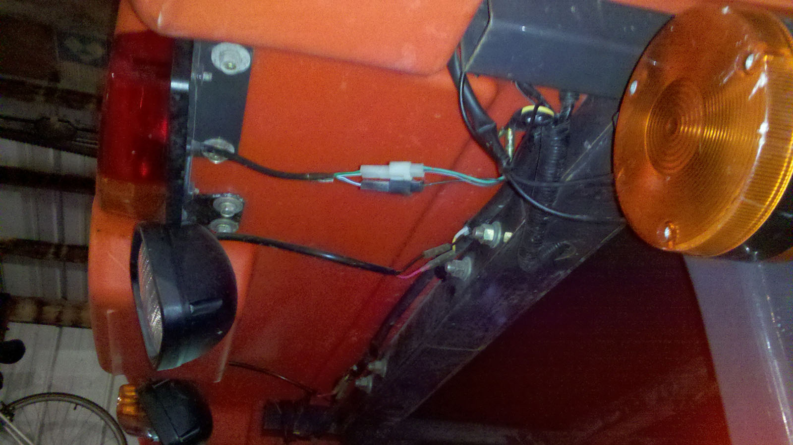

My wonderful son gave me a pair of lights to use as work lights. Near my flashing lights under the rear of my canopy there are pre-wired male and female connectors. I assumed that these would be wired to my main light switch but they must not be (no power). Where do these wires go too? How are the factory work lights wired? Thanks in advance!
/ L39 Work Lights question #2
My L39 has four set of work light connectors at the back of the canopy. I have two factory work lights connect using two of the four sets. The black wire is ground and the yellow with red strip is positive. There is a separate work light switch next to the key. If you do not have factory work lights, you may not have the switch and relay installed. You could probably buy the switch and relay if it is not there. I expect the connectors are there for them.
