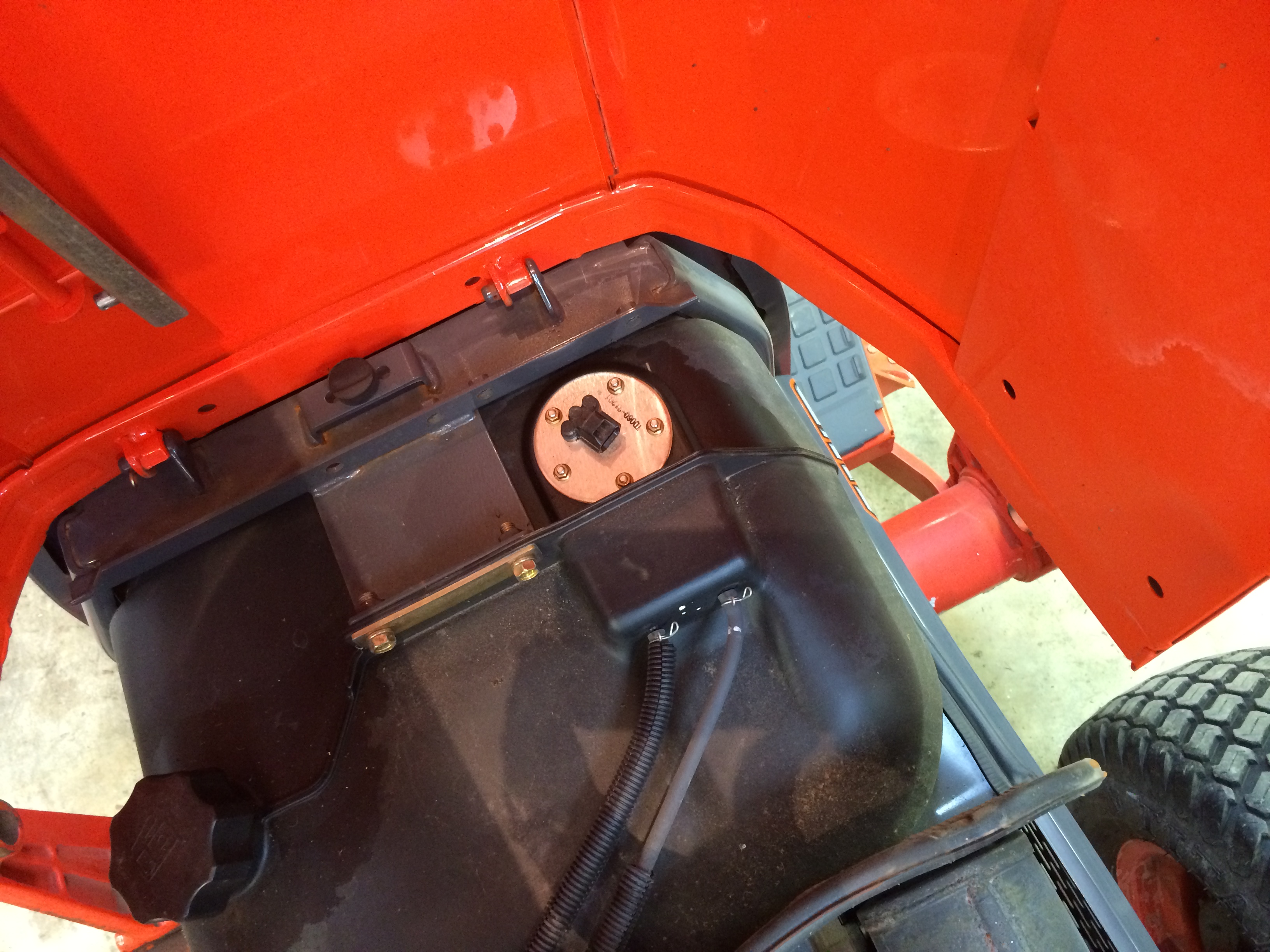

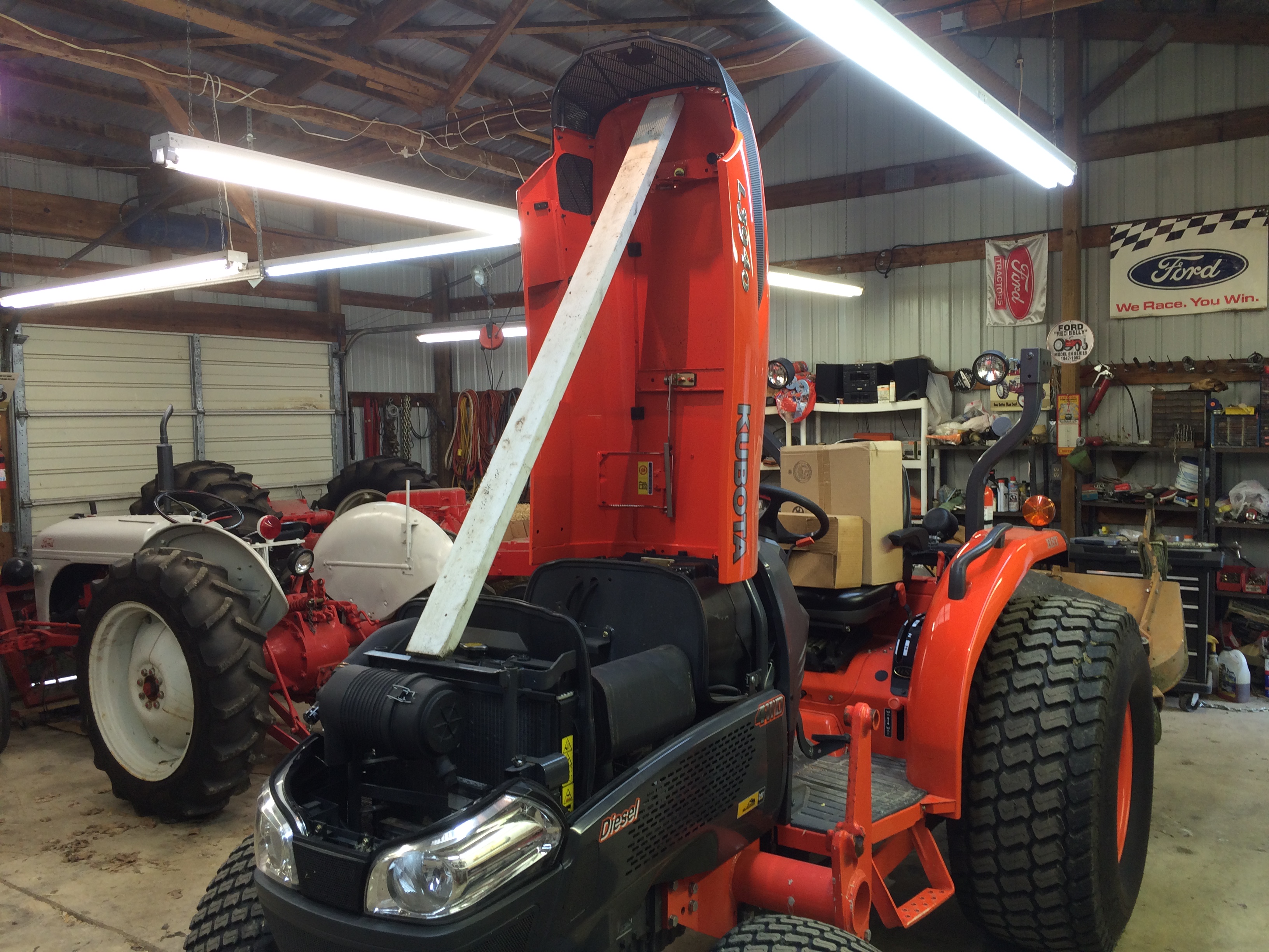

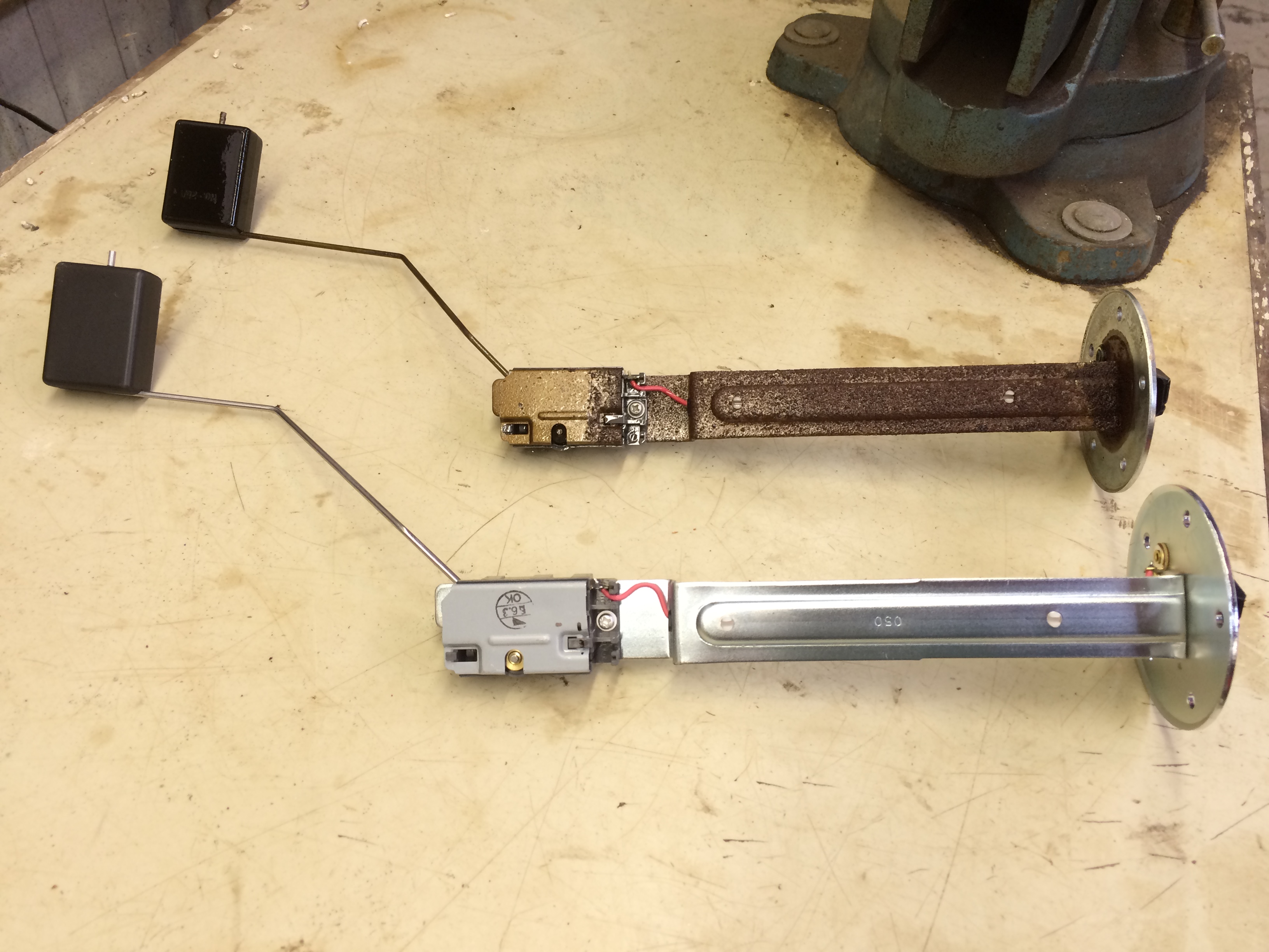

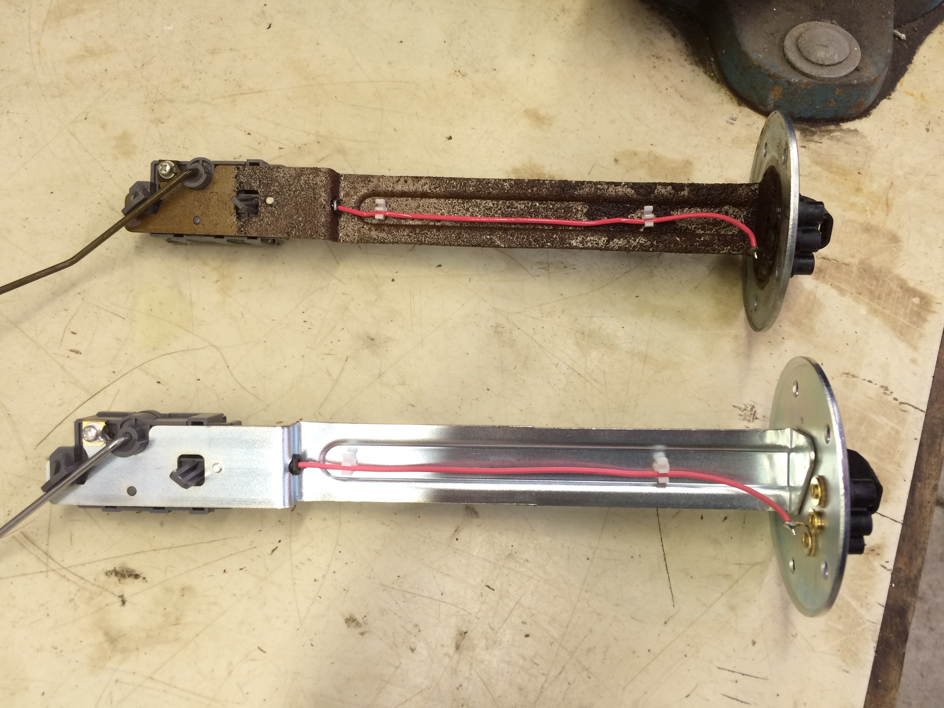

My 2009 L3940 with 250 hours was beginning to have odd fuel level readings, reading fuel level that was less than actual tank level. Bar graph would go up and down between 1/4 and 1/2, or fuel light would come on at any given time. Even with tank completely full, I would never get a reading above 1/2. Okay, ready to replace fuel sender. The old fuel sender part number was TD060-31201. The new fuel sender part number is TD060-31202, price was $90 from Messicks. The hardest part of the job was trying to figure out how I was going to remove fuel sender as it sits at the very back of the firewall/bulkhead. My initial thought was to call my brother and remove hood. Fortunately, you can remove hood closure rod and prop assembly, and hold hood open with a 62 inch long 2x4 that will allow access to the fuel sender. Once old fuel sender was removed, I can see that rust has taken its toll. Most likely from me hardly ever keeping tank full, as I like to run out in the fall ready to add winter #1 fuel, and as I like to run out in the spring ready to add summer #2 fuel, white bottle Power Service year around. New fuel sender along with a new fuel filter was installed, as well as performing 250 hour service. Just wanted to share in case anyone else ever has this problem, the 2x4 hood prop is the way to go. Philip.

I know hey are the same, but I swear the new one looks bigger than the old one in the photo.

I'm going to save that OP writeup in case I ever have to do that job. But the corrosion bothers me. Is that much water that common in fuel? I thought fuel was oily enough to prevent rust.
