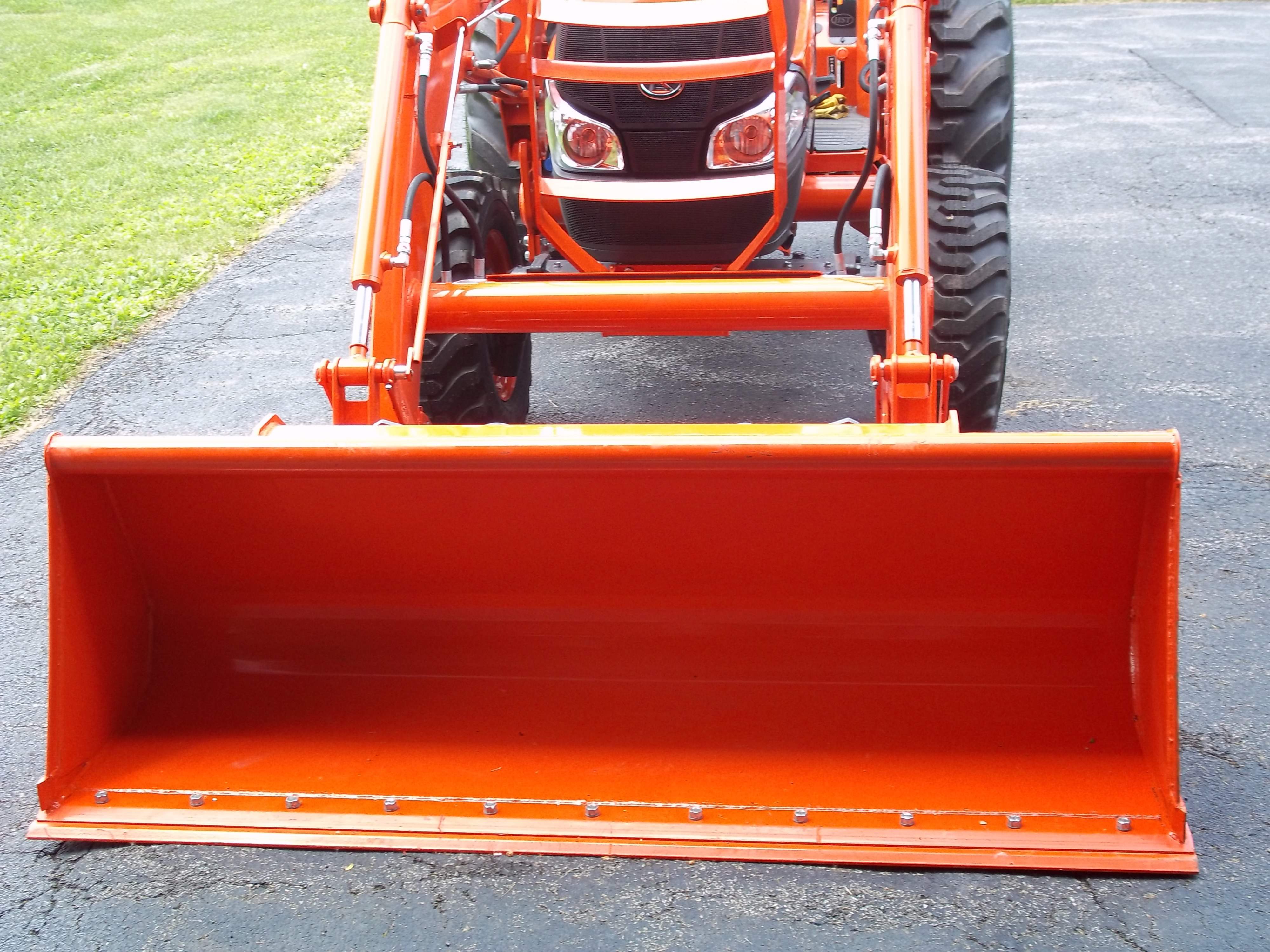

+1 on getting the heavy duty bucket. Wish I would have on my jd 3320. Also bucket hooks are much more usefull than i imagined.
   / L4240 - Recommended Options? #13

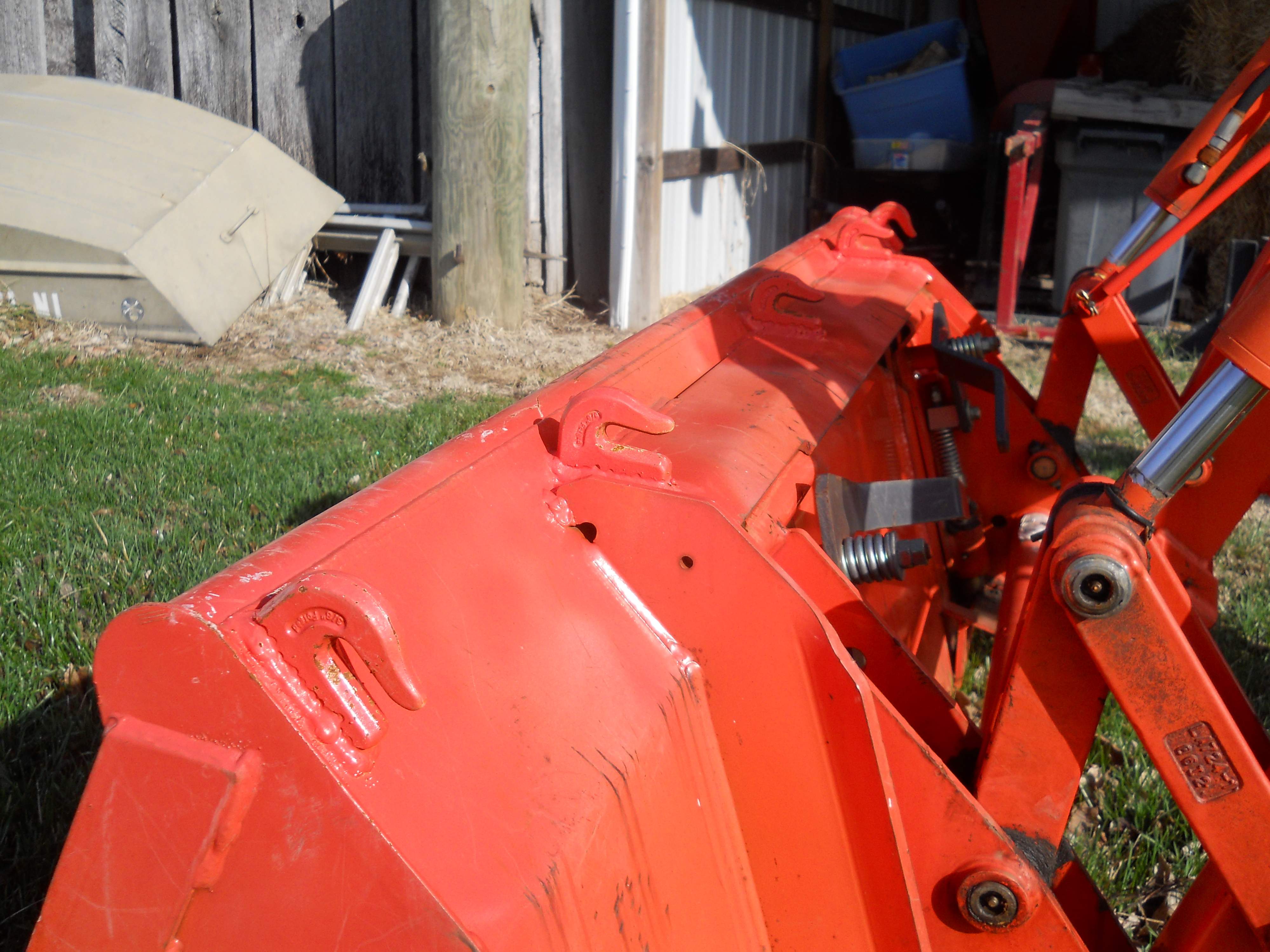

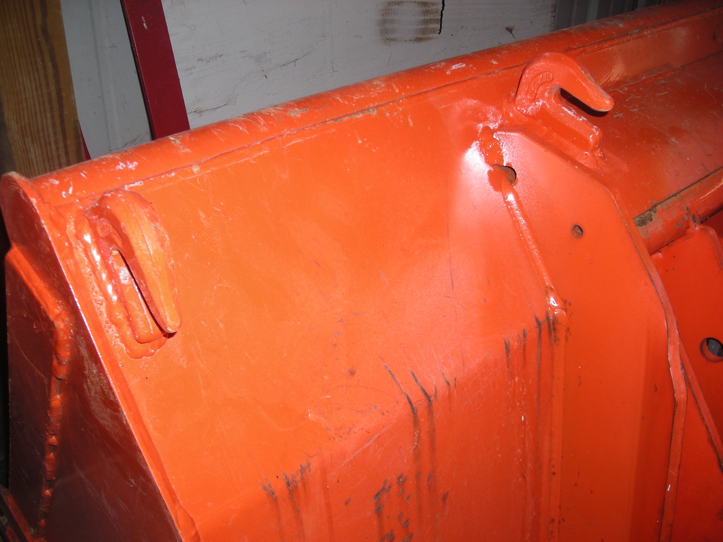

I have the HD round back bucket(with SSQD) on my L4400 and it is a strong bucket. That said I was helping my buddy weld some hooks onto his and it is a very sturdy bucket as well. I would think you would be well served with either.
   / L4240 - Recommended Options? #14
The round back heavy duty bucket is if my memory correct about 200 lbs. heaver the the standard bucket, beefier steel all around, and HD bolt on cutting edge

One of the things that makes the HD round back bucket so strong is the pipe going across the top. I did not reinforce my hooks when I welded them on because of that. With a standard bucket, you may want to add pads to help spread out the load under the hooks. Philip.
