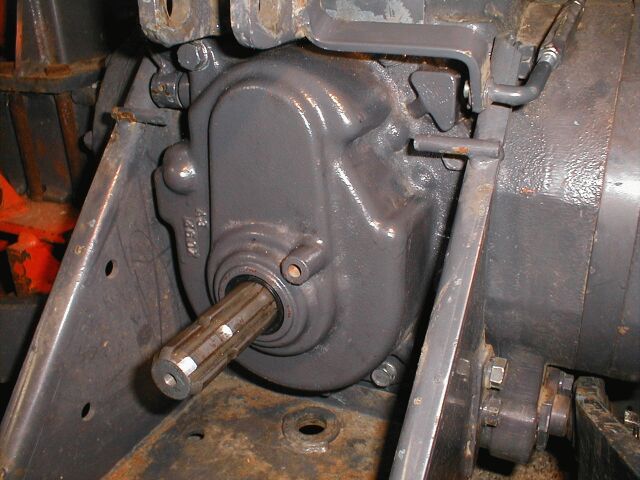

Hello, I'm new to this forum as well as being a new Kubota owner. I just purchased an 1993 L4350dt with 1900 hours on it and was hoping yall could give me some general information about the tractor. The things I know I have to fix are a leaking seal around pto cover and a leaking seal on right front wheel (lower part of four wheel drive nuckle). I'm also going to change all the fluids just so I'll know when it was done. Any tips would be great as I don't have a service manual yet.

Hi Ken - the L4350 is one of the models based on the Kubota L3 chassis. I have been posting here for years about these tractors - IMHO they are among the most rugged, long-serving, reliable, and trouble free machines Kubota has offered. The L3's are known for being extremely rugged - some say overbuilt. Models numbers were L3750, L4150, L4350, L4850 and L5450. At 1900 hours your L4350 should have a lot of life left. There's an owner's manual on eBay right now for $27 delivered - maybe a good place to start. Also, I've found that a parts manual useful to see how it all fits together. That one is $45. Both of these show up for less sometimes. I have the full workshop manual for the L4350 - maybe I can send you a .pdf to help with the axle seal job. The picture below is of the pto on my L5450 - is yours leaking around the shaft? or the housing?
Welcome to the LXX50 owner's group ! Take care, Dick B

Dick, I hope your right about a lot of life left being in my tractor. I sure am happy with it so far. I definitely would like any pdf files you think are applicable. I degreased the rear end of the tractor today so I could tell more about where the leak is coming from. Its not coming from around the shaft so its probably the housing. Is there anywhere to order parts online or do I have to go to a dealership?

Ken - There are some pictures of the pto gearbox in this thread that should give you an idea of what's there. The factory gasket and adhesive is very tough to remove completely. If the box comes loose easily after the bolts are out, that would indicate it's been off before - maybe the only problem is re-sealing the gearbox. Permatex silicone works fine if surfaces are clean.
On your front axle leak, there are seals and a cap at the bottom of the kingpin housing (need to take the wheel off to really inspect it). I'll try to scan some pages from my parts book and repair manual tomorrow.

Drilled some holes today with the phd and figured out my rear leak. The fluid is coming out around the small shaft that goes into the top of the pto housing. This is the shaft at the top that rotates to engage the pto. Another thing I noticed is my pto works in high and low speed and stops completely in the center postion like its supposed to but, it won't stop spinning when I press the clutch pedal. If the tractor is idling it grinds going into either speed. Now you can disengage it easy enough but going the other way is rough. How is it supposed to work? By the way I decided to to off my trans fluid, it was 3 gallons low. My front axle was 1.5 quarts low.
