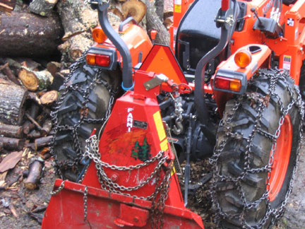

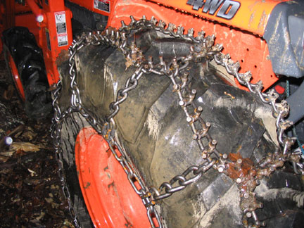

I bought Norwegian boron steel spike chains for the rears of my L4400 and traction is no longer a problem. We get snow 2 or 3 times a winter like in your pic ourselves plus I log with my winch so I want traction.
