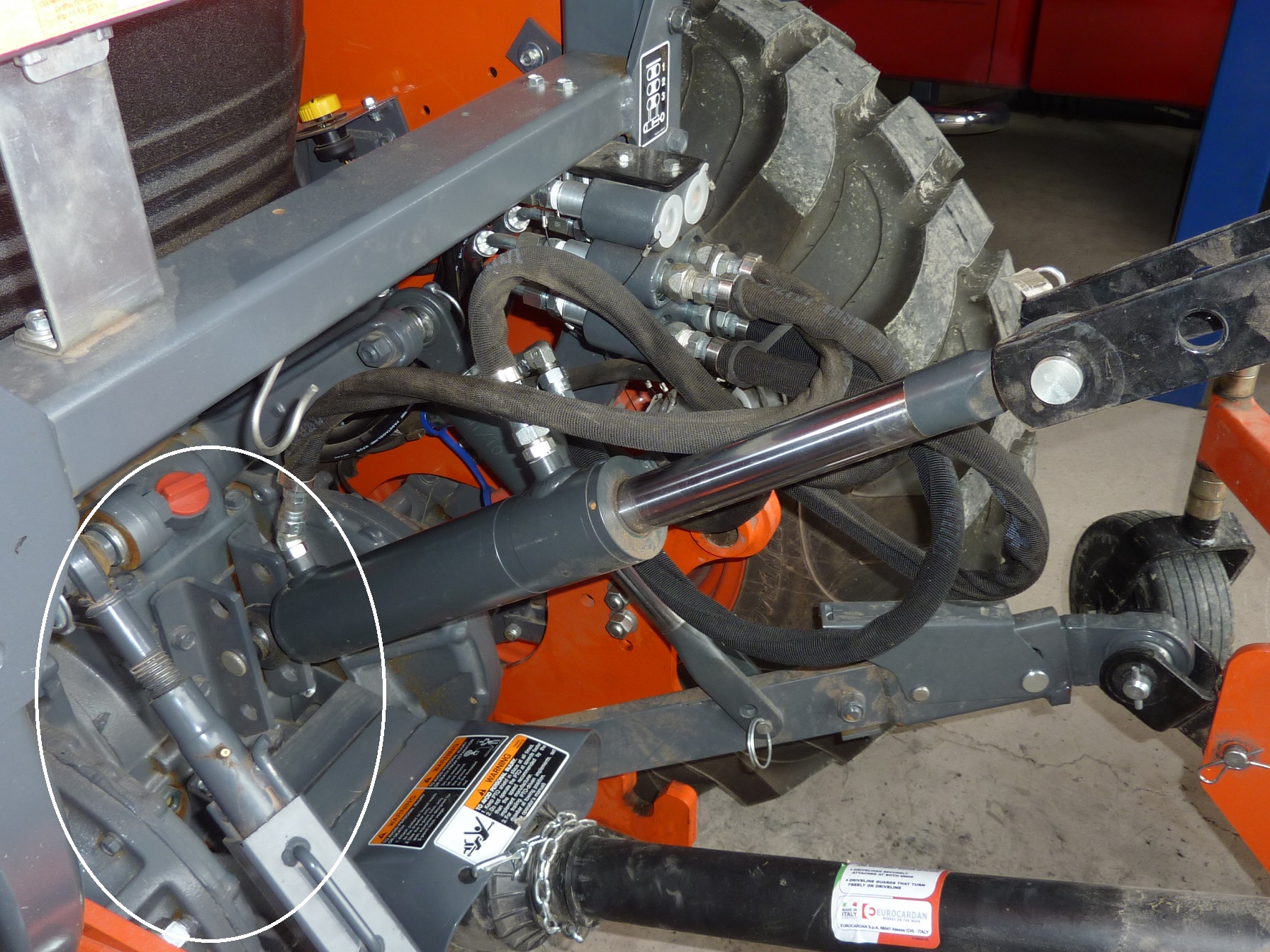

Ive seen them on some deeres and longs ... The right side adjustable arm has a crank on it, instead of the type with a jamb nut. Makes it much easier to level implements or angle them when not tools are required. Anyone know if they are available for a L series? I looked all the thru kubota site but couldnt find anything.

The Grand L's used to have a crank adjustment, as my L3410 did. My L4060 does not have one, and I really liked it also. I priced out the parts on Messick's www site last year (for older L3410) and it came in around $600 so I abandoned my quest. Given the outrageous number it's possible I made a mistake looking it up though.

The crank adjustable link arm on my old L3430 worked fine if there wasn't too much load on it. Not sure of the price or if it would fit the L4600 since it has a 15 degree offset pin angle with a straight clevis.
The MX series uses a better style IMO. Its a variation of the nut / rod design with a boxed handle that locks in place. No tools required. I bought a second one so I could use one on each side when I'm not using the T&T kit. I paid around $200 for it. Again, I'm not sure if it would fit a L4600. There is no offset to the pin, its 90 degrees to the rod but there is a 15 degree offset to the clevis. The length / adjustment range could also be an issue.
As jeff9366 suggested, the money is better spent on a T&T kit especially if you already have rear remotes.

Dont have rear remotes but would like a set of 2 for a hydraulic shank box blade and a 2 cylinder grader blade. Thats been my only regret is I wish i had got them on it when I bought it.
Really cant justify the cost for a T&T kit as I dont do much that I would need it for. 80% of what i do is bush hog work. Box blade ive always used level.... grader blade always been fine with manual angle, offset and tilt.
I could see throwin $100 or so at one of the crank handle arms but for the price of 2 remotes and the T&T kit i dont think would be money wisely spent for my needs.

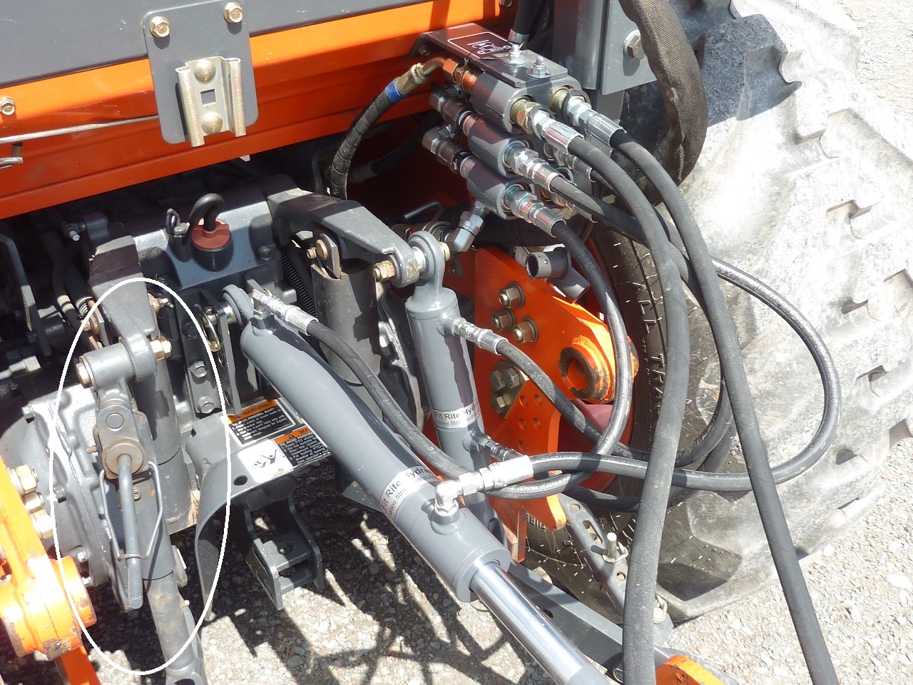

FWIW, Kioti uses a double clevis end crank handle lift arm link with fine threads. I too have T-N-T, and took the crank handle unit and placed it on the left side 3PH arm; (it came on the right side from the factory), but I use the right side now with the hydraulic tilt cylinder.
Keep in mind it has two clevis type ends one at top, one at bottom, no ball/socket type ends, no offsets etc. Again length and total distance of adjustment could be an issue depending on specific setup.

I have one on my 1952 Ford 8N, which works, and one on my Kubota L3710, which doesn't work. Don't know of it's stripped gears or a broken shear pin. The adjustable links are not engineered to be adjusted under load. If they were, they'd use Acme (flat faced) thread, not regular bolt thread.
