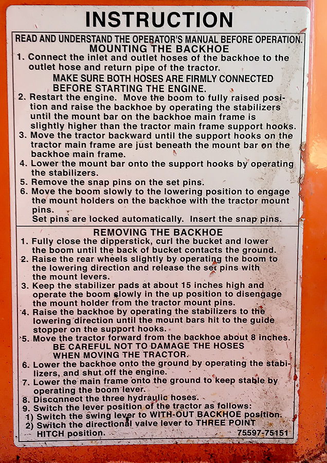

Boux your directions are right there on the side of the backhoe. I wish I would have had them on mine. Did you get it off ok?

/ L48 Backhoe removal procedure
Duhhh...
Boy do I feel dumb :laughing:
Thanks tungularfishcamp, I'll see if I can get a better picture and post it for others to use.
Unbelievable :confused2: :ashamed:

Well, I did it. It came off easy enough. Put the Squealer on and cleared all the under growth away. Reinstalling was a little troublesome but that was due to somebody parking a trailer next to the hoe at an awkward angle making it difficult to line everything up. I'm glad those instructions were handy
/ L48 Backhoe removal procedure #15
I know this thread is old but it's still a great resource. Here's the instruction label from my backhoe.
