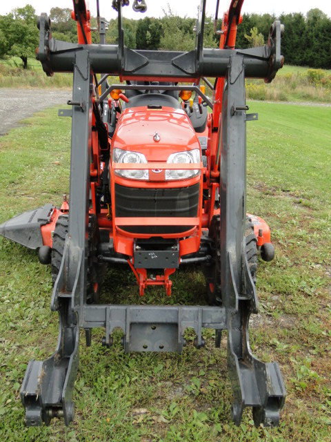

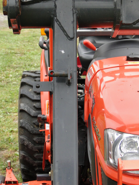

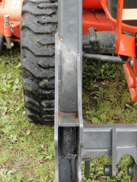

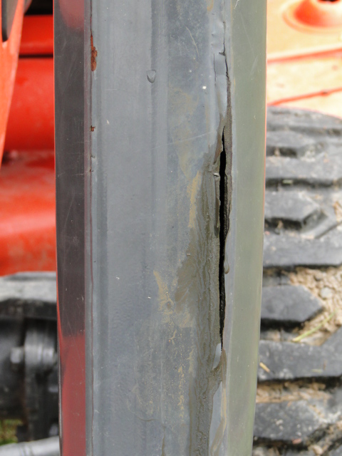

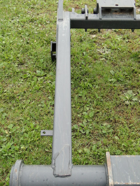

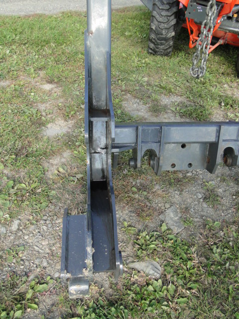

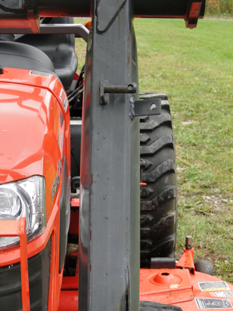

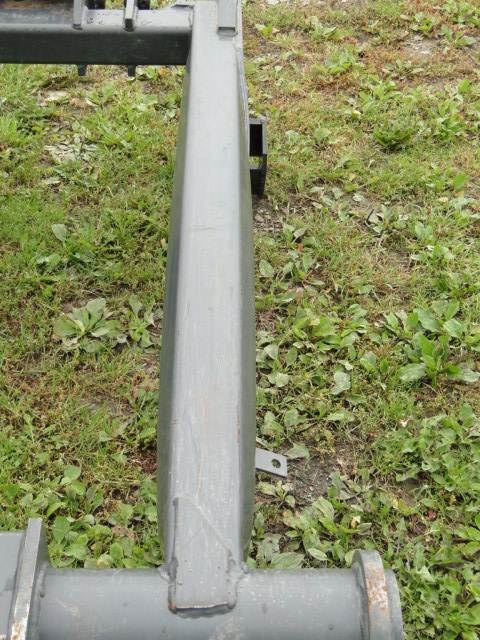

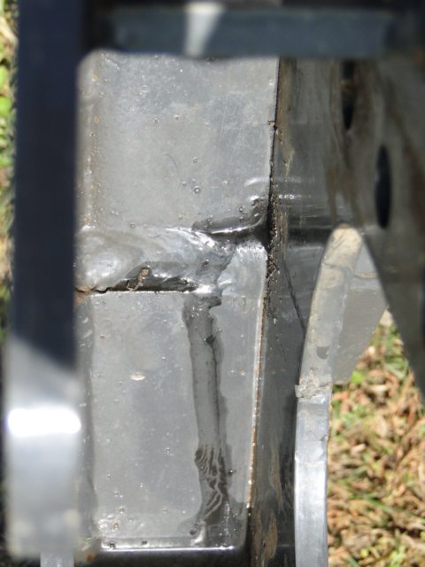

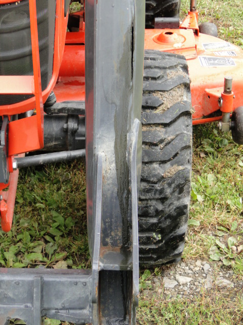

Well, I had the frame upside down so it would drain out of the crack. Picked it up with my B loader and what-do-u-know, the good side has water in it because I can see where it is coming out. I now have a battle again with Kubota, more ammunition. The frame also had oil in it, came out of both sides. I hope this is a bad weld so I can go after them again. DSC02772.JPGDSC02775.JPGDSC02779.JPG
   / L48 sub frame broke #42
The last picture, on the opposite side of the arrow you posted,
you can see where the frame has come apart, it's not level or straight aligned.
It's started to rust and come apart at the weld,
Definitely a defective weld. Kubota should take responsibility on this one.
   / L48 sub frame broke #43
......the good side has water in it because I can see where it is coming out.......
There's the proof - poor fit-up and welding. I would think Kubota would take an interest in this defect. For something like that not to be caught at the factory is a potential threat to their reputation. Overall, they are a high-quality manufacturer and if the right eyes see this they will make it right. Meanwhile the take-away is that drain holes are cheap insurance.

Drain holes let water out, but also allow moisture in the form of water vapor in, and with variations in temperature, "breathing" occurs. In practice, assuming the drain hole is properly located, studies show that only a minimal amount of internal corrosion will occur. But also that with a properly welded, sealed structure, no detectable amount of internal corrosion occurs. For corrosion to occur, besides the reactive metal, there needs to be water or water vapor and oxygen - - in a sealed structure, once either have been used up in the oxidation process, no further corrosion occurs.
There's may be several things going on here, and all look to be Kubota's fault, poor material quality or welding, and/or stress corrosion cracking.
I wouldn't be drilling additional drain holes on my Kubota. If properly designed and built without them, they should not be needed. If one does add them, I'd think there would would be no recourse with the manufacturer and little likelihood of them stepping in to cover the modified product.

Hello rbargeron, the tractor has never been driven in water deep enough to even touch the frame. To answer your questions rbargeron, I'll take some pics of the frame tomorrow, it's sitting in the yard and you'll be able to see all the answers to your questions. The frame was fine late fall when I pressure washed it and got it ready for winter. The spring is when I noticed the damage. (No way the pressure washer filled it either, I can't find a crack anywhere. The existing crack I believe rusted after it burst open. Take a look at the pics tomorrow night, Really stands out off the tractor.
