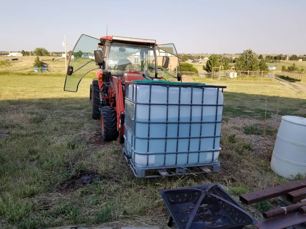

The medium loader will barely lift 1,900lbs (IBC tote 3/4 full of water). I'm guessing this has the big loader. IBC totes of wood are noticeably lighter than water, so that's a non-issue. It will lift a heaped bucket of gravel as well.
