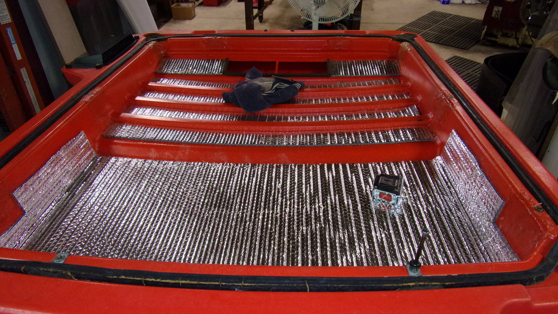

I guess the newer Kubota's, they put the 'works' under the seat (of all places) so it's even harder to access. You have to take the seat out before you can access anything.
Little hint.. When you take the roof off, flip it over upside down on sawhorses and get yourself a roll of foil-bubble-foil 'Reflectix'. They have it at Lowes and line the inside of the roof with it. I cut mine to fit (cuts easily with scissors) and glued it in place with 3M trim adhesive. That really cuts down on the heat under the lid and lets the ac work much better as it gets hot under there.
The other thing you want to do is take all the screws out of the upper blower assembly (but it won't come off but you can (as I said) prop it up enough with a block of wood, to get to the evaporator and clean it. it will take a couple cleanings and the dirty crud will run out the drain hoses under the tractor. When it runs clean, the evaporator is clean.
Do mine every spring and I replace the cabin air filter too. No matter how hot it is, mine will literally freeze you out.

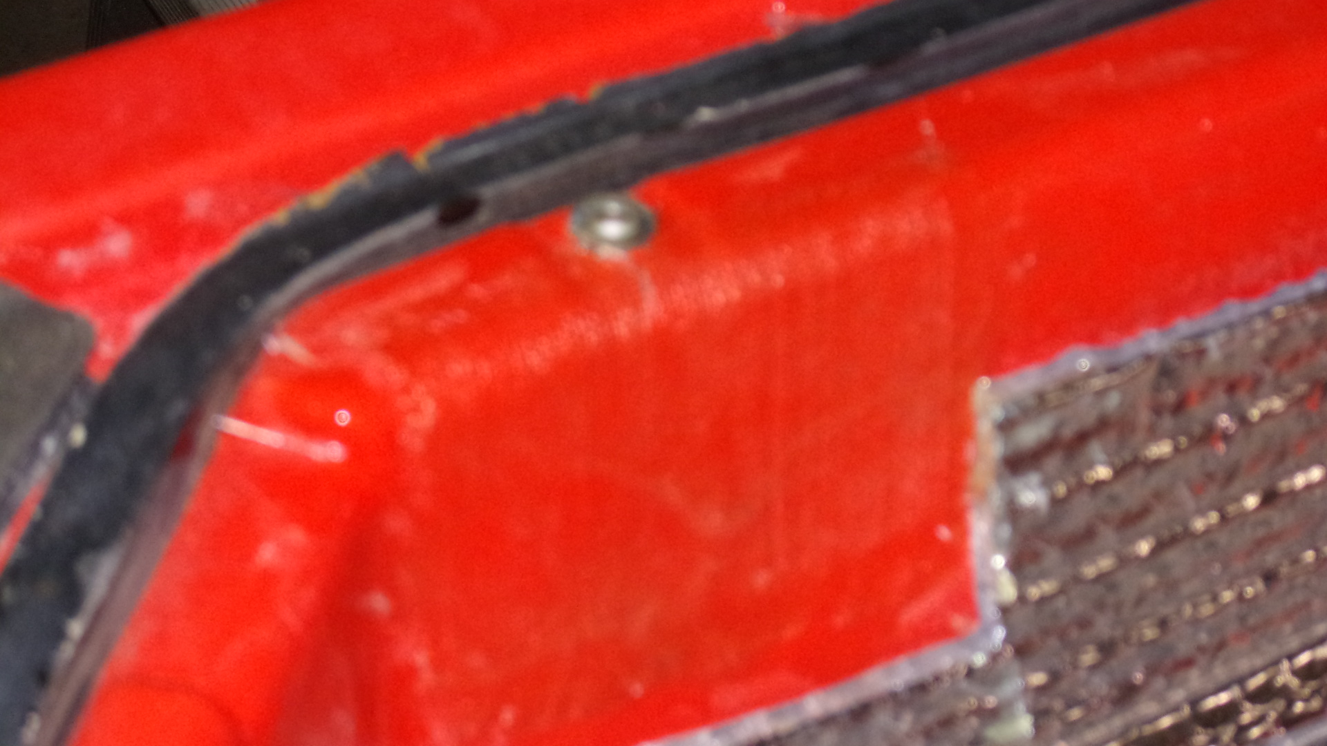

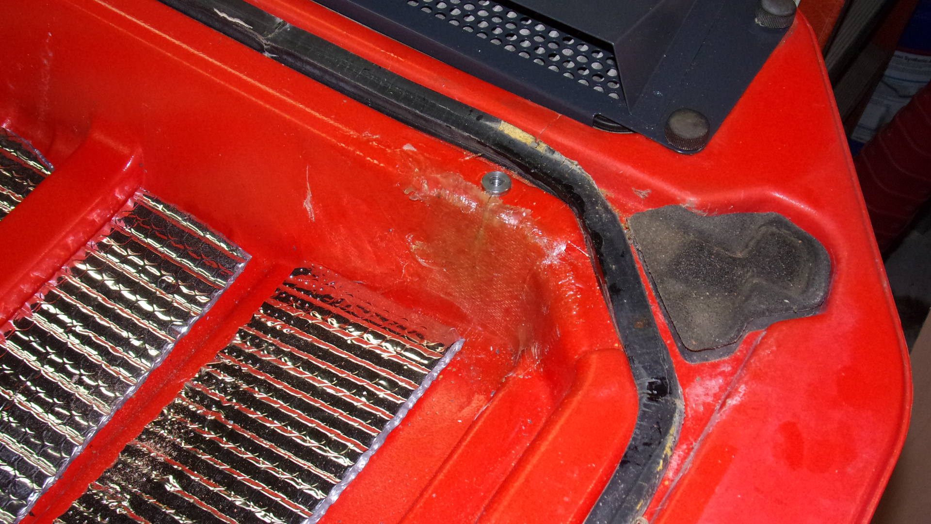

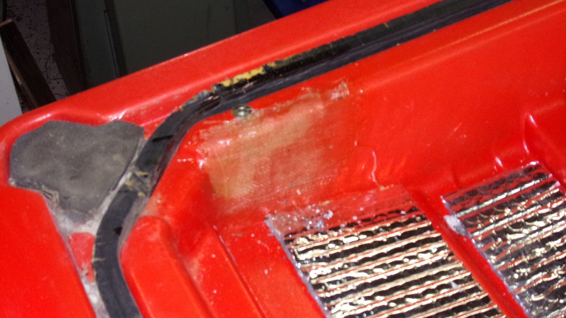

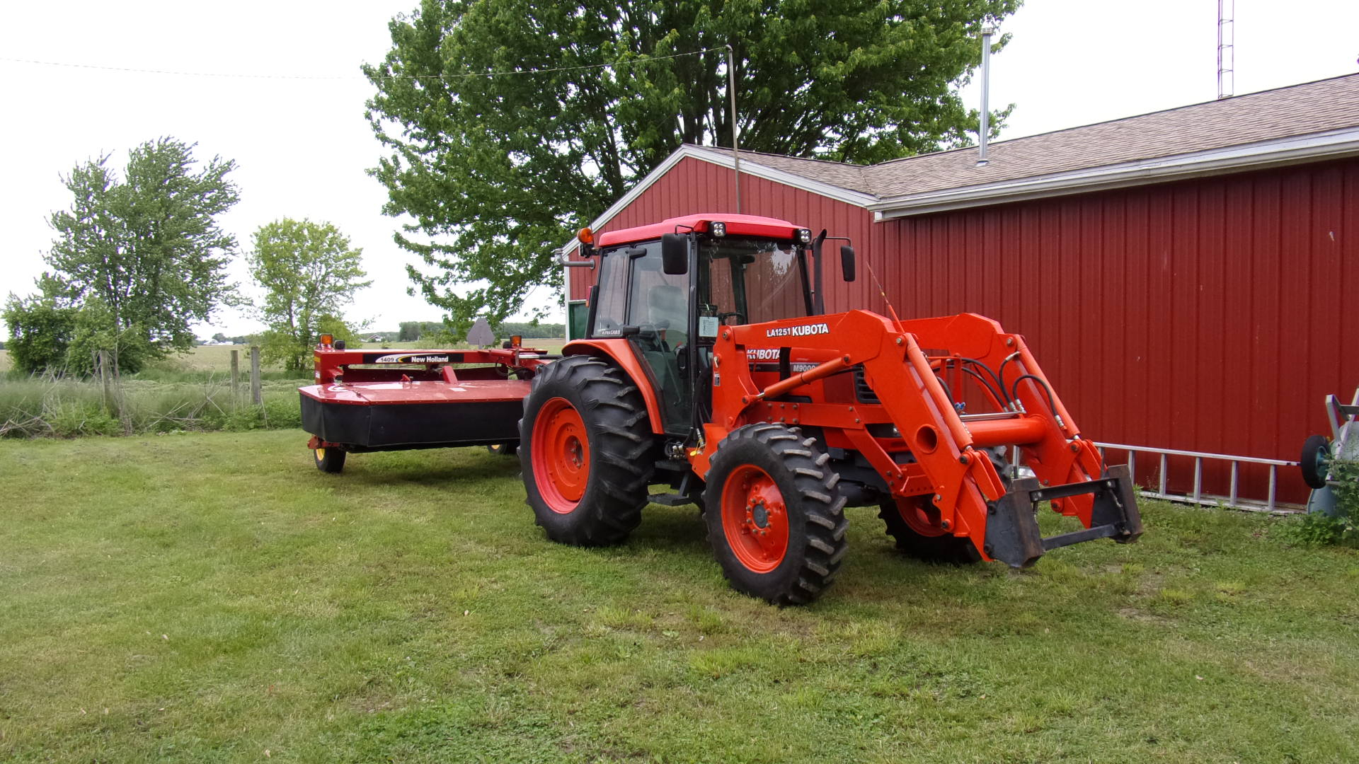

Kubota used Nut Certs in the roof that the screws screw into and on mine, the nut certs cracked the plastic roof where Kubota installed them and I wasn't about to buy a new roof ($1000.00) for a new roof, so I fiber glassed the nut certs in and the cracks they made in the roof. Worked excellent.
You might want to order a new roof gasket, I did. My roof gasket has been deteriorating right along, so I replaced it this spring. My M is a 2004 model btw.
Pictures are before I replaced the gasket. It's just under 100 bucks at the dealer and cone with adhesive on it, pull the backer tape and stick it.
