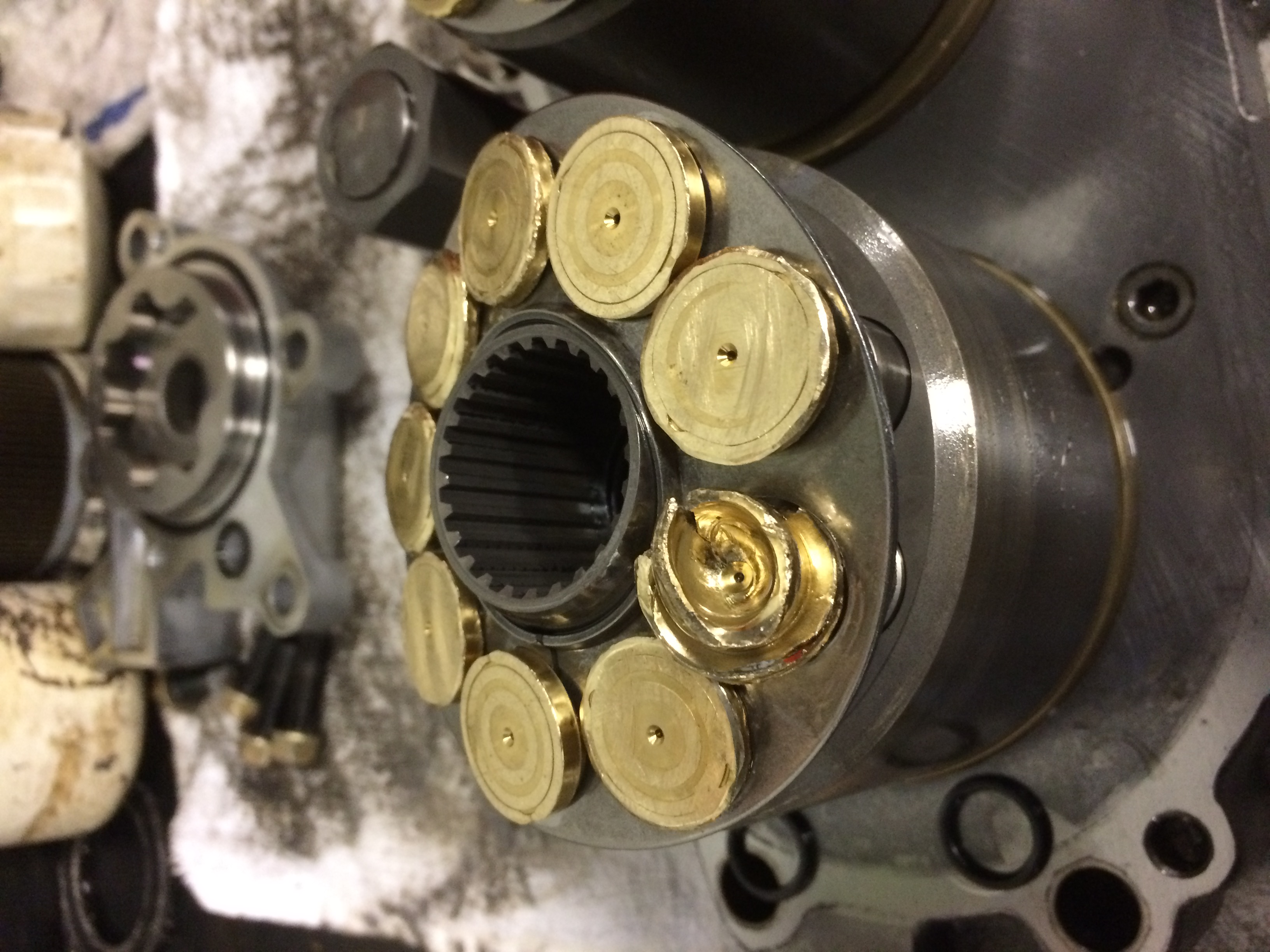

I was finishing up some rotary cutting for the day when I noticed a chattering noise while turning corners. Front wheels were not falling off so I decided to drive the tractor home immediately, and by the time I made it back 2 miles the drivetrain was slipping so badly I could only move in Mid range, low speed at 4 mph. When I tried high speed, it created a terrible grinding noise equivalent to shifting a vehicle without clutching. Made no difference in 2 or 4wd.
The clutch still works fine to engage the pto, so that seems ok. Once I reached the yard it seemed to work slightly better in reverse, probably because that side of the gears has not been chewed off yet.
It almost seems like a spline shaft has backed out, and is just barely making contact with the driven gear.
Tractor has 298 hrs, I envision thousand dollar bills floating away to the dealer next week. Any thoughts?

Have you checked the HST oil level recently?
   / L5740HST Drivetrain Slipping #3
As whirly said, I recommend checking your fluid levels.
But it sounds like you have other issues going on. I would pull the filter to see if there is any chunks of metal debris. If you see that, then you need to have it serviced.
   / L5740HST Drivetrain Slipping #4
First step is to make sure trans oil level is good. But if fluid is way low, the HST just quietly stops sending power to the wheels. The HST uses the same internal parts for F and R, so if one direction is really different the grinding noise is not likely related to the HST.
The racket could be from broken shifter parts in the range gearbox, or possibly a failibg/failed main clutch. The foot clutch disk at the engine flywheel powers everything else from there back. (The small hydraulic pto clutch only affects whether the pto is engaged)
To isolate symptoms, jack up both rear wheels, select 2wd, select high range, idle the engine and see what it sounds like. If reasonably quiet, slowly push HST pedal toward F, back to N, and toward R, noting how it acts with low turning resistance in the drivetrain. If there's less noise than when driving, it would point to the range gear selector parts. May still mean splitting the machine but unlikely to be crazy expensive. Good luck, and let us know what is found. Dick B

Sounds like some failure in the differential. Is the problem really range related -- What happens if you engage diff lock?

Its loaded on the trailer and going into the dealer tomorrow.
After looking at the online parts diagrams, I could see a coupling failure occurring between the spline shafts of the hst and transmission. As to checks; oil level is good, diff lock works. I can hold the unit in place with the brakes, and put the hydro pedal down to hear the gears grinding. If I release the brakes it goes forward and shifts between high or low speed. Reverse works way better, due to the gears not being chewed off as much. That's how it went onto the trailer. I'll keep you guys posted.

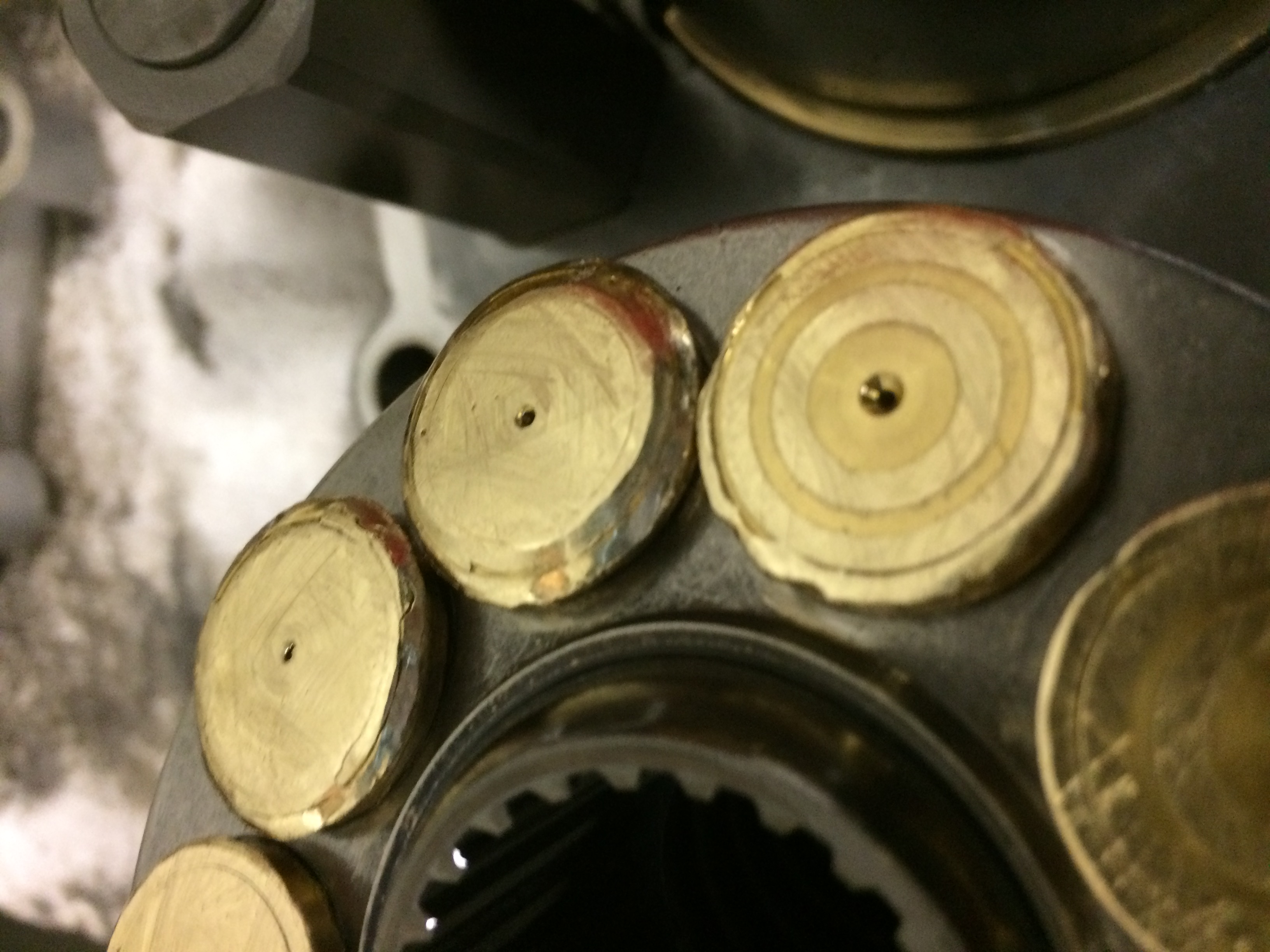

So the techs finally lifted the cab and split the tractor to discover this mess in the hydro drive. I see what parts were making the grinding noise now. One of the pistons in the hydro motor broke loose and helped chew up the others with the brass filings.
First parts estimate (plus the 30 hrs shop time @ $130) was $8k for a complete new hydrostatic. Once they disassembled, they revised it to $1700 for the parallel motors and $1700 for a new pump. Techs stated they rarely have ever seen a hydro failure, but for me with just under 300 hrs use I'm sure not impressed having to deal with it.

After reading your first post of the symptoms, I tried to offer some tests to narrow the possibilities. Carnage like this in an HST's pump/motor is really rare. Different noises in forward and reverse is very odd too because all the same parts are working, just turning the other way.
Perhaps your dealer can arrange to get Kubota factory help examining (and correcting) this bizarre failure of a young machine. It's not supposed to happen. TBN posts about HST issues are almost always traceable to linkage on the outside. I was hoping yours wasn't as serious a problem as it clearly is. Sorry my post was too optimistic. Dick B.

View attachment 528631View attachment 528630
