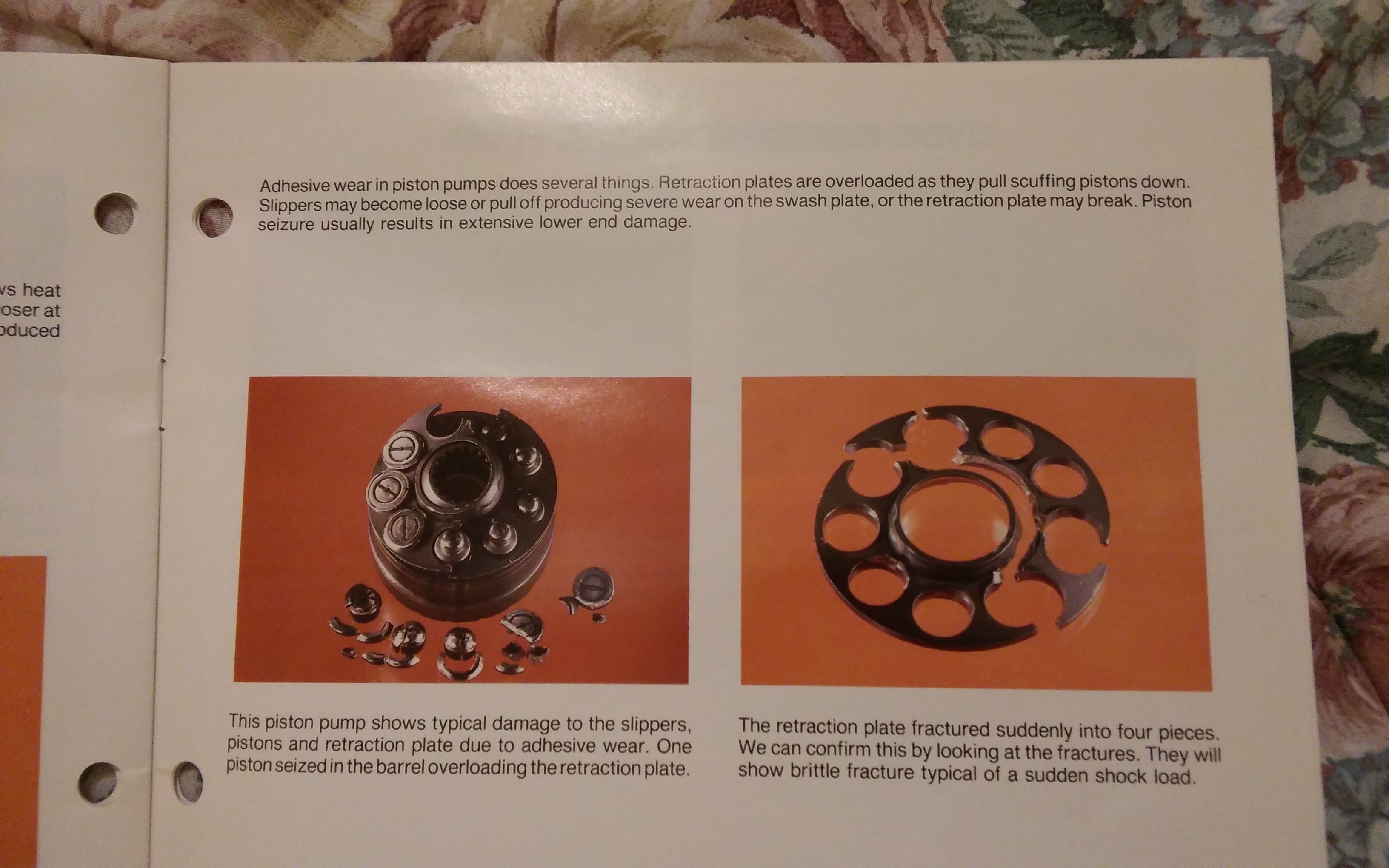

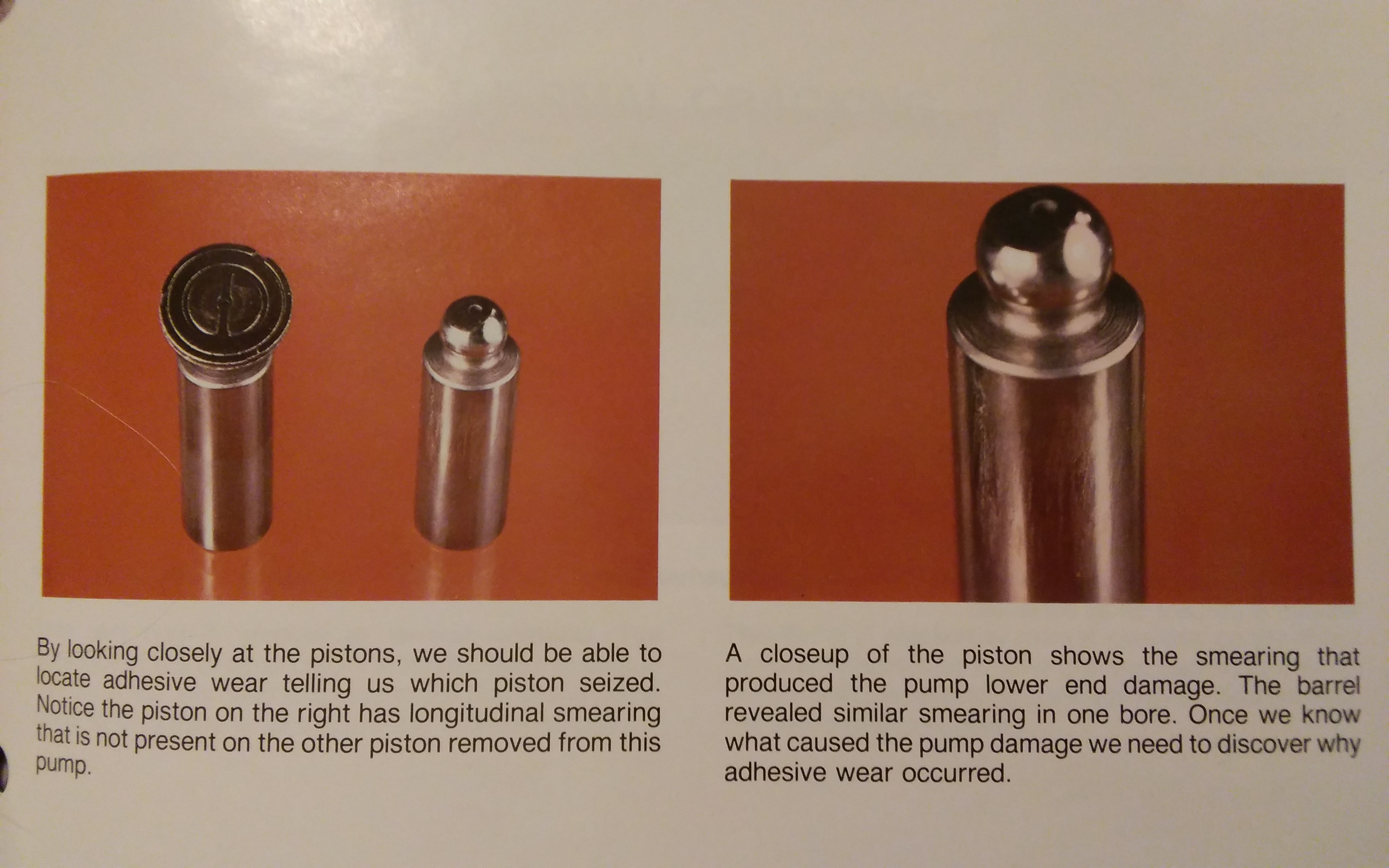

Here are 2 items from my hydraulic pump/motor failure analysis manual. As shown here and in my experience, a sticking piston will usually break the retainer plate and yours appears sound. Still it explains how to identify a sticking piston by scuffing, abrasion marks on the piston.
I can't find my collection of failed piston - my wife has a different opinion of art than me so she stored them away where I can't quickly find them. I know I've posted pictures on this site before for trouble shooting help.
Under the conditions you describe, there should not be a viscosity problem. Still I do not understand why Kubota does not have a hydraulic temperature warning on their tractors. Its not that they won't overheat - I've measured temperatures beyond hydraulic component supplier limits on both my M135GX and L5740 - Here in cool Northern Minnesota. M was due to a faulty valve that kept the system at continuous relief pressure. L was operator abuse - I worked it too hard in dirty conditions that partially plugged the oil cooler. Engine temp alert they have but equally expensive hydraulic system no monitor. I keep an I-R thermometer on each of my tractors.
Nice pix, MHE. Who writes that manual?
I have not heard the term "adhesive wear" before. It seems to mean the failure of the lubrication film.
I am also guilty of collecting failed components for show-and-tell.
   / L5740HST Drivetrain Slipping #23
..........I have not heard the term "adhesive wear" before. It seems to mean the failure of the lubrication film.....
It's another term for galling. When the lube film layer gets too thin high points on the surface grains start contacting and burnishing each other. The friction causes even more heat and pretty soon "pills" start rolling out of the surfaces. They quickly get bigger than the tiny clearance and it locks up. Hydrostatic drives need clean and perfect surface shapes and durable lube film thickness, else game over.
