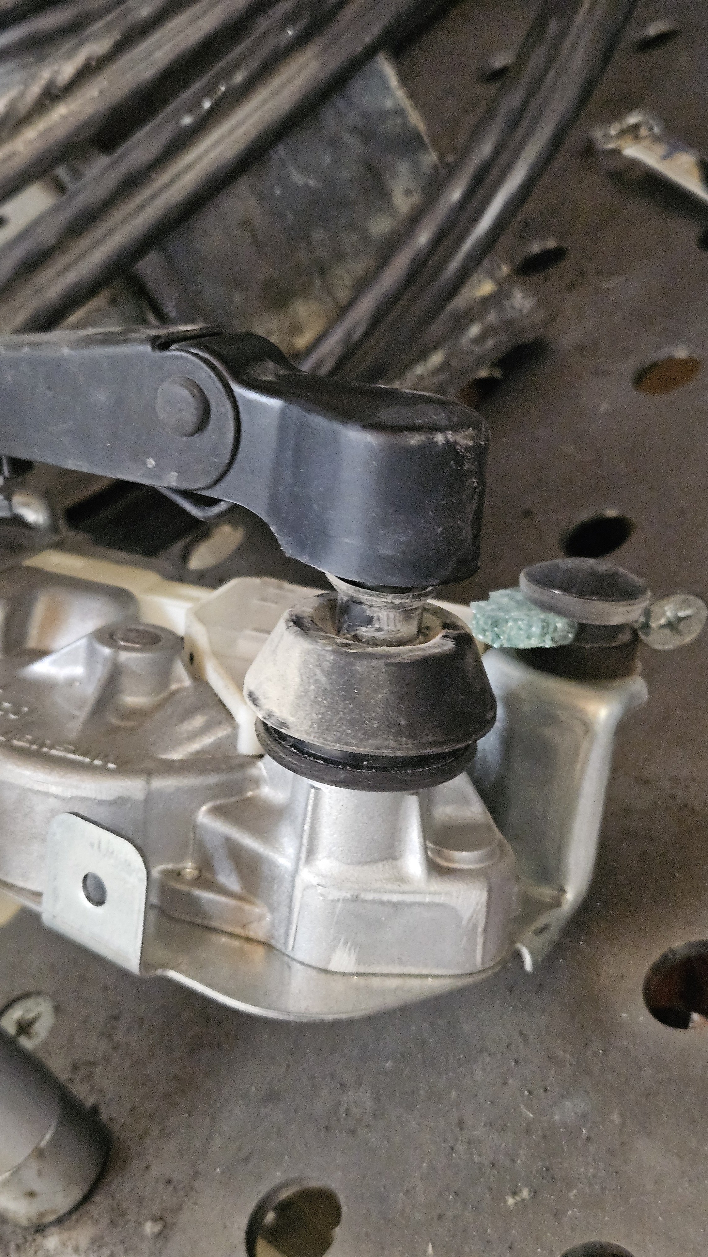

Glass is installed. Thanks everyone. Next question. How does this wiper arm disconnect? Wiper motor is all I have left.
   / L6060 rear glass struts disassembly? #12
You can see a thin metal ring under the main wiper end on the motor shaft. Take a flat screwdriver and press that ring up TOWARDS the main part of the wiper arm. The arm will pop off. It is a spring lock for the arm on the motor shaft.
#13
Got it. Thanks you.
