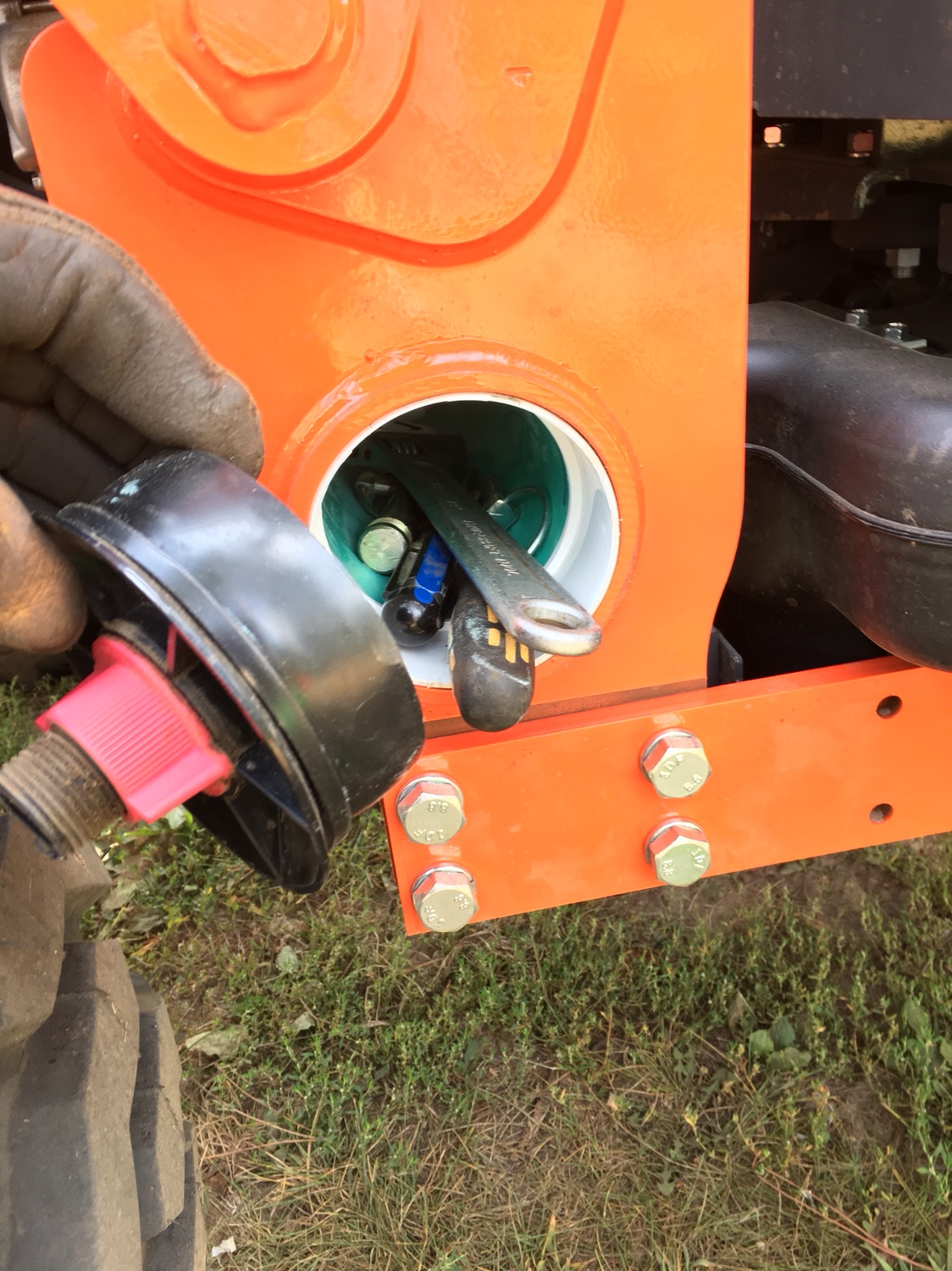

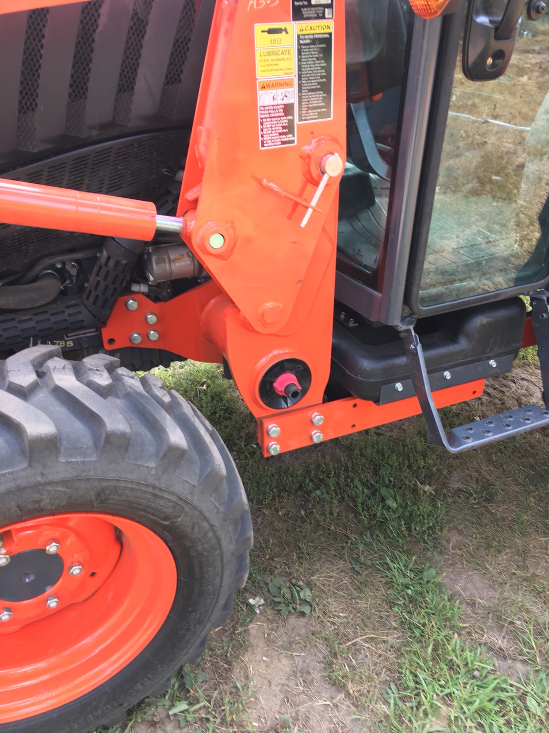

Saw this from a post on “Farm Show” and gave it a whirl in my L805 loader. Had to sand the plastic cap on the OD a bit...but was able to friction fit them with a few taps of a hammer. The cap has an expanding feature that is water and dust proof. Not huge, but can hold a chain or a few pins or tools. I also attached a Kolpin shotshell holder (belt carrier for trap shooting ) to the bar below the windshield. It holds lots of stuff for me.
Got everything I needed at the pluming section at Menards.....for about $14. Not too shabby....and it hold more than it looks.

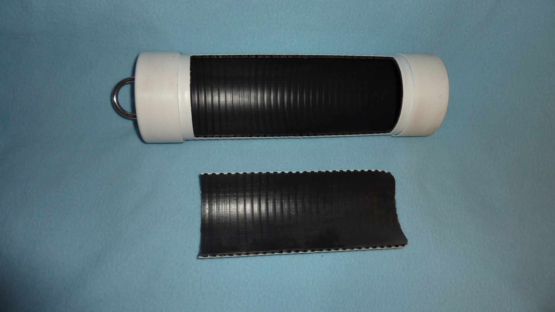

I made a pair of these for my MX5800 and found they fit the L6060 as well. In my case, the FEL hyd. lines run through the right side tube so I can only use one on the left. The trays also fit the cross tubes of many FEL's but the contents move around as the FEL is raised and lowered. Ok for water bottles, cans of chain saw fuel, etc. but not good for fragile items.
View attachment 524560 View attachment 524561

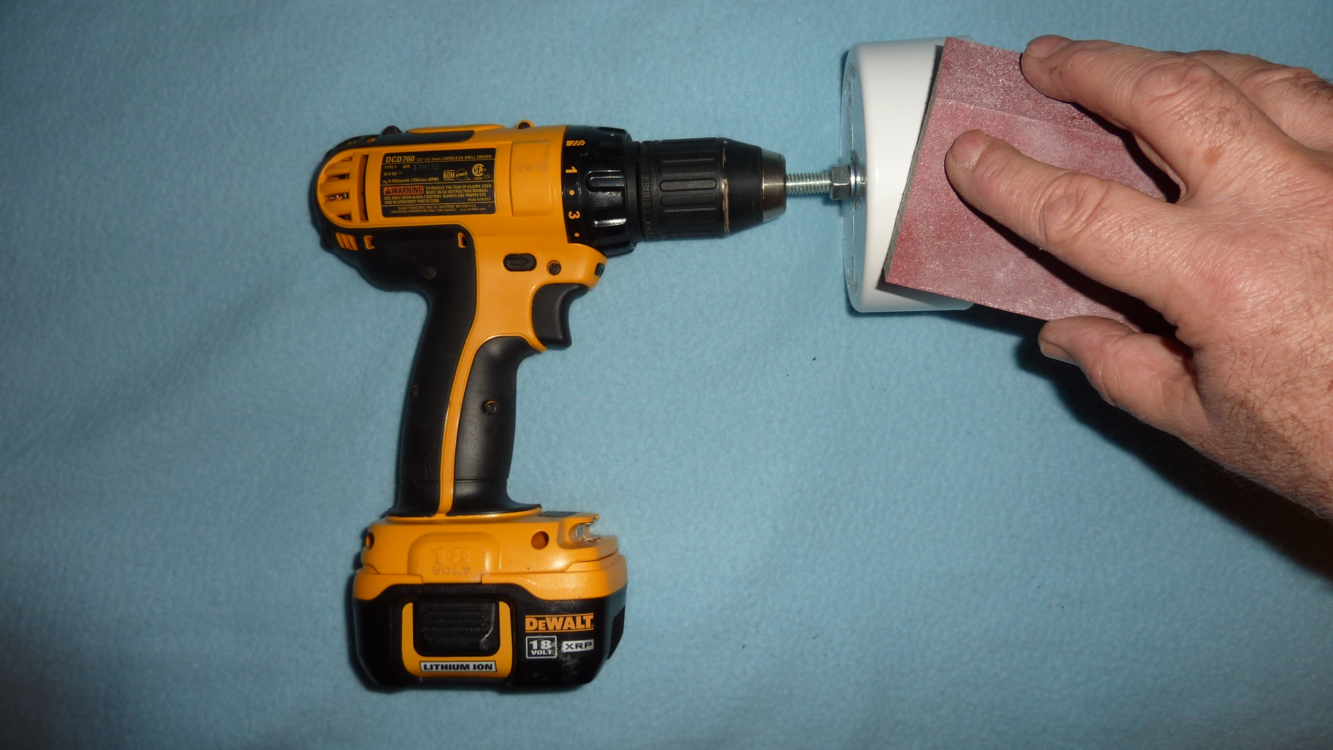

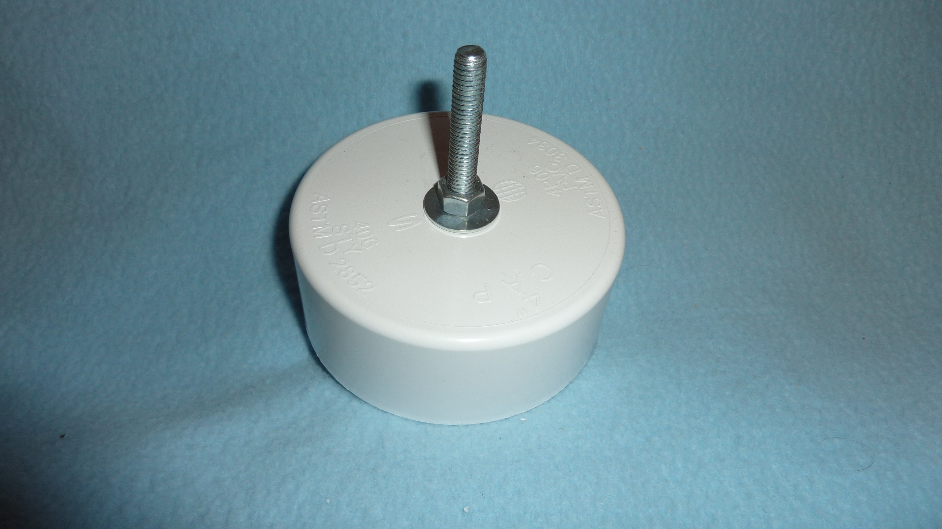

They are fairly easy to make from some sch 80 PVC pipe and fittings available at Home Depot. Some sanding is necessary for a good fit:
View attachment 524562 View attachment 524563 View attachment 524564 View attachment 524565 View attachment 524566
The trays are a press in fit and I've never had one come loose but if you're worried about it, you can always do something like this:
