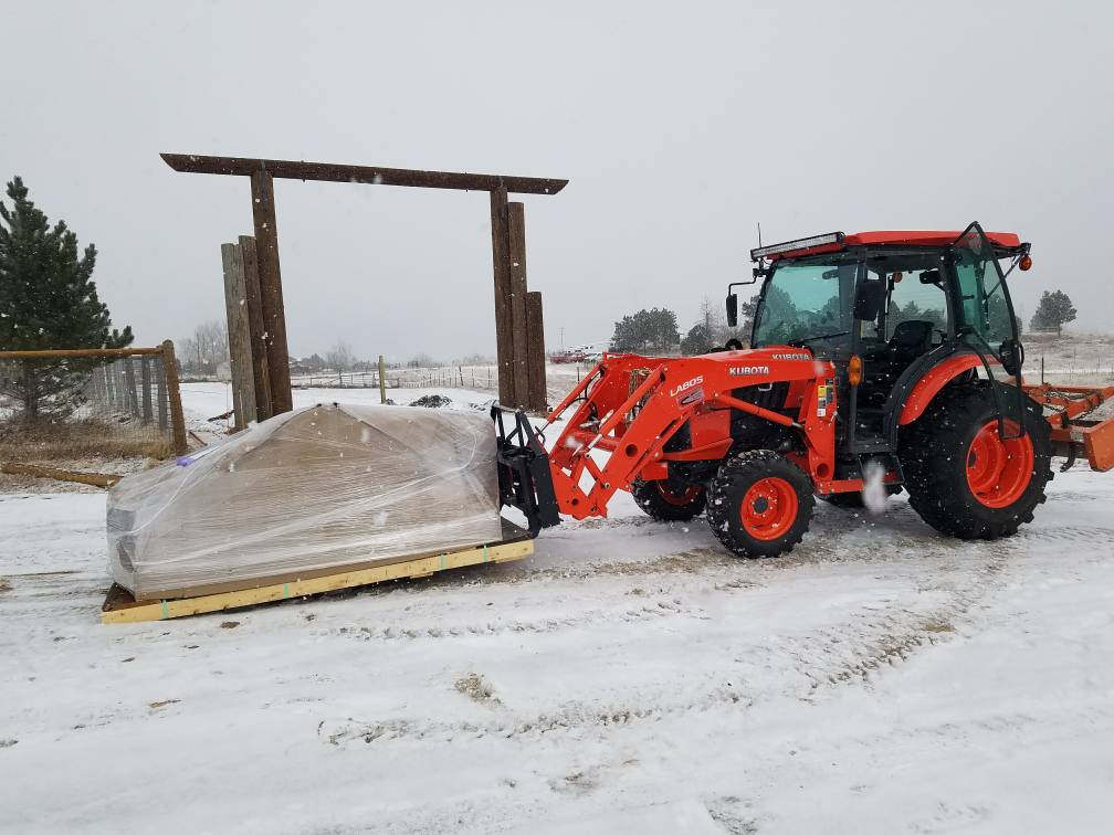

My L4060 couldnt quite lift a pallet (my flail mower which was suppose to weight 1,700lbs bare) labeled as 1,910lbs. I pulled off the PTO shaft & some plastic then could lift it a foot. Probably 250lbs of pallet forks on there too.
With loaded rear tires & a light or no rear ballast my L4060 felt way more stable than my L3200 with loaded rears & maximum rear ballast.
I would have liked to be able to afford a L4760 or bigger to get the big loader in addition to the extra HP. The medium loader is decent, but weak compared to the tractor weight. My L3200 could lift the rear off the ground with lots of ballast. There is a weak spot in every system. Ballast on the L3200, hydraulics or possibly front axle on the L4060.

And found a photo... failed to lift that pallet rotated 90 degrees along the wide side with the weight closer too. Pushed the pallet up to the shop an inch or so off the ground. 20171221_125820.jpeg
