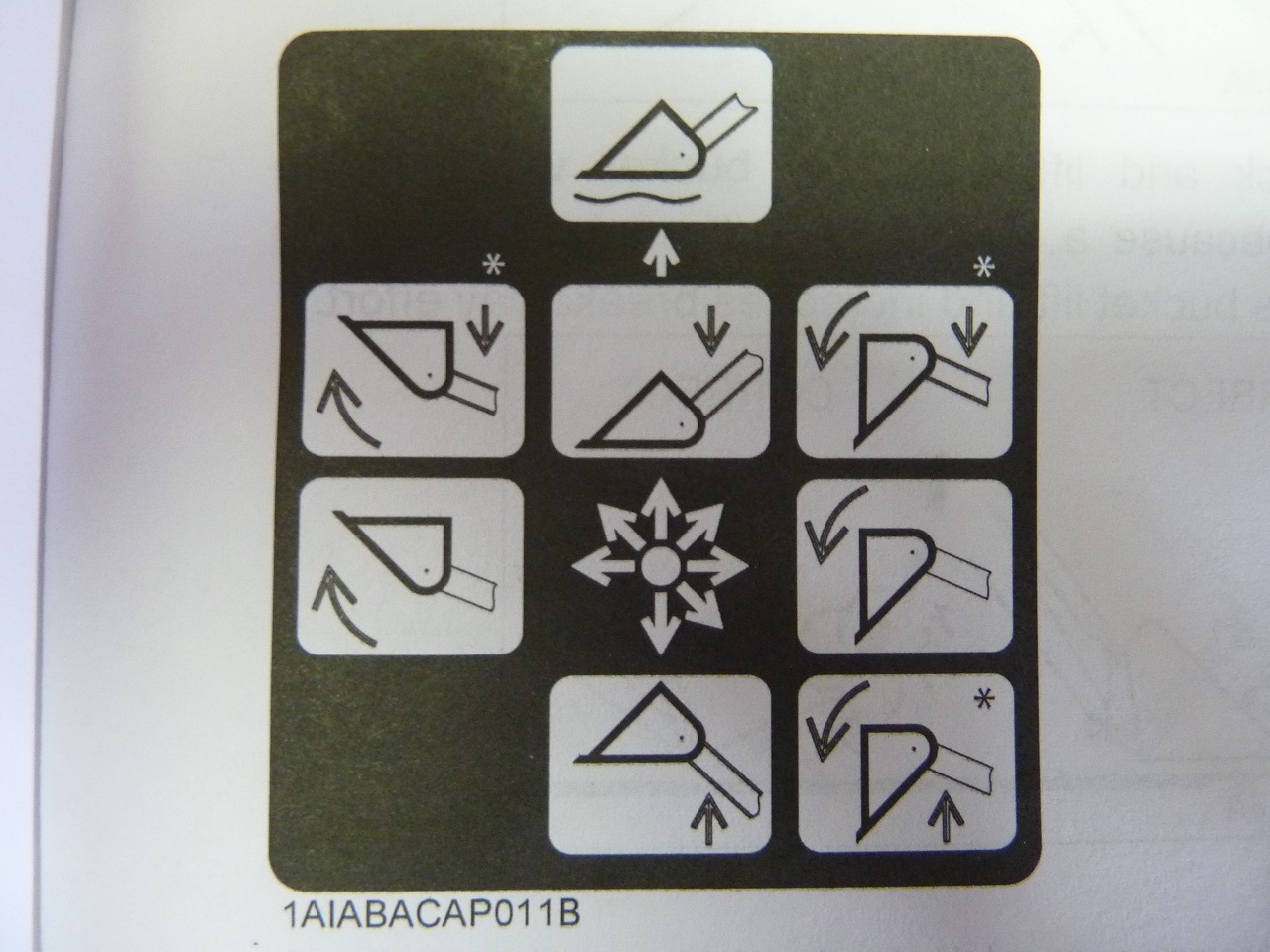

Does anyone know offhand of the LA1065 found on the MX series tractors has a 3 position valve or 4 position?
   / LA1065 #2
Not exactly sure what you're asking but I think the valve is pretty standard for an FEL:
Up to down goes Float-Lower-Neutral-Lift
Left to right goes Curl-Neutral-Dump

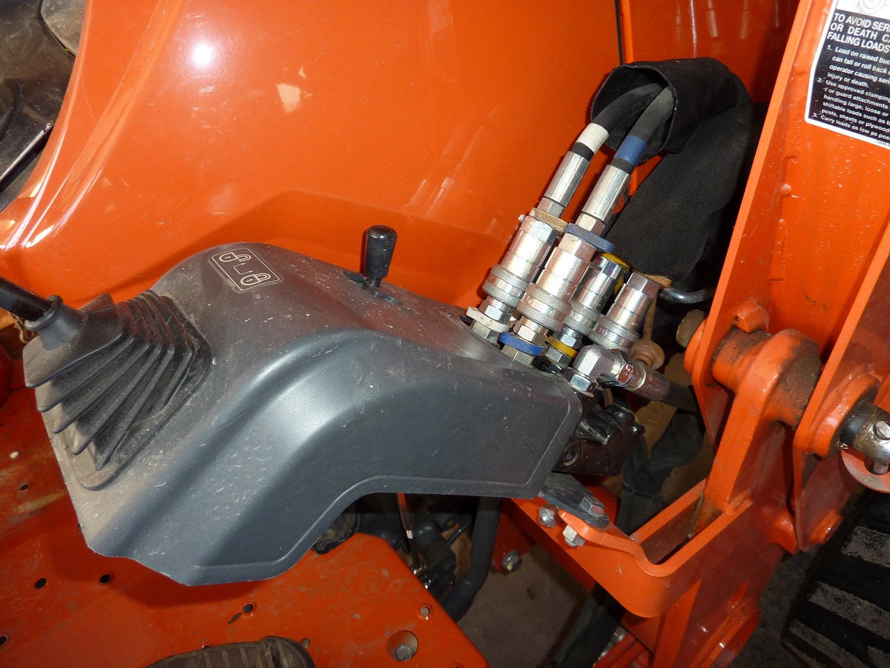

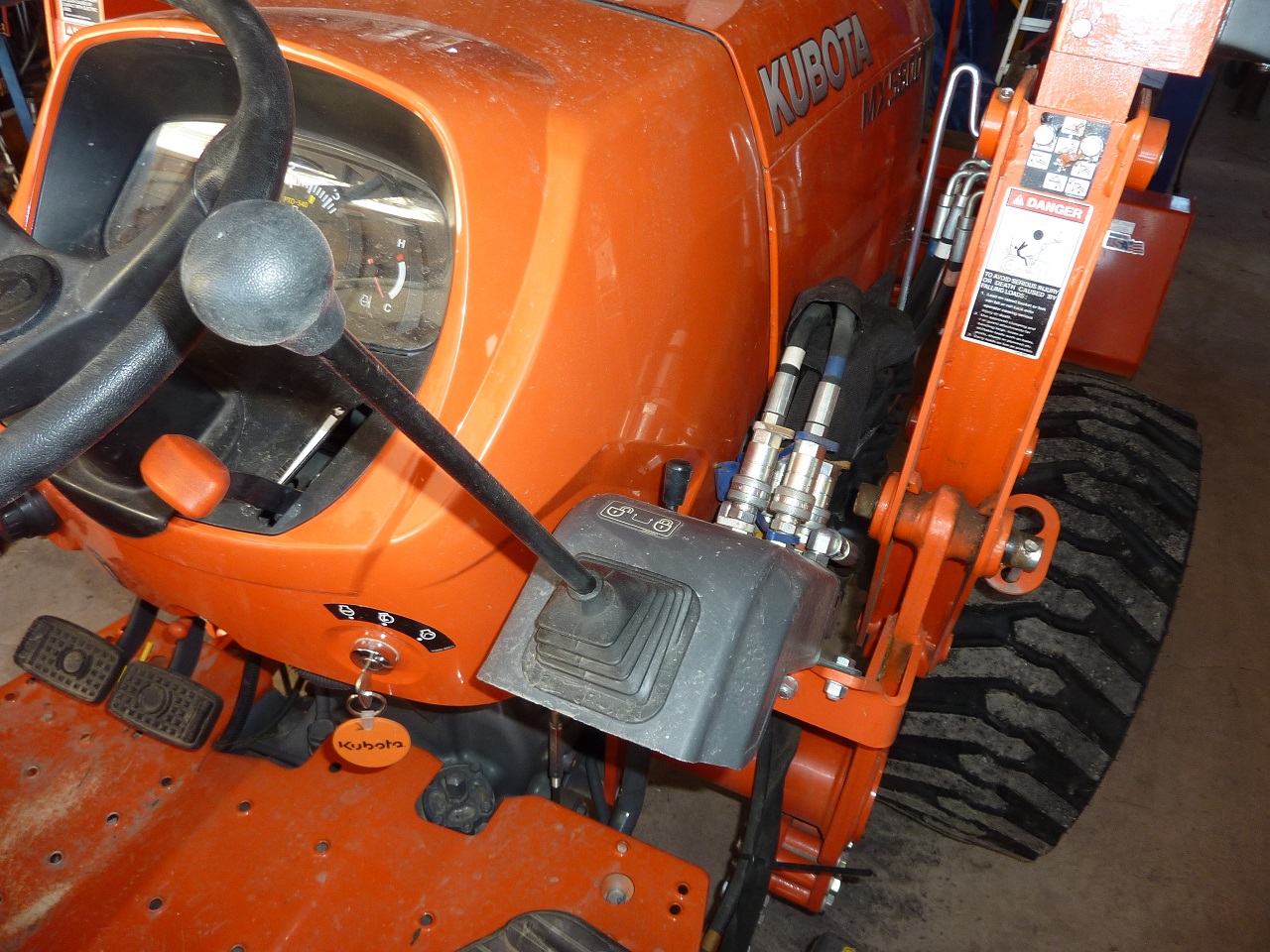

   / LA1065 #3
Not sure what you mean by "3 or 4 position" but here are some pics of the LA 1065 valve and control diagram on my MX5800.
Hope this helps.
   / LA1065
Let me ask another way, does the dump have a detent in it as in a dump-fast dump or just a single position which is fast dump.
Looking at that diagram it appears to be single position which don't make me happy at all but I guess I'll live with it if it is.
   / LA1065 #5
No, the LA 1065 on the MX5800 has no detent in the dump function. When fully open, the dump is moderately fast. The only detent in the valve is the float position of the loader arms. You may be referring to the "Quick Dump" feature on some of the Grand L series loaders. I had that feature on my old L3430 which had detents in both the dump and loader arm hyd. circuits.
