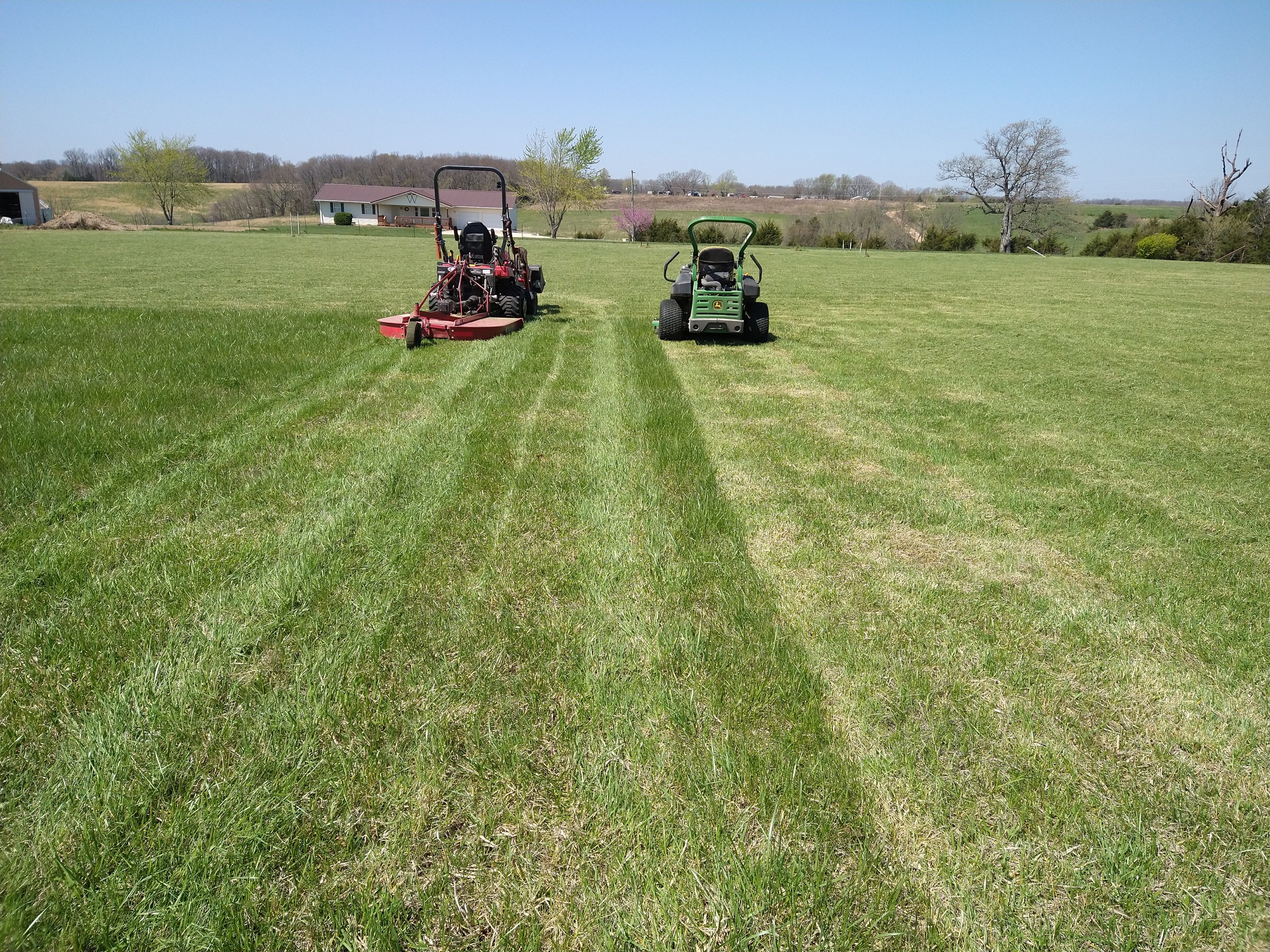

Just to be clear ... I wasn't recommending a finish mower for the OP ... It's what I'm gonna buy to mow every few weeks ...
