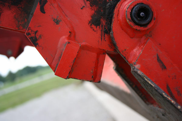

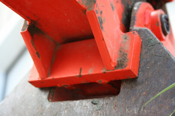

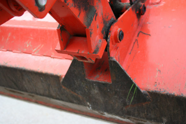

   / LA723 Loader Stops #13
Someone did a half modification on your FEL before you got it.

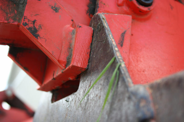

#14
I'm not sure what you mean by "half modification"?
Thanks for the pictures. I guess this is what mine should look like? It makes sense that the blocks of steel are where they are on the pictures.
   / LA723 Loader Stops #15
By half modification I mean that someone made that standard LA723 a QA but never welded on the extended bucket stop blocks.

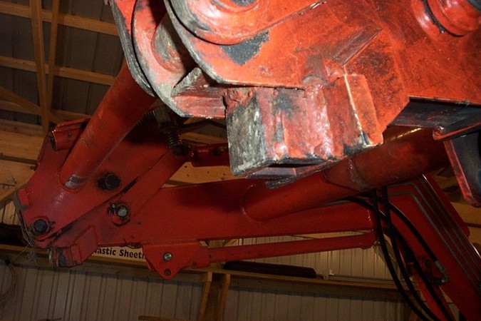

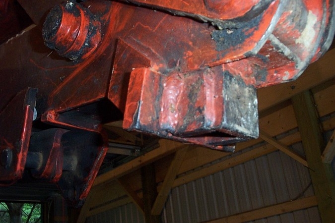

   / LA723 Loader Stops #16
I am note sure if this is too late but here are a few shots of my 723 loader stops. I have the standard bucket not the QA. Steve
