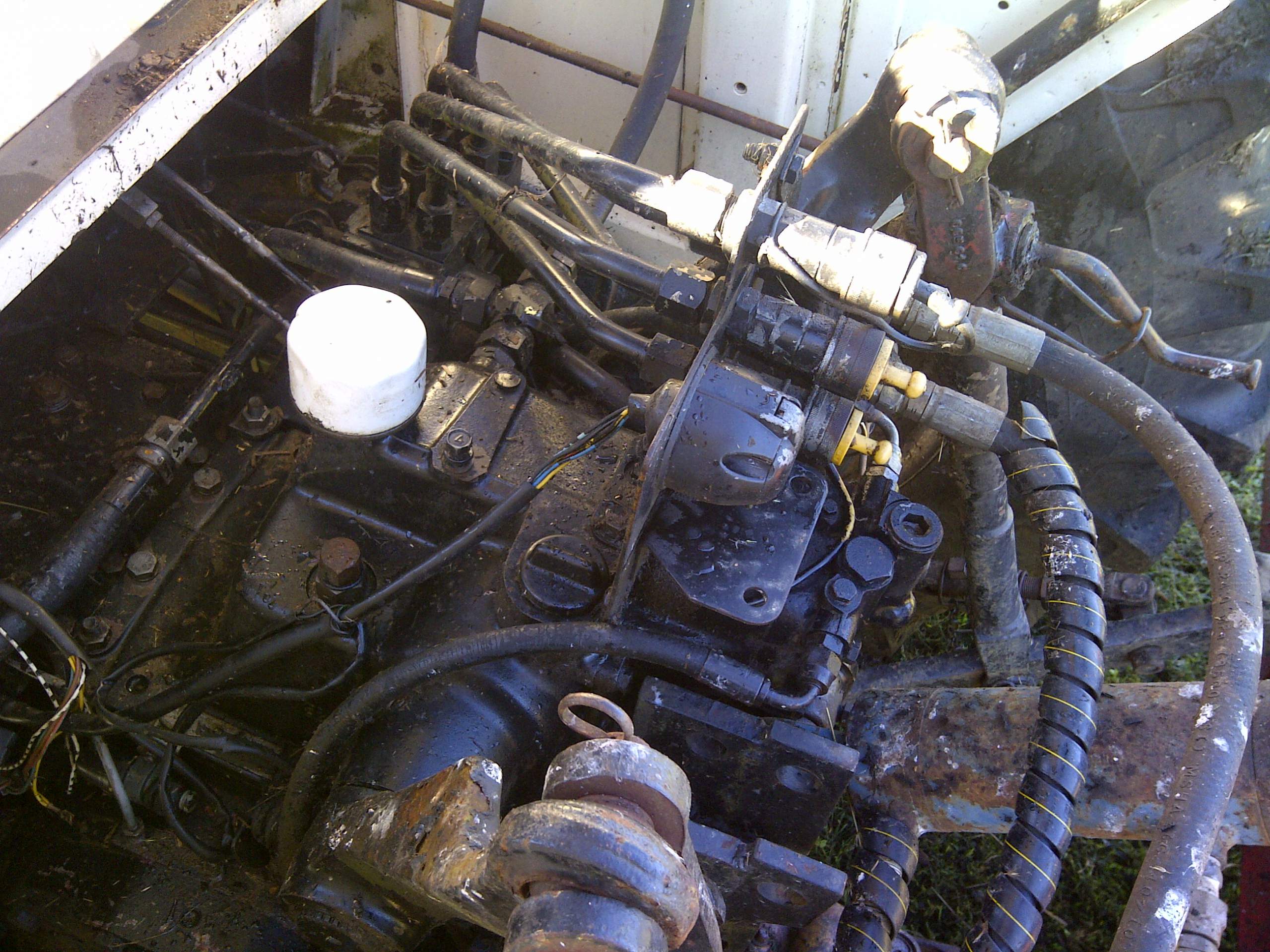

   / Lamborghini 774-80N Rear Oil #4
Attached should be photo showing the top of the transmission for the Lamboghini 674-70. Your 774-80 should be similar. Breather is the white 3" spin on cartridge filter. Filler point is about 6" to the rear of the filter.
I had similar trouble getting a workshop manual for the 674-70. Ended up going to the local SAME dealer and borrowed their manual for the Explorer series tractors 50 through 90 horse power. The Lamborghinis and SAMEs are the same for the transmissions, hydraulics, brakes, steering, electrics etc. Only key difference is the engine details. The SAME used an air cooled version while the Lamborghini used a water cooled version of the same 4 cylinder 4 litre engine.
Regards, John Davis

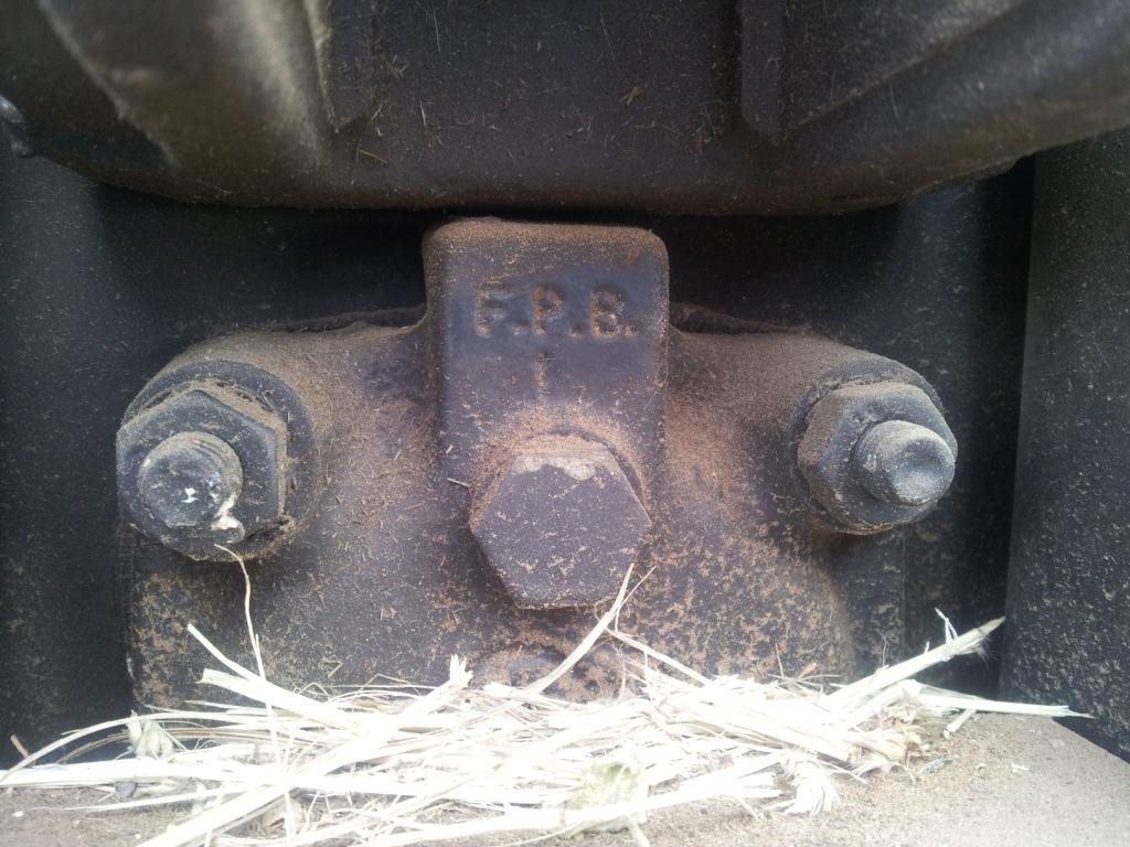

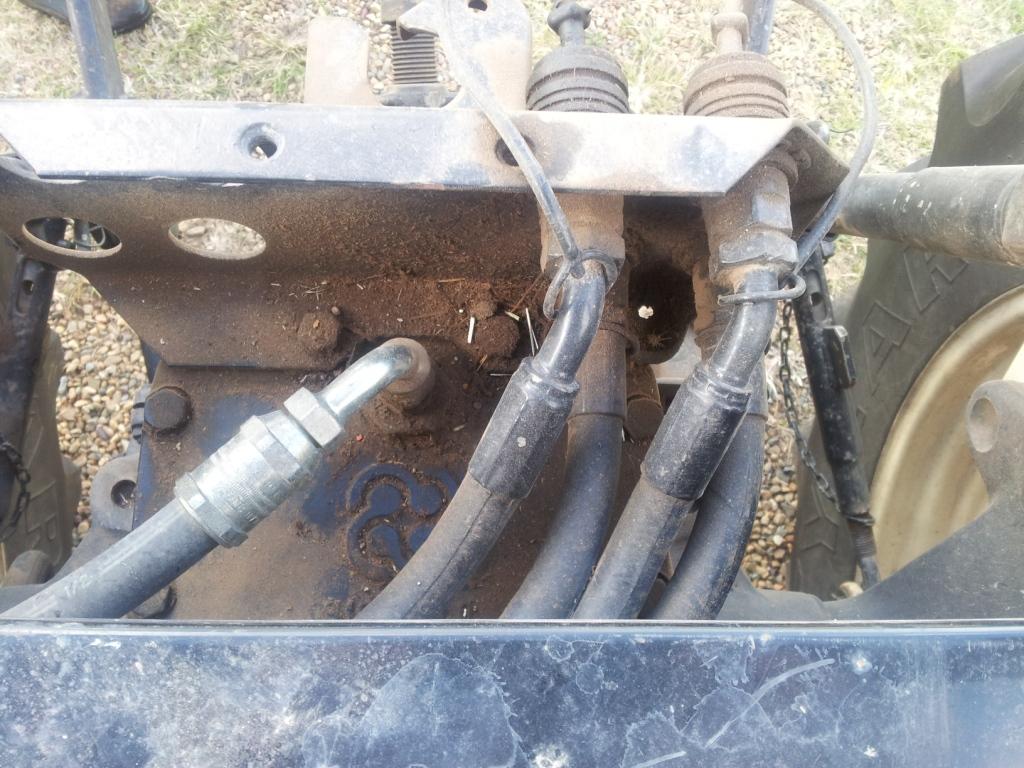

Hi John,
Thanks for the help. The rear of mine is different. I hope I have attached two photos. I have found a plug above the oil level..I have included it as well. Many years ago I removed what I thought was a fill point on a dozer and turned out to be a detent spring and ball which caused me hours of fun and swore I would never do that again.
Cheers Zac
Try again?
