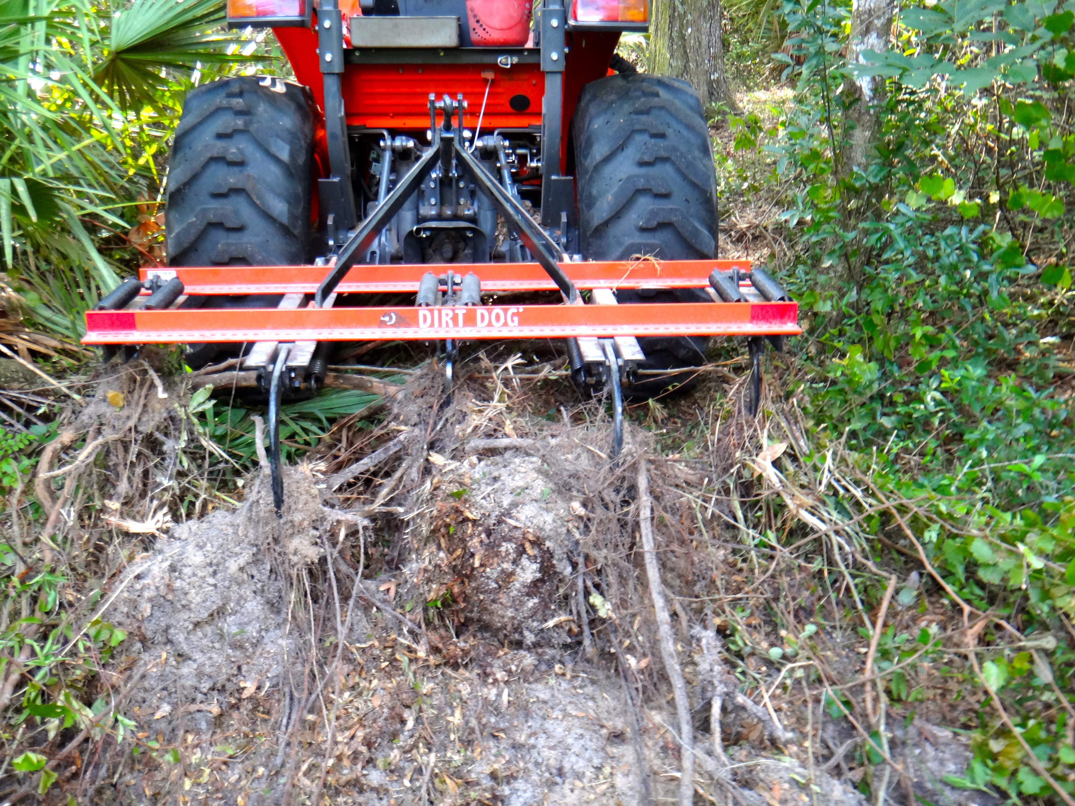

So my father-in-law gave my wife and I about 8 acres as a future house site and this past august I bought a Kubota MX5400 to start clearing it with hopes to build a house. It actually has a natural slope to a Ditch so I don't need to shape/contour the land as much as just smooth it out.
I own both a Field Cultivator and a heavy duty Rollover Box Blade weighing 620 pounds in 60" width. I have broken rippers on the Box Blade.
I have never broken a coil spring protected shank on the Field Cultivator.

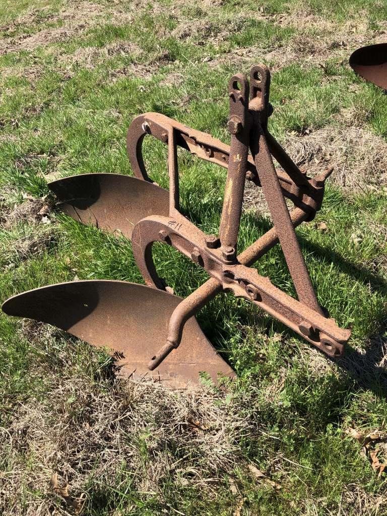

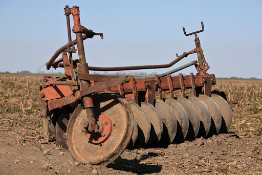

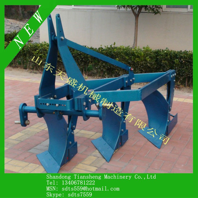

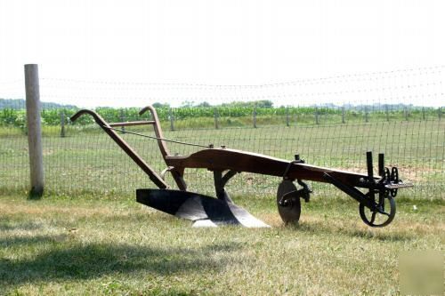

It all kinda depends on the size of the tractor. Rippers will work but they also require more HP and will have a tendency to clog up with roots. They use brute force to pull out roots and stumps. The plow cuts out a strip and turns it over. Follow up with a disk to break it all up and cut the roots into smaller chunks.
If enough HP is available a breaking disk would be the best choice.
A few pictures of breaking equipment.
C05BF38F-848E-46F0-B585-5876B8DD50D5.jpegC4339E85-B6D0-4510-9F04-4C0E03CFDD3D.jpeg716C2D8D-80A2-4376-82BC-541E2B5C5BAE.jpegA94C7C6A-66B5-4F4C-AA05-2E0B885CF200.jpeg
A couple of plow’s for standard field cultivation.
