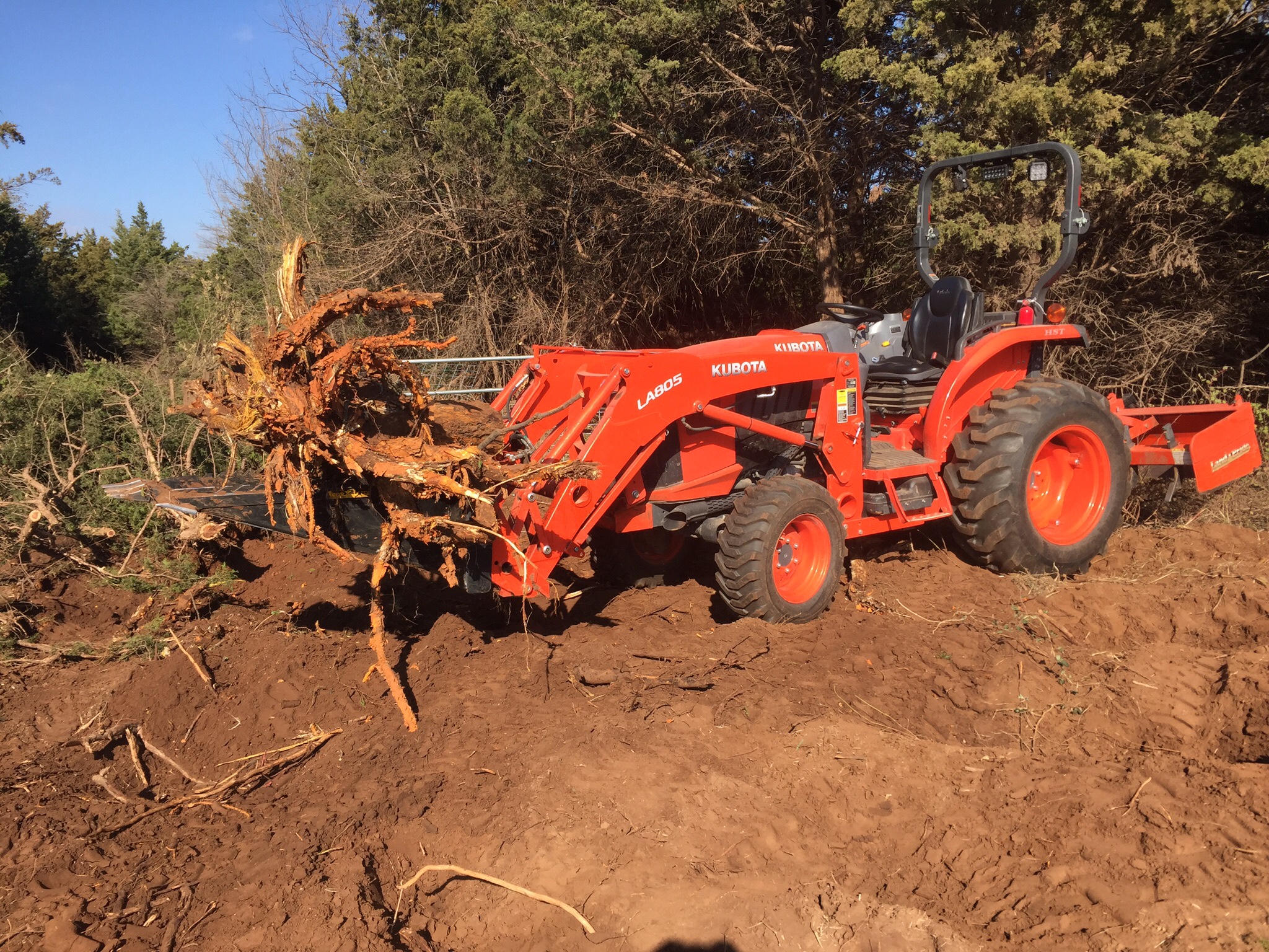

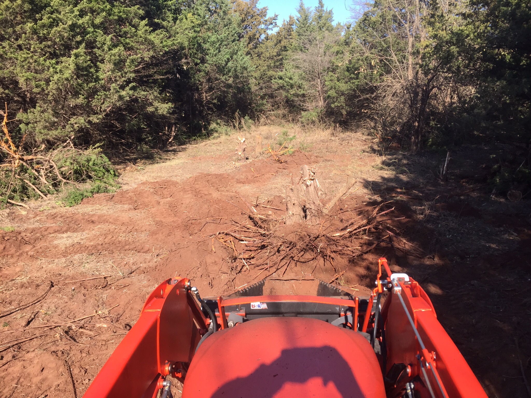

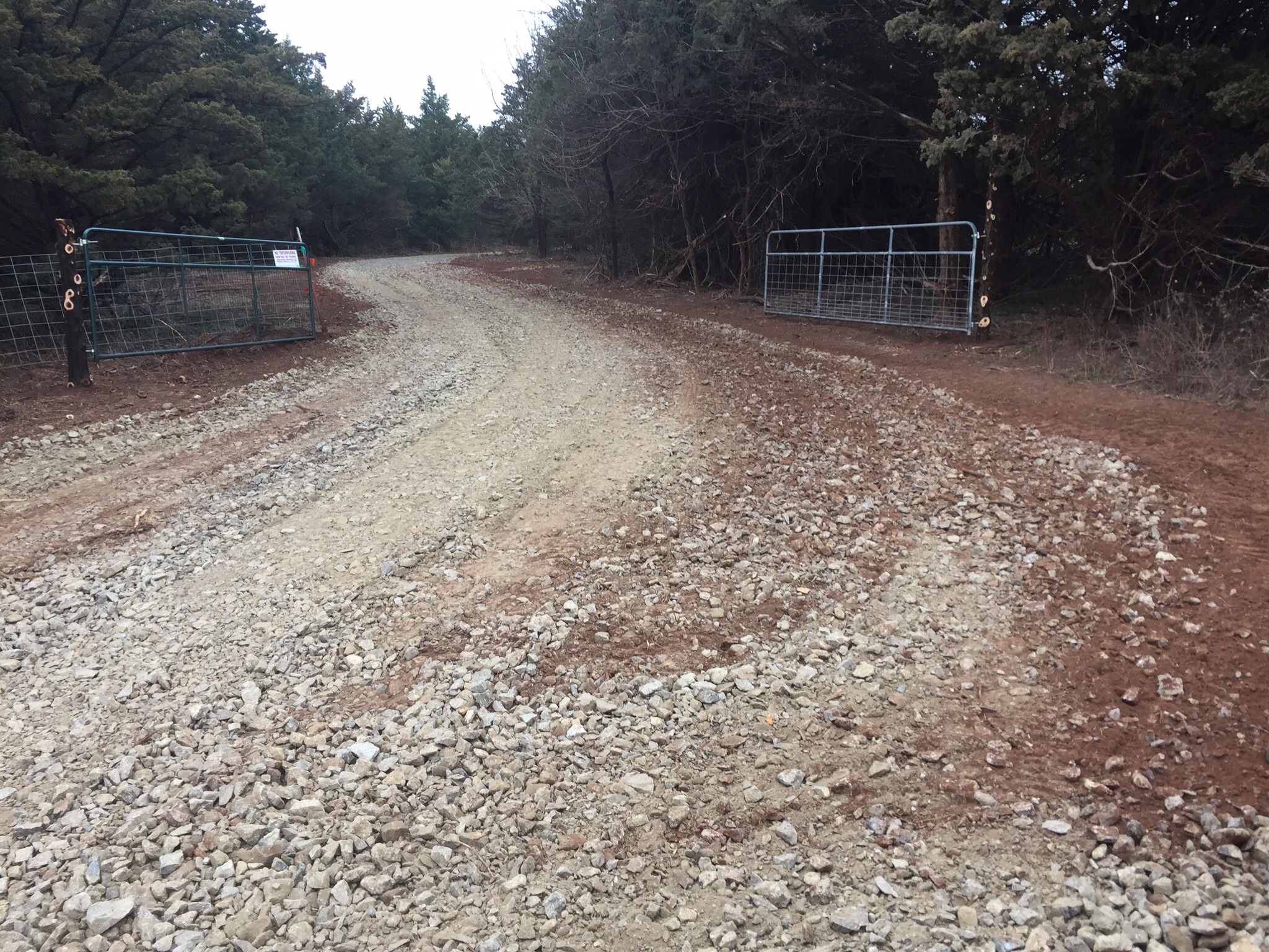

It's not a excavator but its a lot less money and perhaps fit on what you have. Do not lift your tractor up into the air on the front end loader and push with the tractor at the same time like some do. Take it easy and keep all four tires on the ground and you will have it done faster than you might think.
Worx Stump bucket from Everything Attachments used on a Kubota L3560 with LA805 heavy duty front end loader. 535 feet of drive 12 to 16 feet wide of heavy cedar cover with some bodark trees in the mix. Cedar up to 18 inch stumps (thankfully only a few of those) bodark stumps up to 12 inch or so. If you cut the trees own leave at least 3 to 4 feet of stump. If you can just leave the tree as is. Fastest way if you have access is to scoop 3 to 4 times on each side of the tree then move 1/4 turn around the tree and do the same again. Push em over and on to the next one. Start your scooping or digging furthest from you and work back so that most of the digging is into the hole you made. Pictures are when the project started out. And one of a bit of gravel applied.
