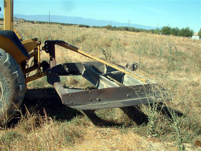

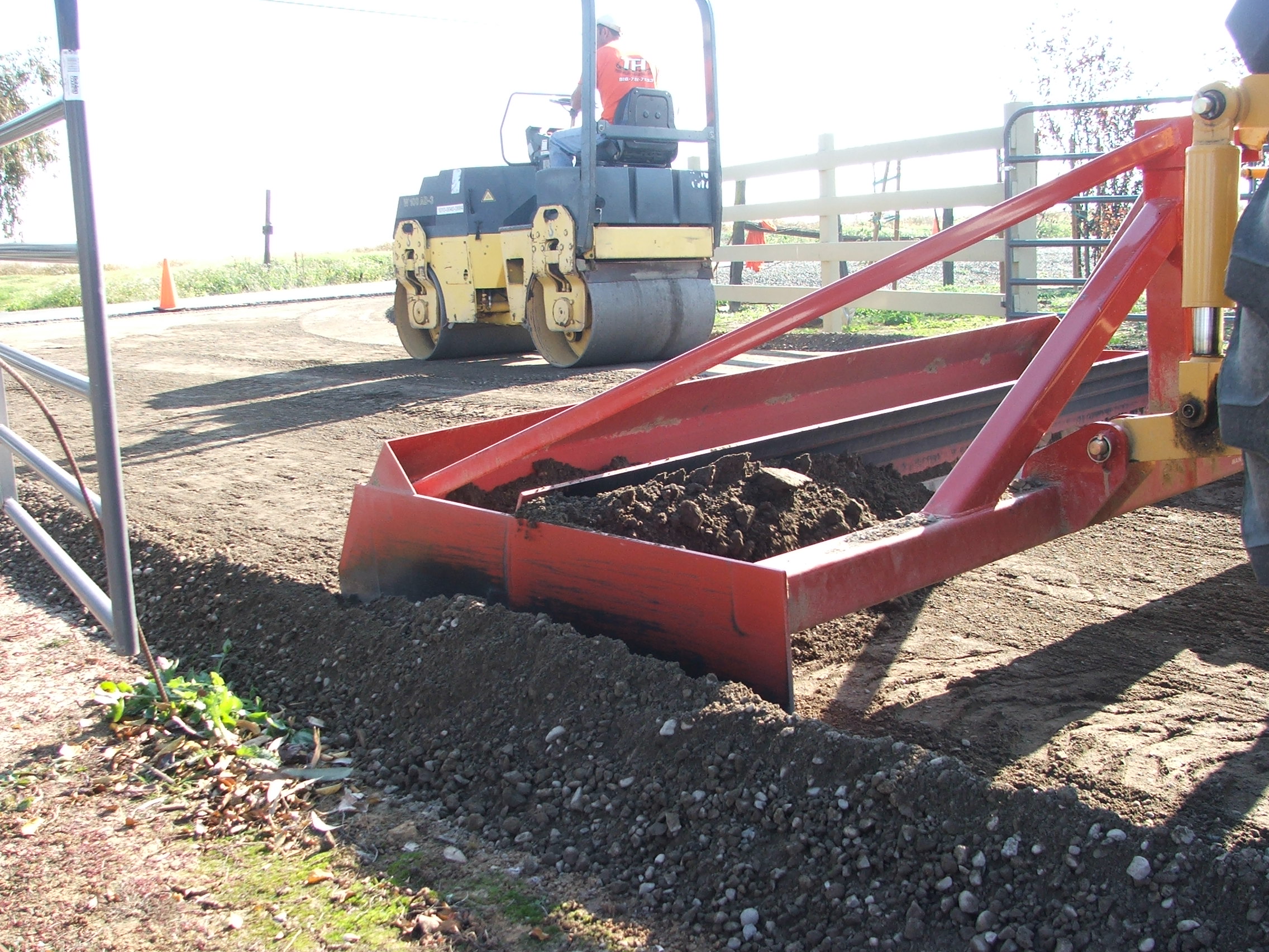

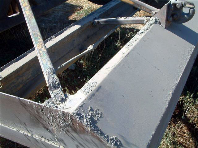

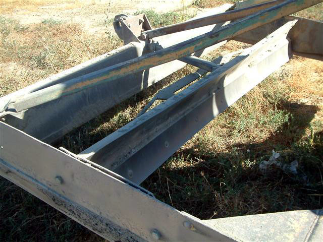

I still think (for a grader guy) that an "asphalt float" would be a wonderful tool. It uses the blade to cut and a "smoocher" to smooth material out the back. I'm not too sure how the smoocher part would work for a typical tractor since these are designed for skiploaders weighing 14k with down pressure. For sure it would have to be constructed heavier.
The first three pics are from one of our fellow TBN members. I don't know if it's a one-off custom or what, but I like it a lot. The last one I found on the web. It's a much simpler design built by Flynn and Thomas Mfg. There's no ability to angle the blade. I don't like it much.
Gravel Float 02.jpg Gravel Float 03.jpg Gravel Float 04.jpg Gravel Float Thomas.jpg
