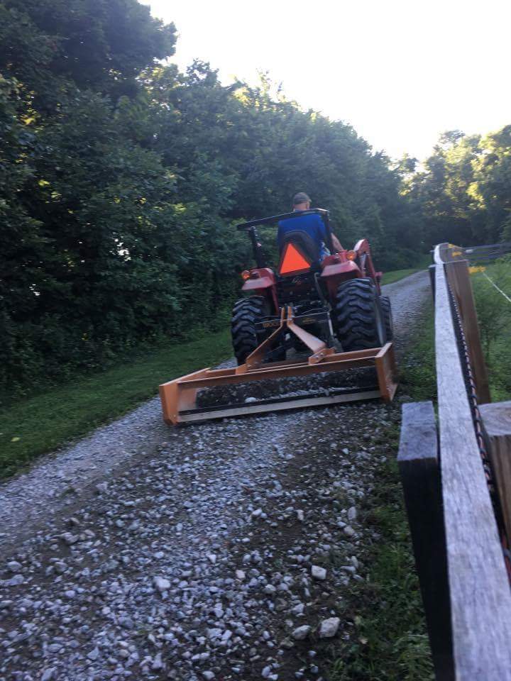

I use a Woods 72 inch and does wonders with 1300 feet of gravel drive. Weighs about 655 lbs. No scarifiers.

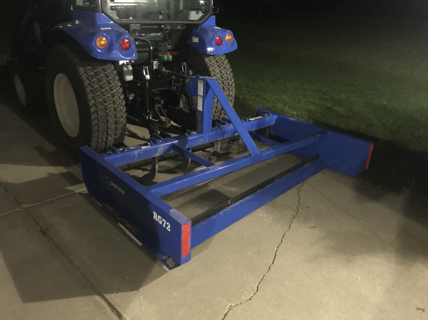

I graded my shop drive today with my new Bush Hog 72” works like a dream compared to my back blade.
