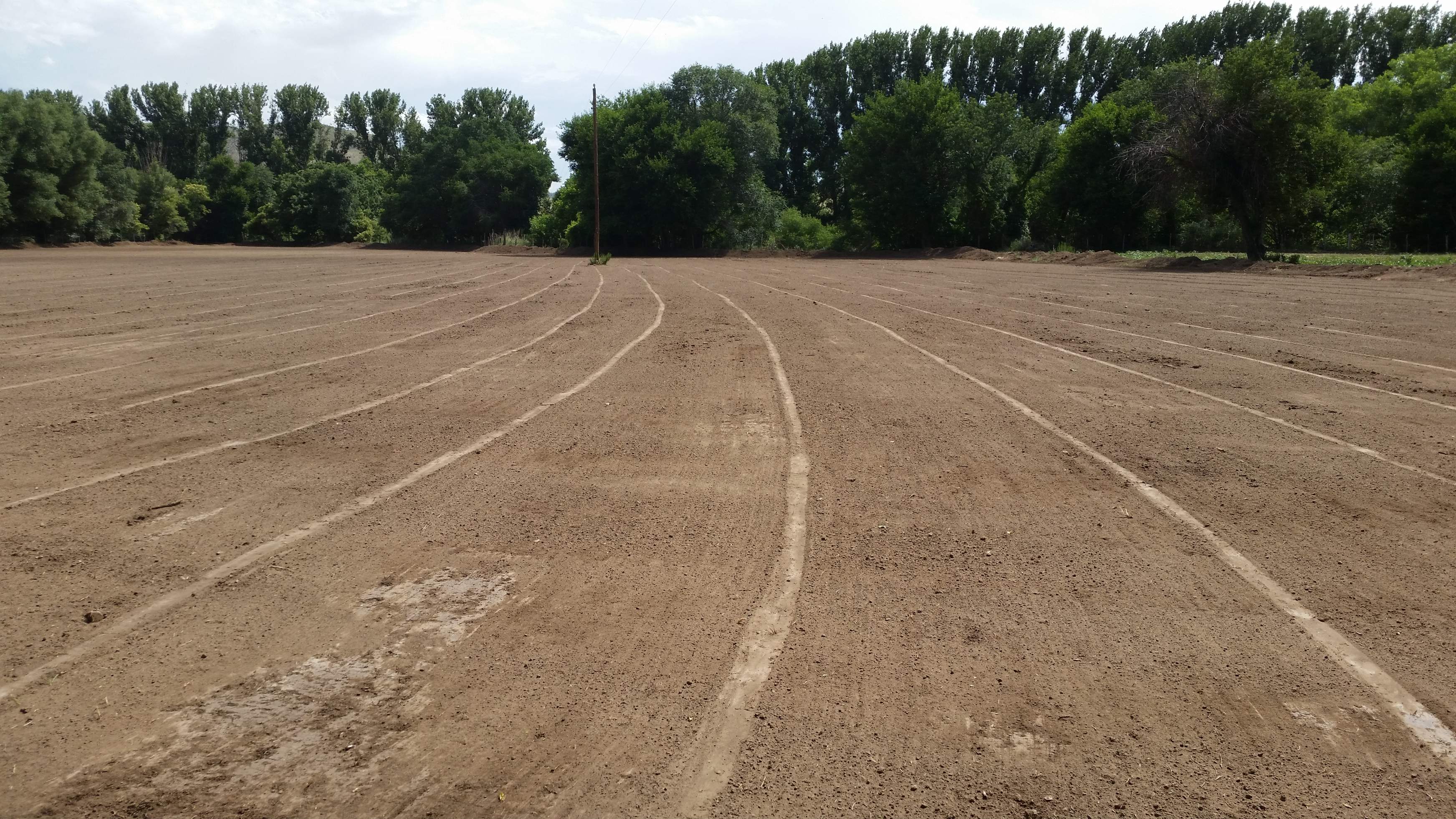

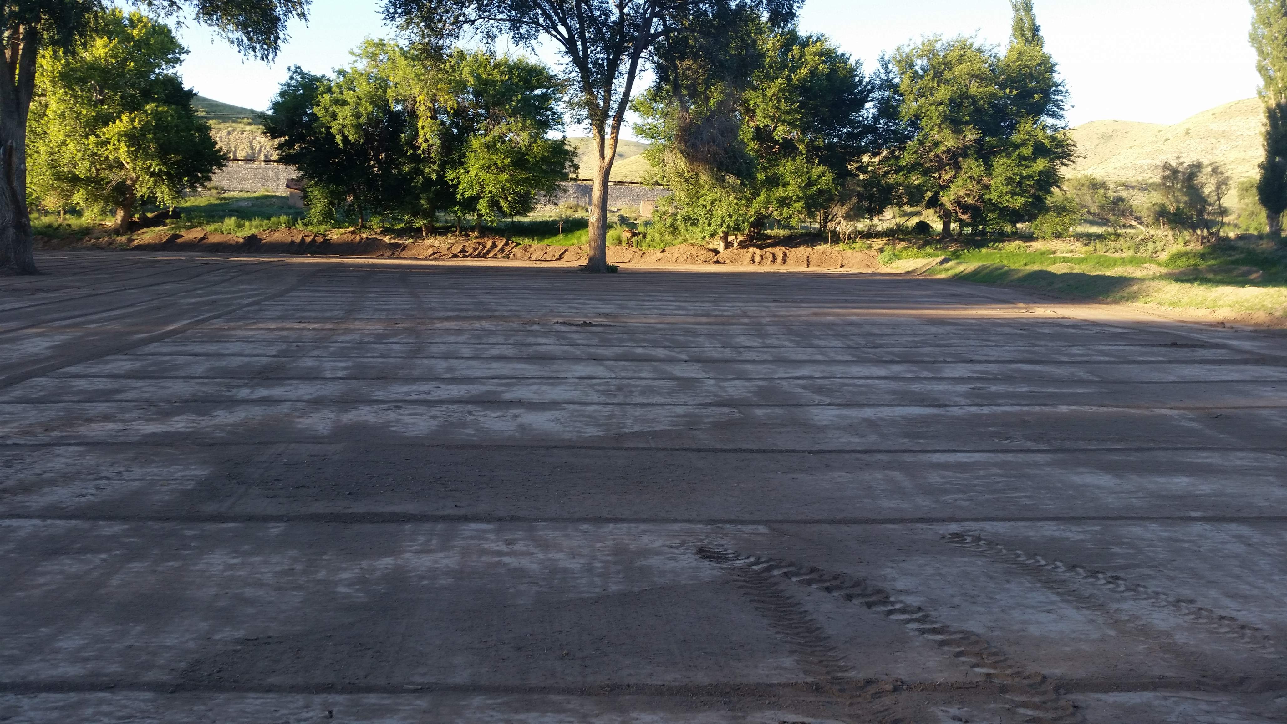

I find that my box blade leaves waves in the surface where as on the other than my land plane does a much better job with little effort than I can do with the box blade. I do driveways and pads. I have used the land plane to do the finish grading for the concrete contractor inside the forms. I have use a landscape rake and box blade. Land plane is my choice for a smooth surface. It will not move dirt like a box blade.
I use a heavy box blade and had similar issues with wavy surfaces. The thing that made the biggest difference was seat time. With enough time and practice waves are not an issue anymore. When cutting or filling to grade a box blade is much easier to control than a lpgs. That is why I use it to level work. A lpgs is better for smoothing and averaging out depressions and or mounds and leaves a flat finish. I make a distinction between level and flat/smooth.
The first picture is a small field leveled from left to right with a .250 % slope from background to foreground with a box blade.
The second picture is a field leveled with the box blade and then smoothed again with the lpgs.
