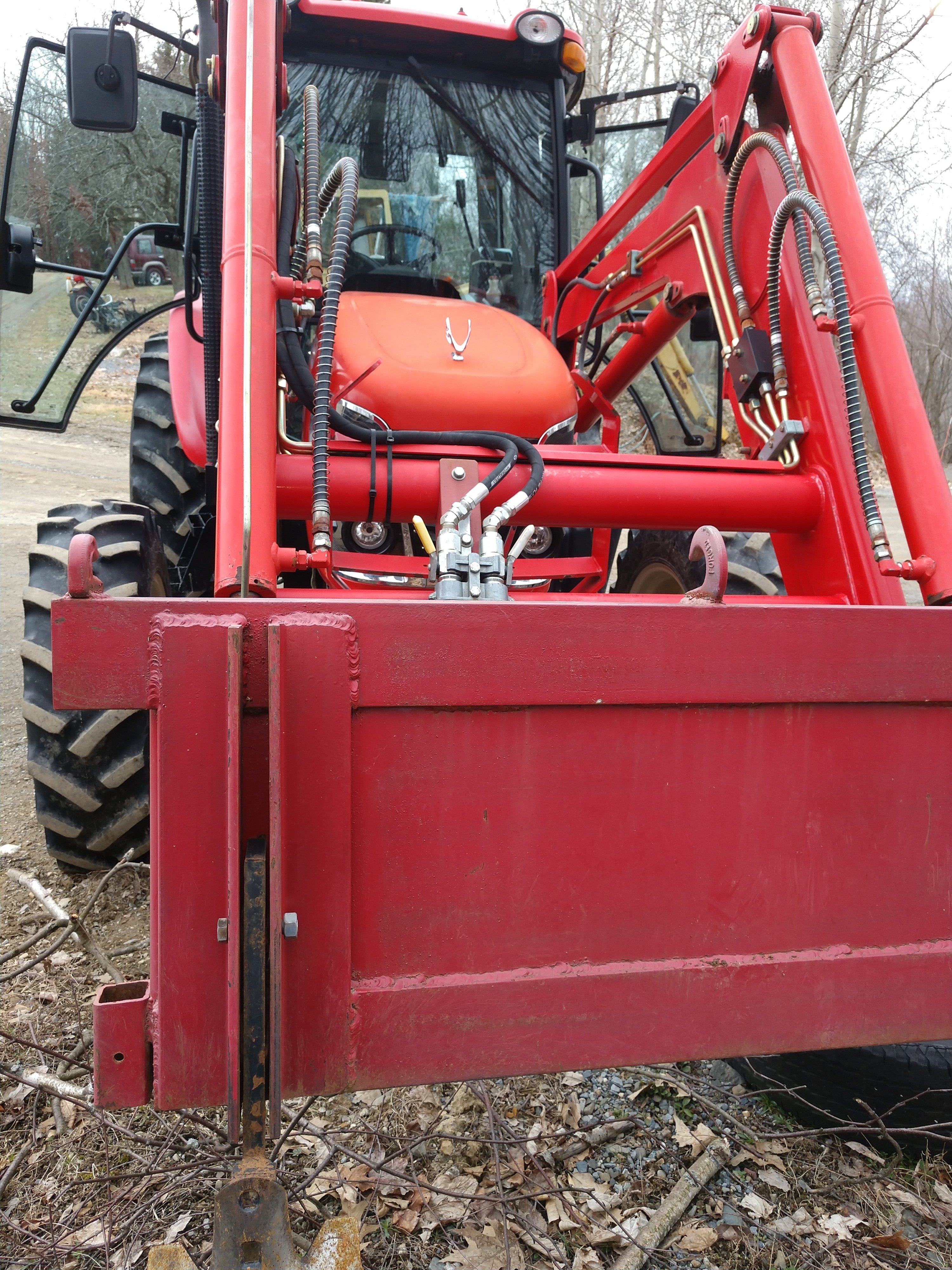

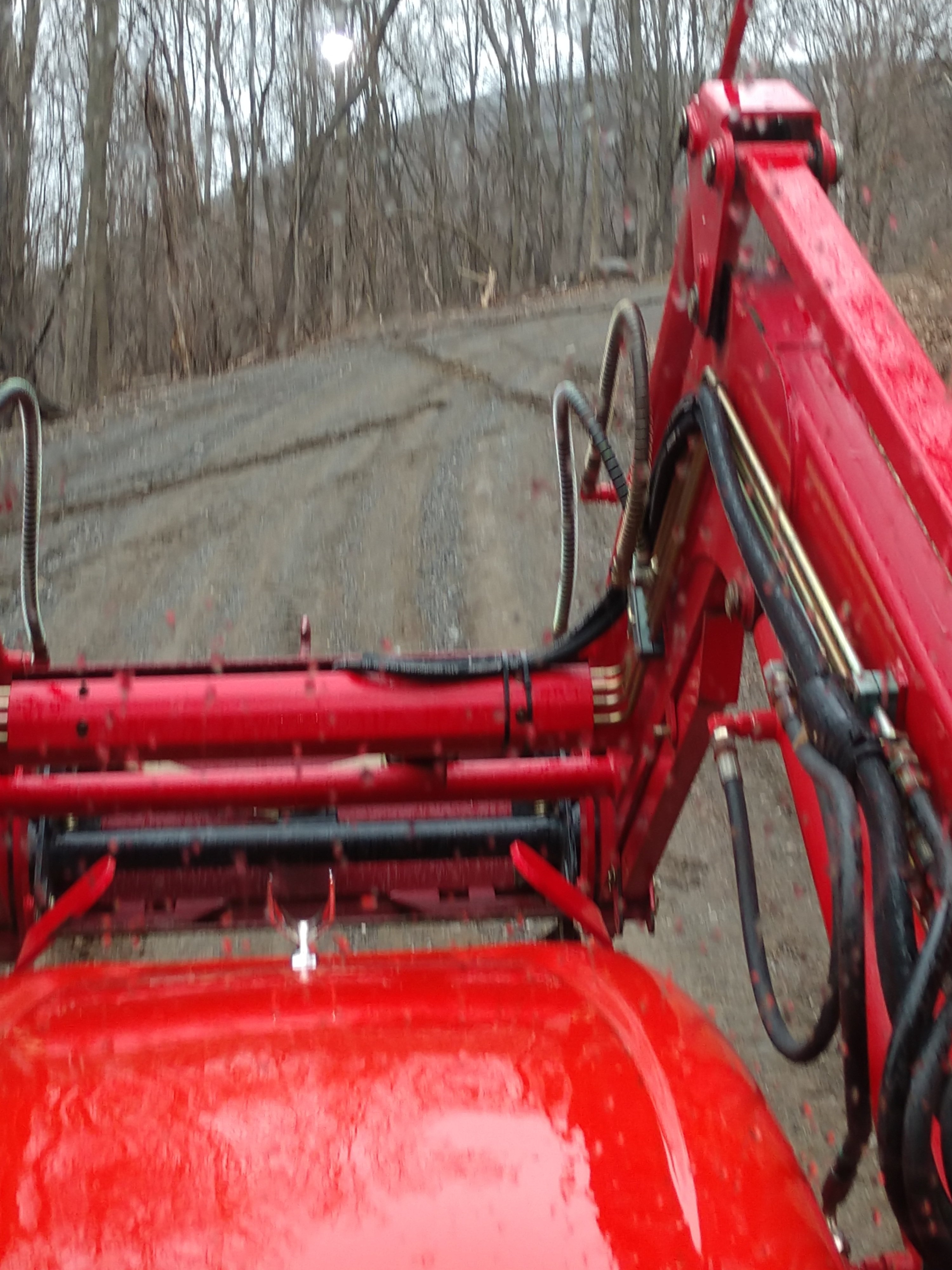

Ours is long and steep so I cut shallow channels at a 45 degree angle to the road that start around the middle and end in the drain ditch. It does slow down traffic (which is only us and our guests) but mostly it diverts run water coming down the road and prevents it from gaining momentum and flow.
That is exactly what I do.
With the steepness of most of my driveway, just the tractors weight is enough to cut the water cuts in my packed driveway. I often have the reverser in reverse and just the clutch depressed then brakes to keep her slow and easy.

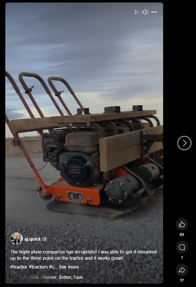

I can't seem to find it right now, but there is a Facebook group called "Homemade Attachments" (or something to that effect) and one of the recent posts was a guy who made a vibratory compactor attachment out of three small plate compactors that are fairly inexpensive compared to these large machines. He pulled the three small plate compactors behind his tractor and it seemed to do a fairly good job of compacting. If I find the post, I'll try to steal a pic and post it here.

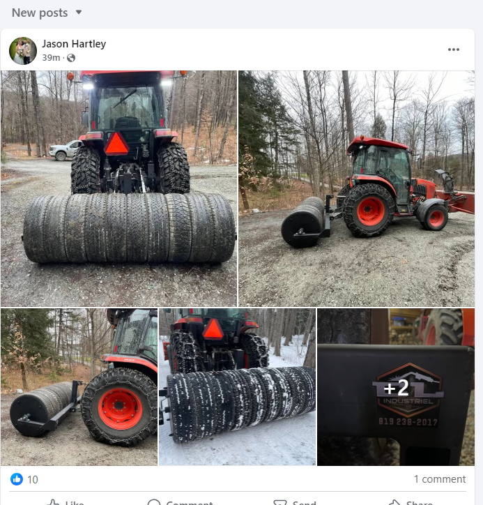

another idea with filled tires
