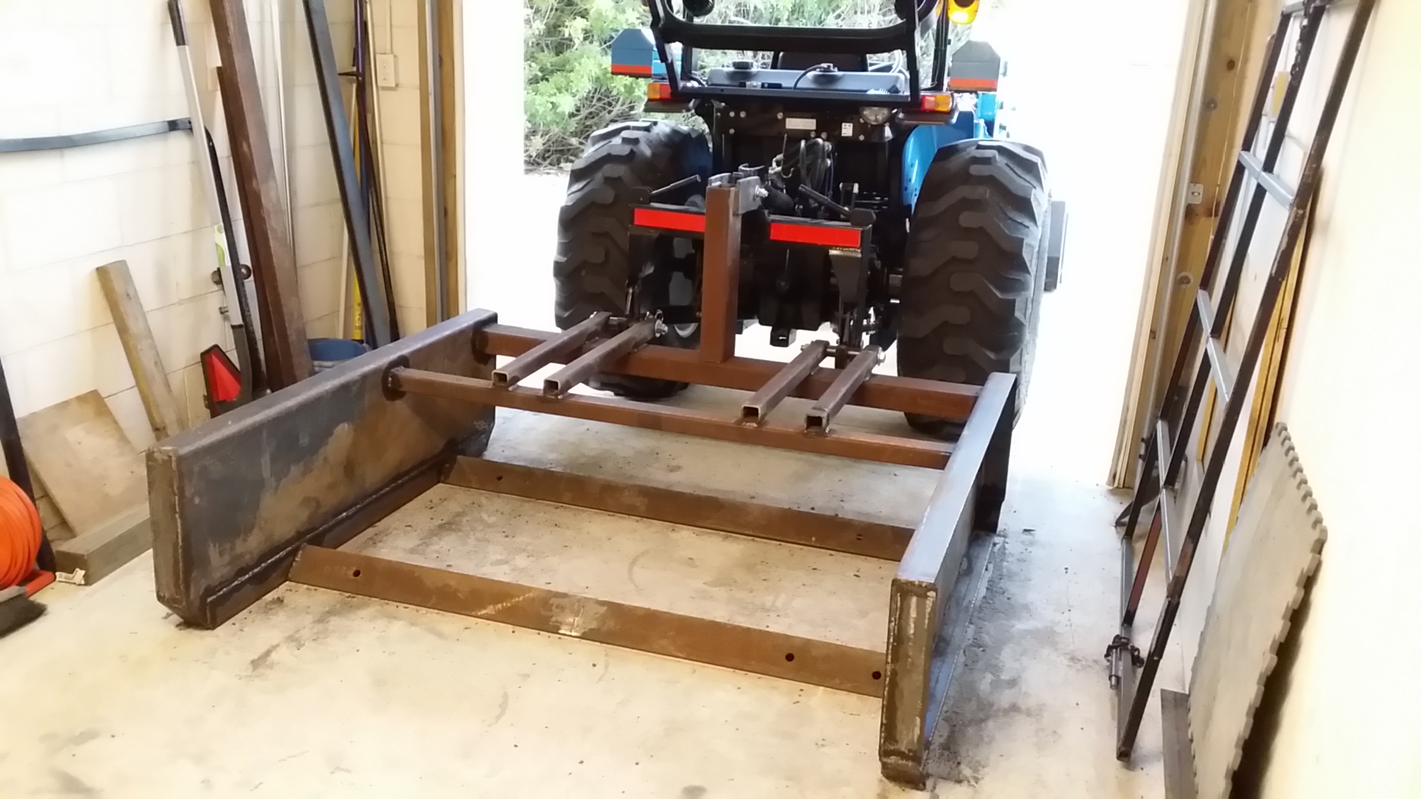

20150122_174752.jpg still have some bracing to do and runners on the bottom and blades.20150122_174814.jpg
   / Land plane blades straight or angled ? #23
Lookin good. I'm guessing that the bracing will include the post for the top link?
#24
Yes, it is just sitting there until I add top and side bracing and then it gets welded on. I may add a back also like Gordon did on his
design which is really nice.
#25
20150125_163229.jpg20150125_163324.jpg primed and ready to put the blades on then paint.
   / Land plane blades straight or angled ? #26
That looks good. You did a nice job on it :thumbsup:
Don't forget to report on how it works !!
   / Land plane blades straight or angled ? #27
Wow - that is a nice looking implement. Great job. Be sure to tell us how it works.
