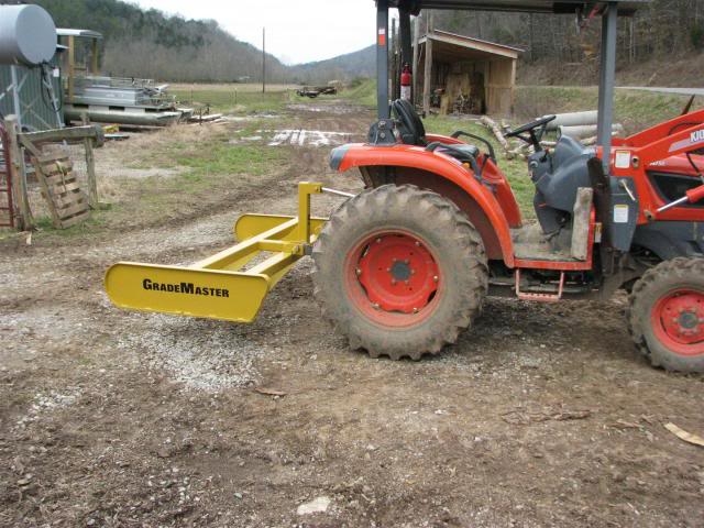

Years ago I bought a Grade master U7, 7' with the 2 angled blades. I was thinking wider and heavier would be better and it does work amazingly well. Looking back, I think a 4 or 5' would have been better to maintain the crown since most driveways are only 8 to 10' in width. All in all it has been a great investment.

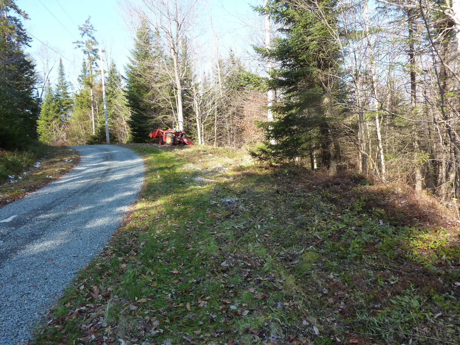

Very true Gordon. My flat driveway does have a valley. Right in the middle. Steep entrance - 150 feet across - steep out. I've never had problem with the LPGS in the summer - in the valley.
Winter is a totally different story. Fields melt and the water can run down the road on the east side of the valley. This will eventually freeze and make for some wildly exciting times plowing snow. Ditching will help but the ditch silts up and the neighbors cows love to play in this wet area. The drainage ditch will eventually freeze up - water will still run and come down the driveway.
My answer. Always plow snow DOWN into the valley on the east side. It takes longer to do it this way. However - I'm not likely to slide off the road and roll to the bottom of the valley. The driveway across the valley is built up. Go off the driveway in the valley - it's 20 feet, down to the floor of the valley.
I only have a 30 foot wide easement from the county road to my property ( one mile ). I didn't bring enough gold when we came down from Alaska to build a bridge across this valley.

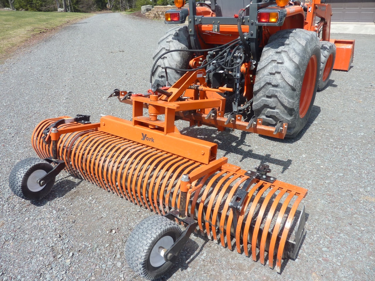

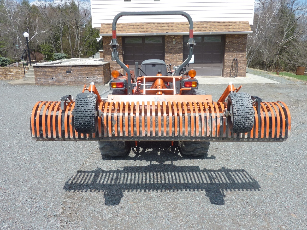

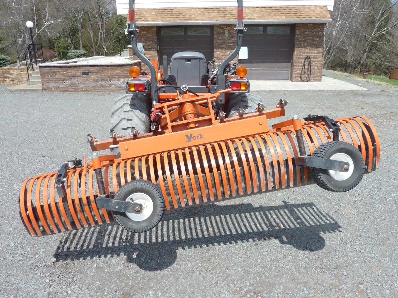

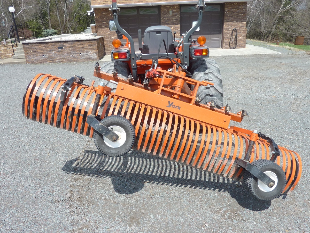

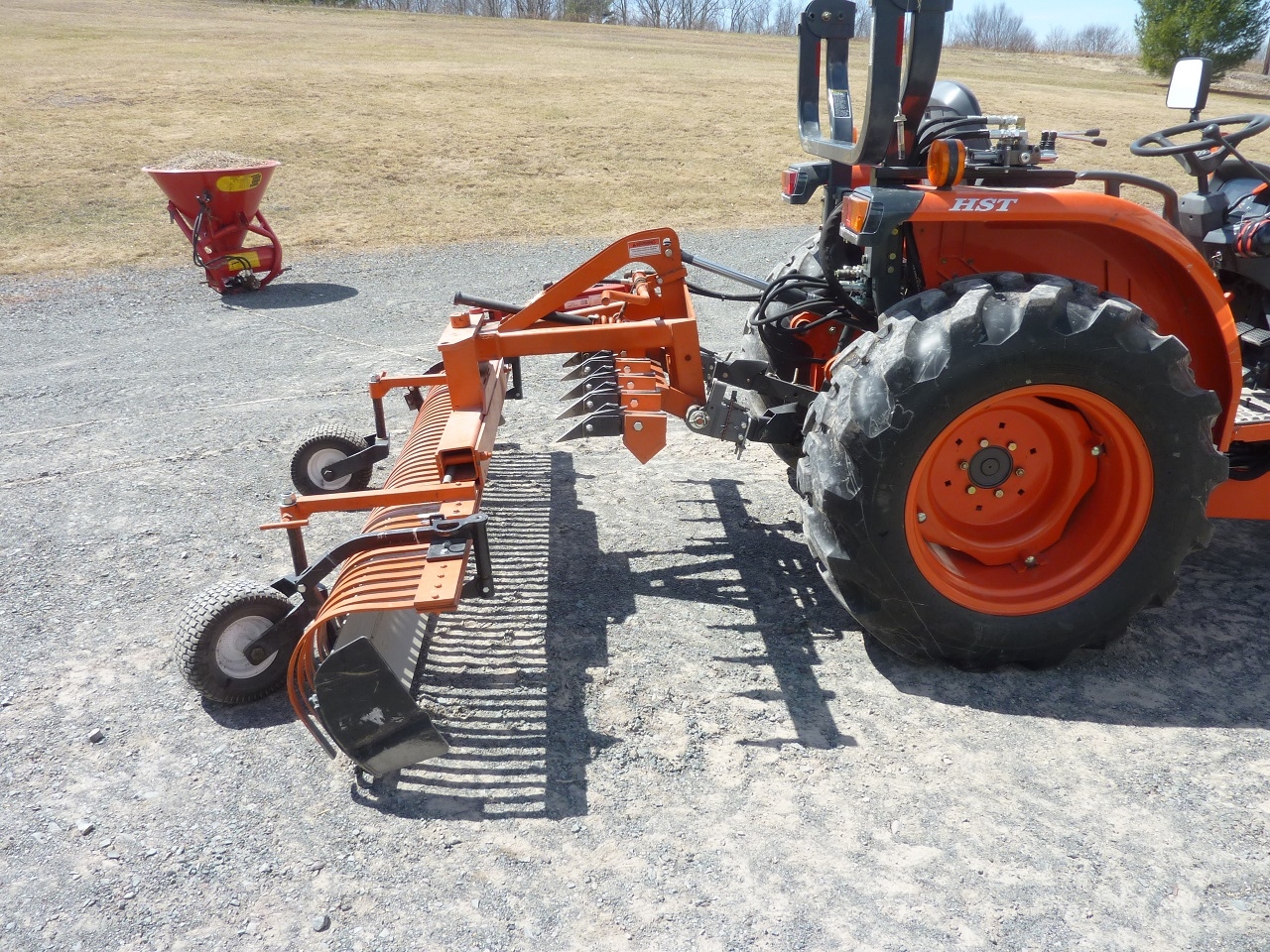

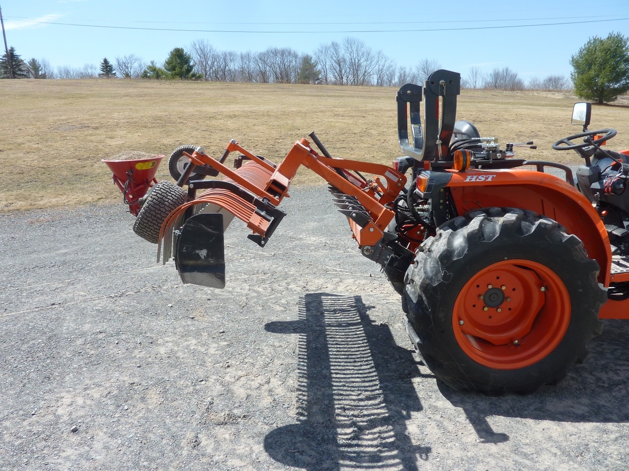

I used a 72" landplane for several years behind my old Kubota L3010 to maintain my 1.25 mile private gravel road. The 30HP tractor had no trouble pulling it, but due to the numerous grade changes, I had difficulty adjusting it so it wouldn't move more material than was necessary. I eventually sold it and bought an 8' York rake with scarifier, flip up grader blade and gauge wheels.
I found the rake to be much more versatile in it's ability to control the quantity of material, crown, cut & clean ditches and rake material back into the road after Winter plowing.
One thing you can do with the rake is to raise the grader blade, set the gauge wheels and use the tines with the tractor in high gear. A couple of passes and the roadway is smooth and dead level with no material ridges left on the sides.
For large grading projects on roads with a fairly even contour, a landplane may be more efficient but for doing routine maintenance, I find the rake to be much quicker.

Actually, I added the T&T kit after I sold the landplane. Yes, it likely would have helped. I probably should have kept the LP but I needed cash to buy the rake.
I still like the rake for leveling the material ridges left on the road edges and raking plowed off material back onto the road surface. Yes, the LP would do that as well but it drags grass & dirt in the process. The rake tines leave most of that behind and just move the gravel. The LP is also tough to use when creating & cleaning ditches.
Both implements have their advantages, and it would be nice to have both, but for the work I do, the rake is the most versatile.
