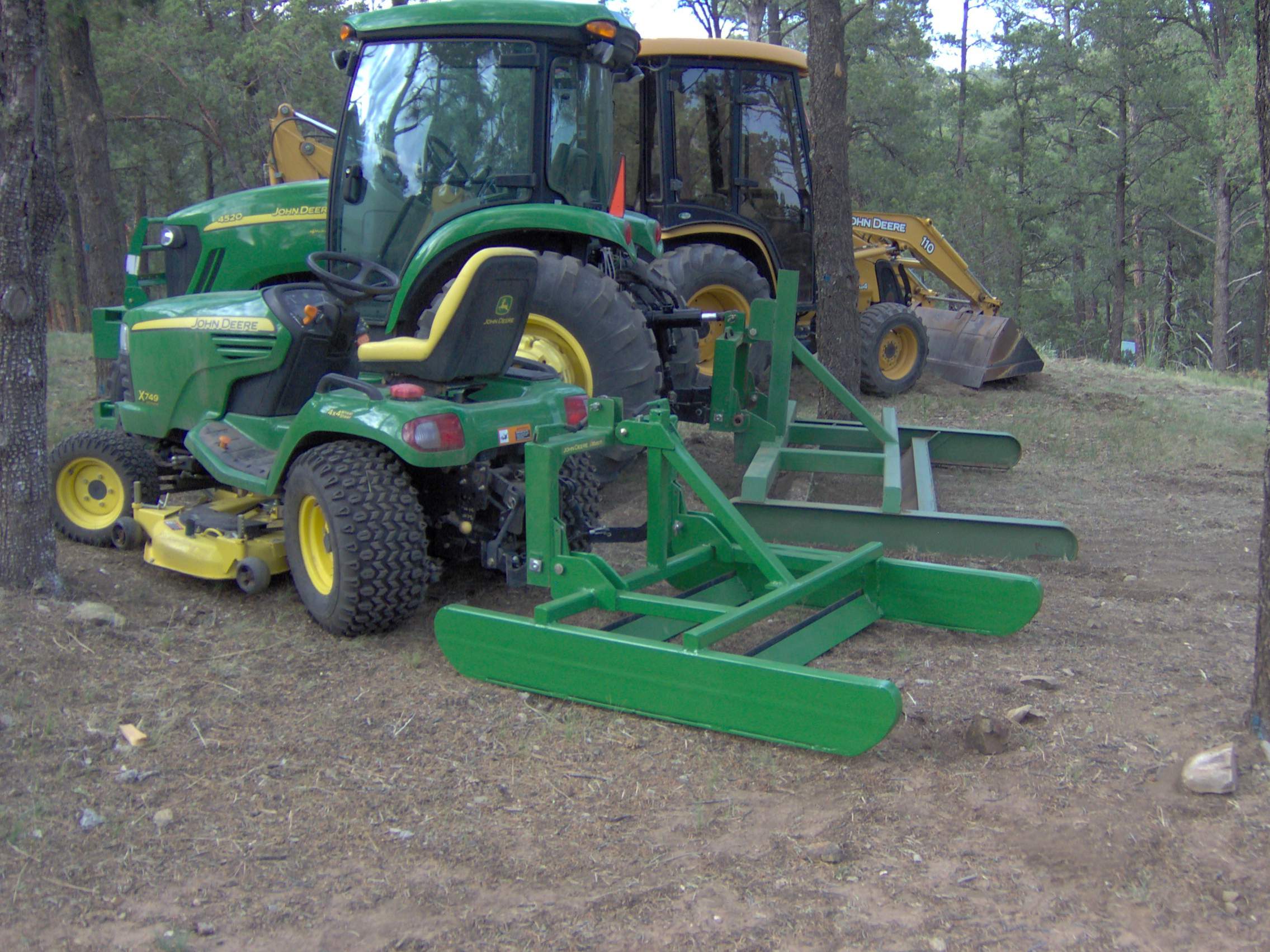

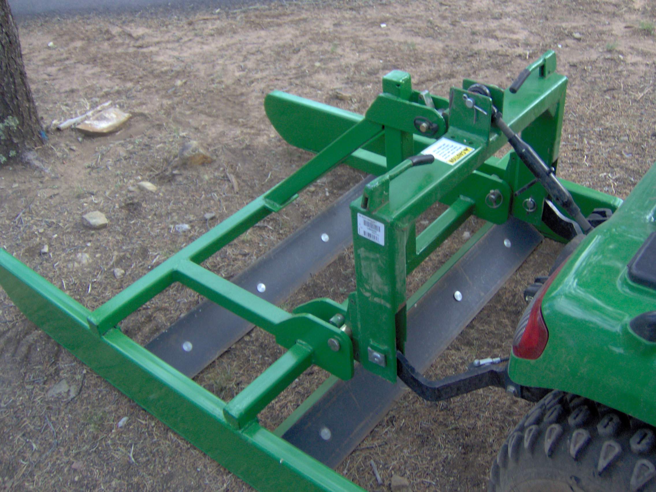

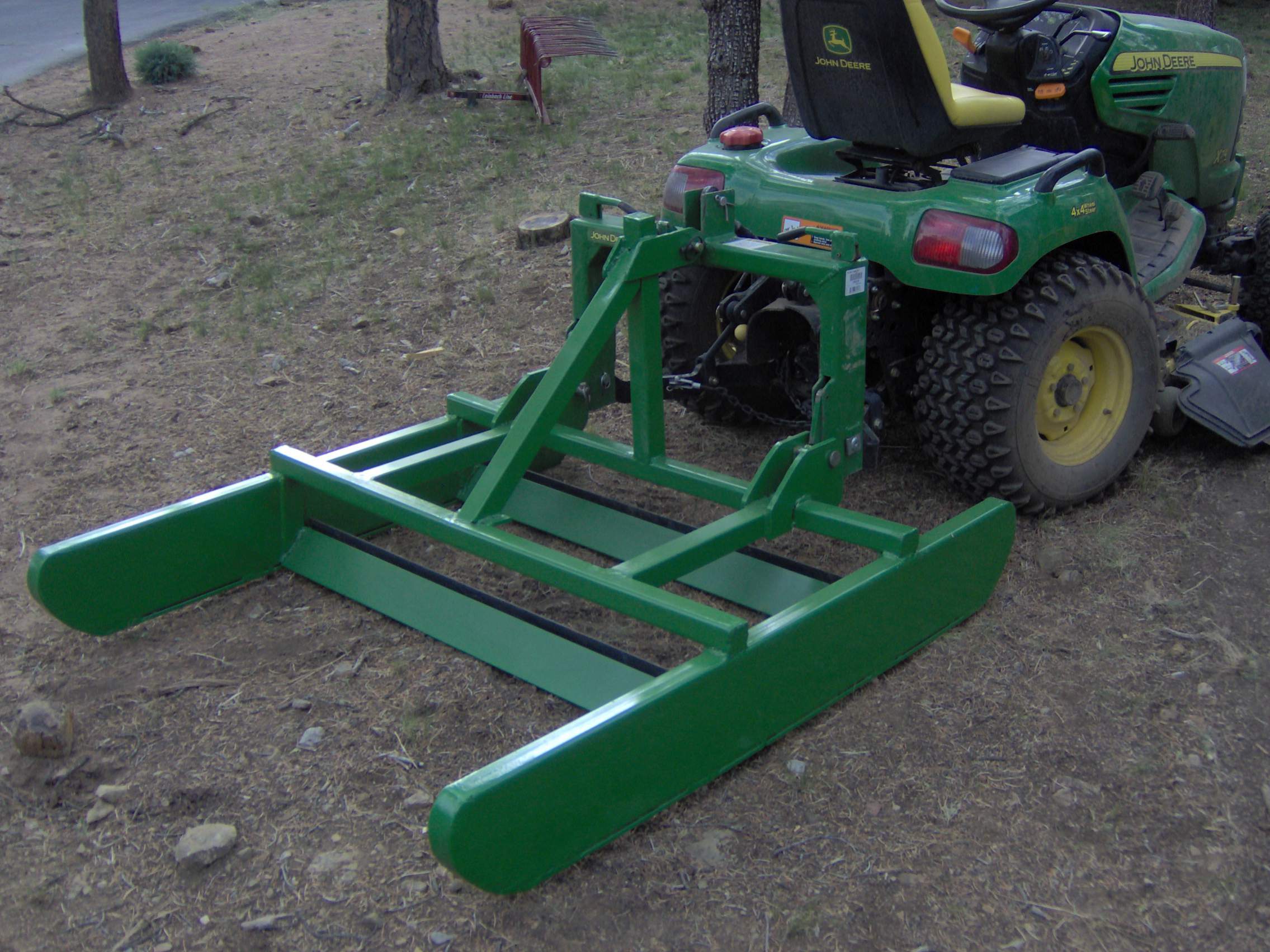

Here are pictures of a 48" land plane grader scraper I built for my garden tractor.

VERY nice work, you should go in business making them. Looks great.
   / Land Plane / Land Leveler to smooth out lawn??? #24
Thanks guys,
I suspect this size is ideal for most subcuts. The skids are 5' long so it can get similar results to a much larger lpgs. This is an easy build if you have some welding equipment. Cost $200 for a good 8' grader blade and the rest of the material was purchased out of scrap piles for about $70. Total materials were $300. My labor is cheap.
Have used it a few times smoothing the sides of old borders (terrace rows) behind my 4520. Did an excellent job with that too.
