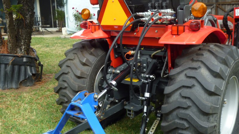

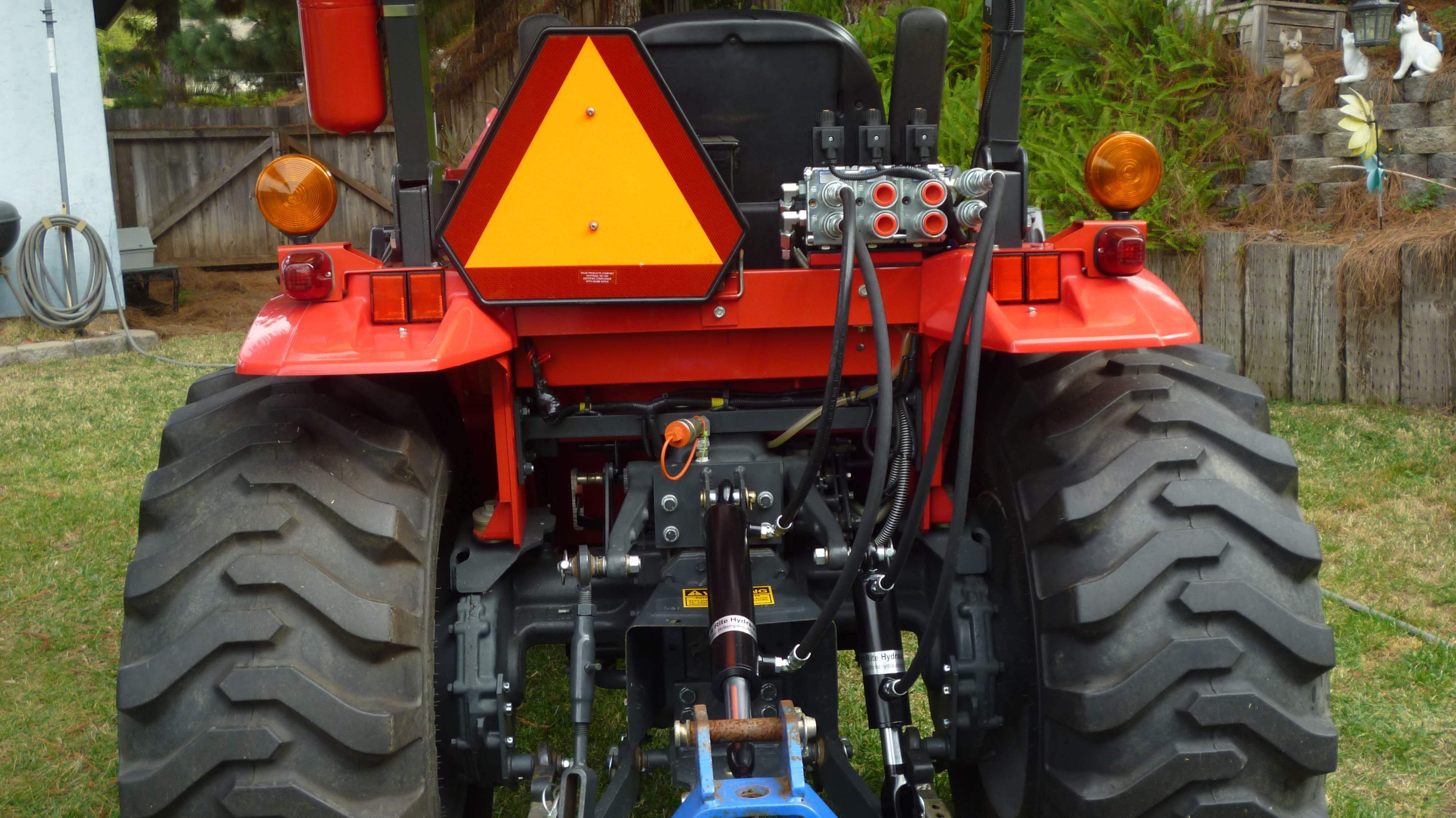

Just an opinion...but if the areas you wish to maintain are not really flat...regardless of the implement (bb/lp etc)...hydraulic top and tilt will greatly increase the efficiency and lower the learning curve of any grading etc. type attachment...
Good Luck...
   / Land Plane or Box Blade #15
Just so it is clear for the OP about what a top & tilt set is. They are the hydraulic links that you see on the 3pt hitch. Normally the center top link and the right side side link. ;)

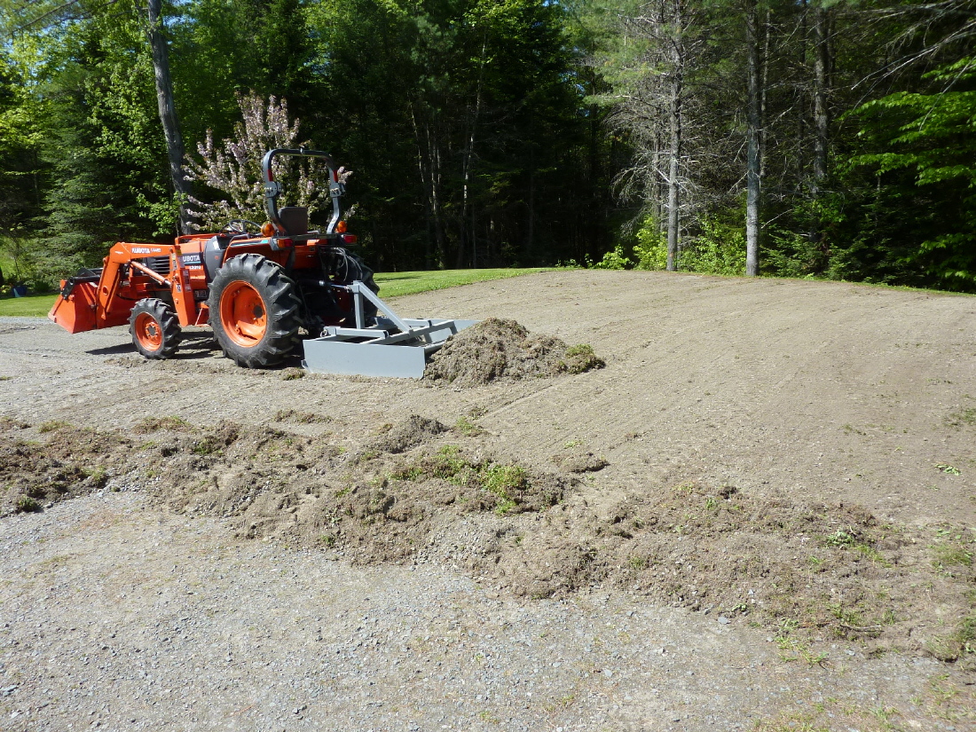

Your sod may be heavier and thicker than mine and require the ripper shanks but just for reference you can see that my LP/GS does a pretty fair job removing sod from my gravel parking area and road w/o any rippers. So you should have no problem I would think with a unit with rippers.
I agree with \pine on the hydraulic top link and side link (Top and Tilt). They will help tremendously with type blade you put on to do dirt work.
