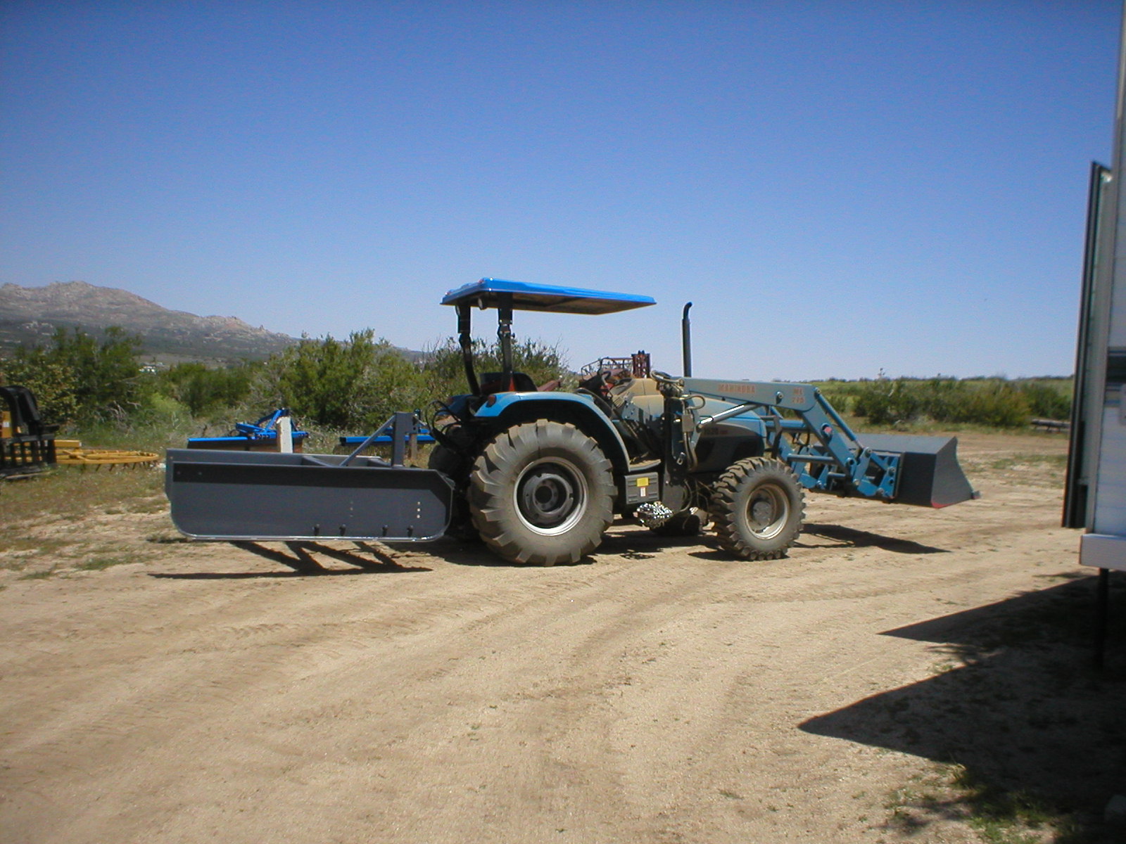

Lauren, lots of variables to consider. Here is an example, I have a 75hp 12,000lb machine that I use a 1400lb 7' wide industrial grade grader blade behind. If I'm lazy and or not paying attention that blade will stop my tractor cold. (or hot :laughing:) We almost always recommend that weight is your friend when it comes to grading and if some of that weight is actually in the construction of the implement itself, so much the better. :thumbsup: If you are a conscientious grader, then a 1000lb 7 footer would probably work out well for you. but if you want to just drop the implement and drive with little to know operator input, then you will need to get a lighter weight implement and go over stuff a few more times.
Just IMO. ;)
