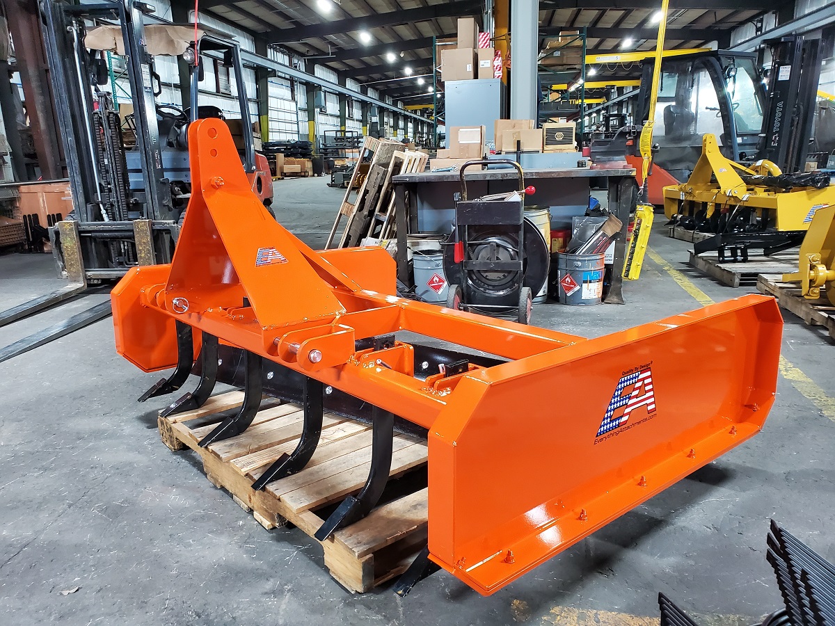

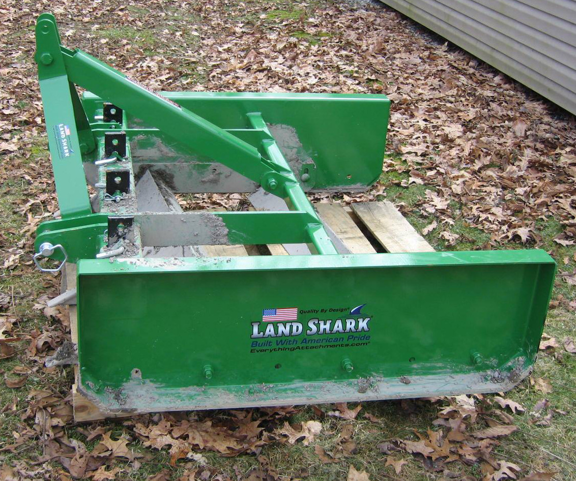

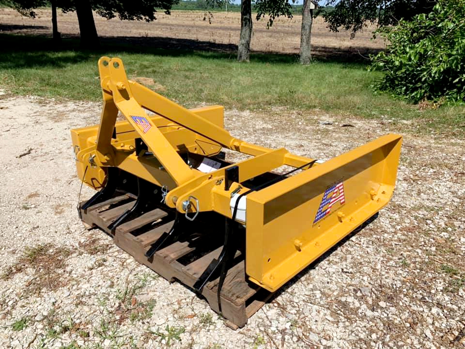

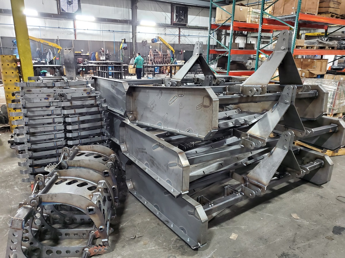

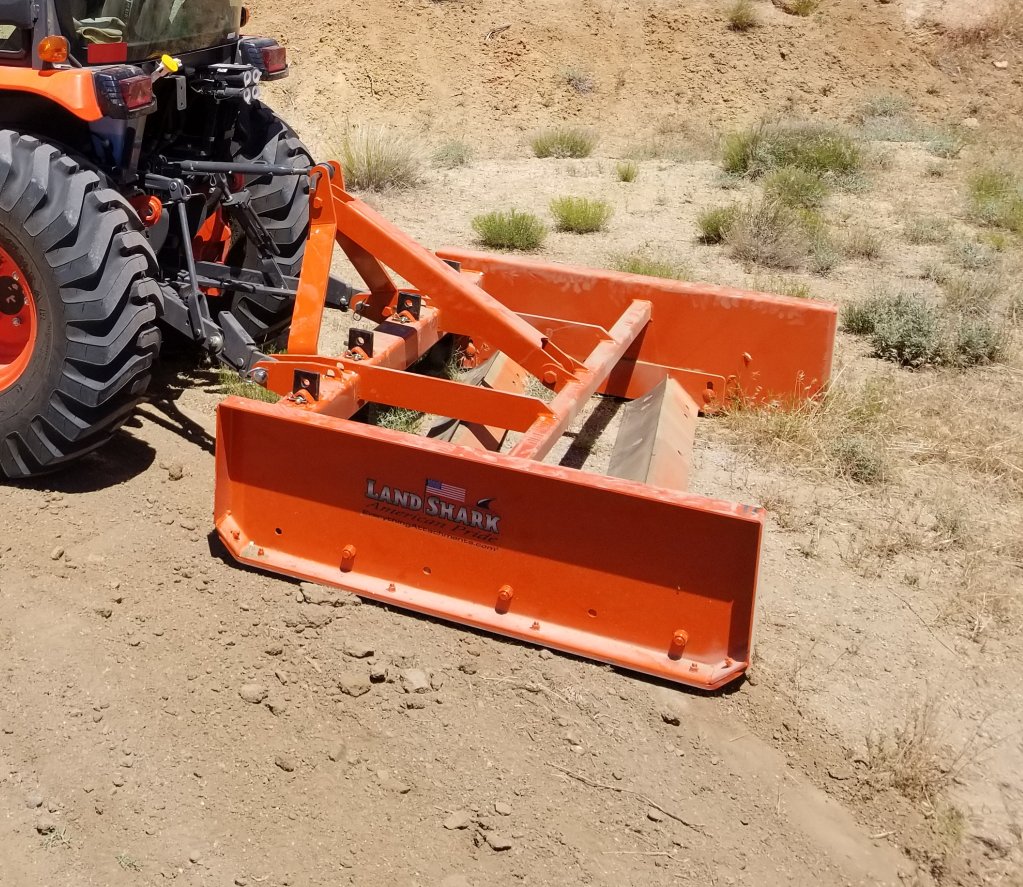

Land Planes are simply magical, according to much feedback I've heard over the years. It's hard to believe something so easy to use can produce such professional results.
Here at Everything Attachments, we manufacture three different models, so you can choose the best one to fit your tractor(s), application and budget.
First is our Land Shark model for compact tractors, which comes standard with ripper shanks. It is available in 48", 60" and 72".
Check out the details, video and customer reviews here: Land Shark 5.1 Compact Land Leveler by EA
Travis

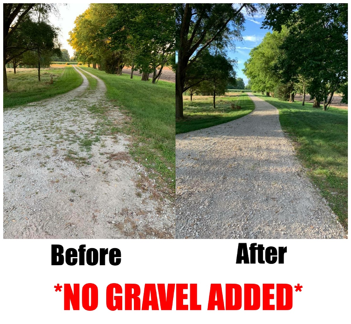

1/2 mile driveway with 300’ elevation change. Everything attachments land plane has made a world of difference. Agree yardbox is harder to learn to use effectively, but it can not do the job of a land plane. Same for a back blade. Land plane managing fines and redistributing base with minimum disturbance keeps the road hard and maintained longer. One trick pony but does the job well. Easy to crown or slope to maintain drainage. Appreciate the time saving and not buying gravel. Lots of complements the past couple of years. Blades and yardboxes have their place too...now their place is just sitting in the barn.
