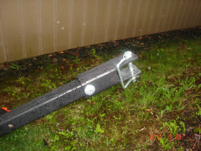

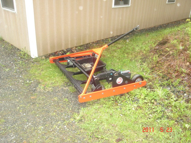

I've finally used the DR Power Grader!
After removing seven 4x8 trailerloads of brush (from our ice storm), I had the time to try it out yesterday. Had some issues with the "keyhole" hitch that drops over my trailer ball --found I couldn't back up very well-- I switched to the alternate pin-type attachment.
As my area is a bit cramped, I really needed to be able to back up reliably and accurately. The pin hitch solved this.

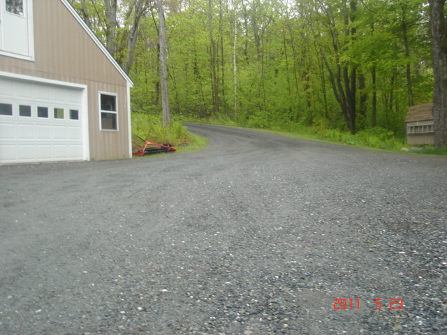

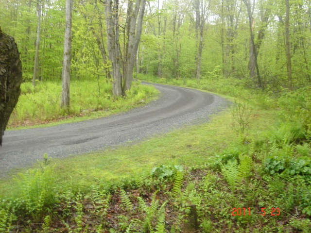

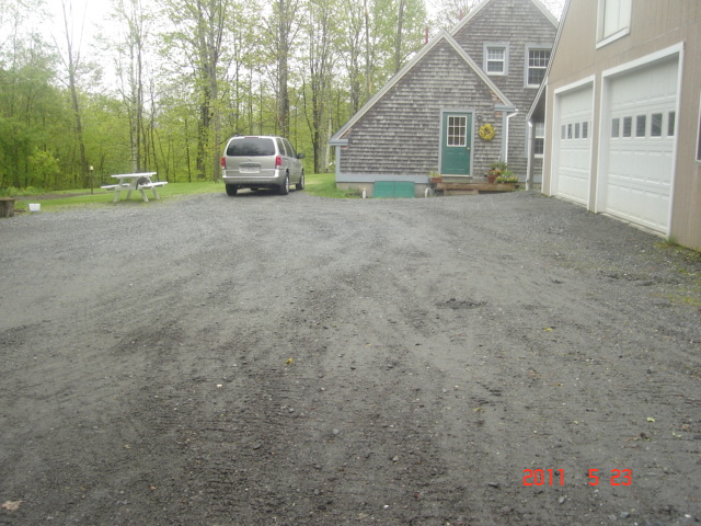

The driveway wasn't in terrible shape, but was beginning to get some ruts and several annoying high spots. The DR Power Grader handled it just fine, though I did use 4wd while going uphill on the steep part of the driveway.
It was able to dig down 2" or more without too much trouble, and the grading function worked quite well to level things out. It was also easily able to pop out the odd 5" stone. The remote height adjustment worked very well, if a bit slow... it was great to be able to "feather in" the grader at the beginning of a pass, then gradually raise it at the end; pretty slick; worked well. I also used my FEL in float as a back-dragger in a couple of spots; it and the DR grader worked well together.
Probably my GC2310 could have handled the Land Pride unit OK, but the DR grader seems to fit the bill for now. I only worked it for an hour or so --black flies are HORRIBLE this year!-- and will hit it some more later on. Right now, though, driveway looks a lot better!
