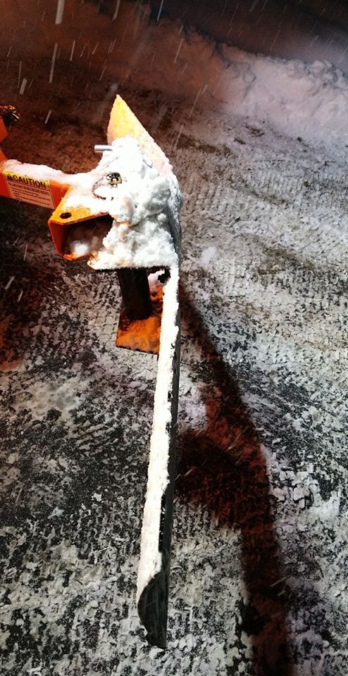

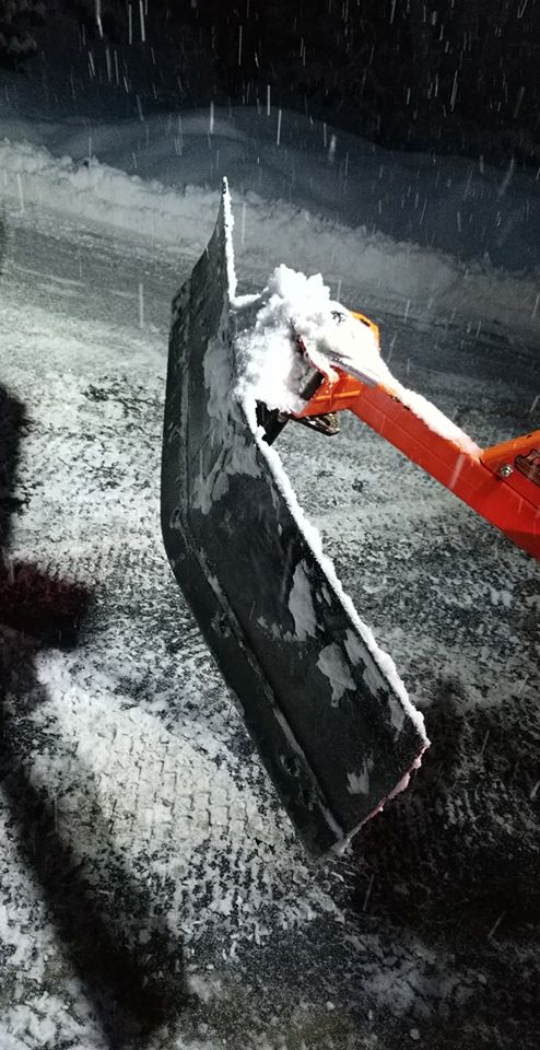

It may work for you, but just notice the lack of bracing behind the 05, 15, 16 and even 26 series Land Pride blades.
This one was on a BX...
An EA blade is in his future.
Travis

#9
I can't image what the guy hit with that blade to bend it. I had a 15-Series LP with my last B2620, and if I could have bent it due to poor reinforcement, I'd have MUCH bigger problems... like loss of fillings, whiplash, etc. I used to push frozen piles of snow iced over further back when I ran out of room late season. Seeing that blade bent... snow falling... seems someone just plain hit something hidden... hard.
   / Land Pride RB0560, or? #10
ANYTHING can be abused and destroyed. Without knowing the exact circumstances, all a person can say is WOW.
I bent my first rear blade backwards the very first time that I used it. This was a 680lb 8' Mid West product. A good mid quality implement. Problem is it was built for a 50hp 6000lb tractor, not a 75hp 10,000lb machine.
There are just to many un-known variables to condemn the implement. Based on personal experience and what I've read on various tractor forums, when things like these failures happen, it is almost always due to operator error of some sort.
