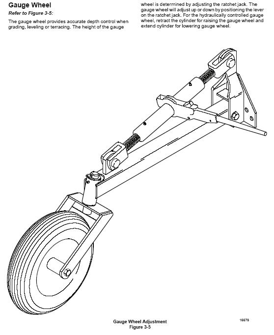

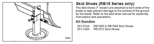

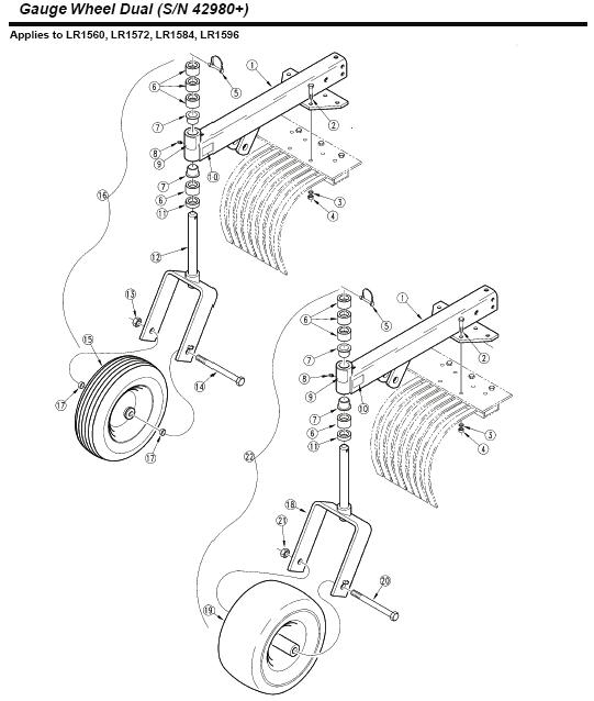

I have a LandPride LR with Gauge Wheels and they work very well. They are made well and function adequately. However, the gauge wheels setup on the LR is different from the single wheel on the RB.
Which LandPride RB do you have? I assume you have the 25 or 35 series since I don't think the gauge wheel is available on the 05 and 15 series. The 05 and 15 series offer skid shoes, which would be OK but not as useful as a gauge wheel. If you wanted, you could always purchase the LR gauge wheels and adapt them to your RB. I guess the single center gauge wheel would allow for tilt.
Pull the trigger, post pictures and let us know your thoughts.
