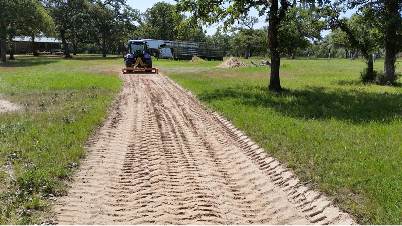

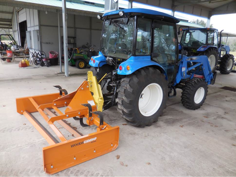

I bought the Woods 84" rear grader a few months ago and am very pleased with it. <img src="http://www.tractorbynet.com/forums/files/attachments/445818-land-pride-woods-befco-grading-image-2927308015-jpg"/> <img src="http://www.tractorbynet.com/forums/files/attachments/445819-land-pride-woods-befco-grading-image-3692886933-jpg"/> <img src="http://www.tractorbynet.com/forums/files/attachments/445820-land-pride-woods-befco-grading-image-2770720855-jpg"/> I've started a new 300 yard driveway, between workshops and our horse barn, which was just a grass path. This spring, during the hard rains, about 100 yards of it washed out and became a river pointed at the overhead door on our big workshop. I used the Woods grader and my new Landpride 96" rear blade to level out the road bed. Brought in two truck loads of crushed concrete for a base for the driveway and will get it packed down and then top with processed Post Oak rock. The Woods grader worked very we'll spread and level the crushed concrete. <img src="http://www.tractorbynet.com/forums/files/attachments/445821-land-pride-woods-befco-grading-image-3452205447-jpg"/> Whatever you end up buying, I suggest you get one with scarifiers. You will spend a bit more but, they really help. Sent from my iPad using TractorByNet
BYW, I installed a set of Brian's Fit-Rite Hydraulics top and side link cylinders,when I bought my LS XR4046 HC last year, which give you increased functionality with the grader blade.

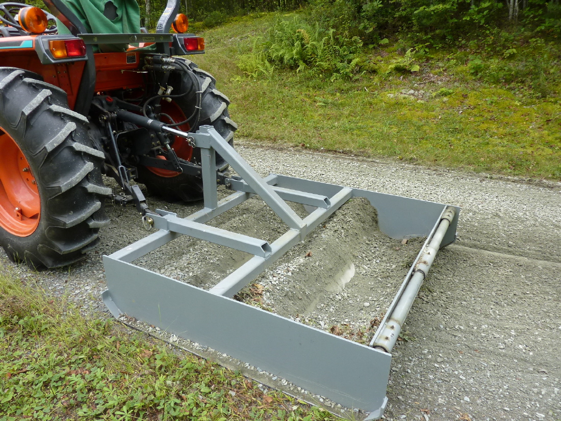

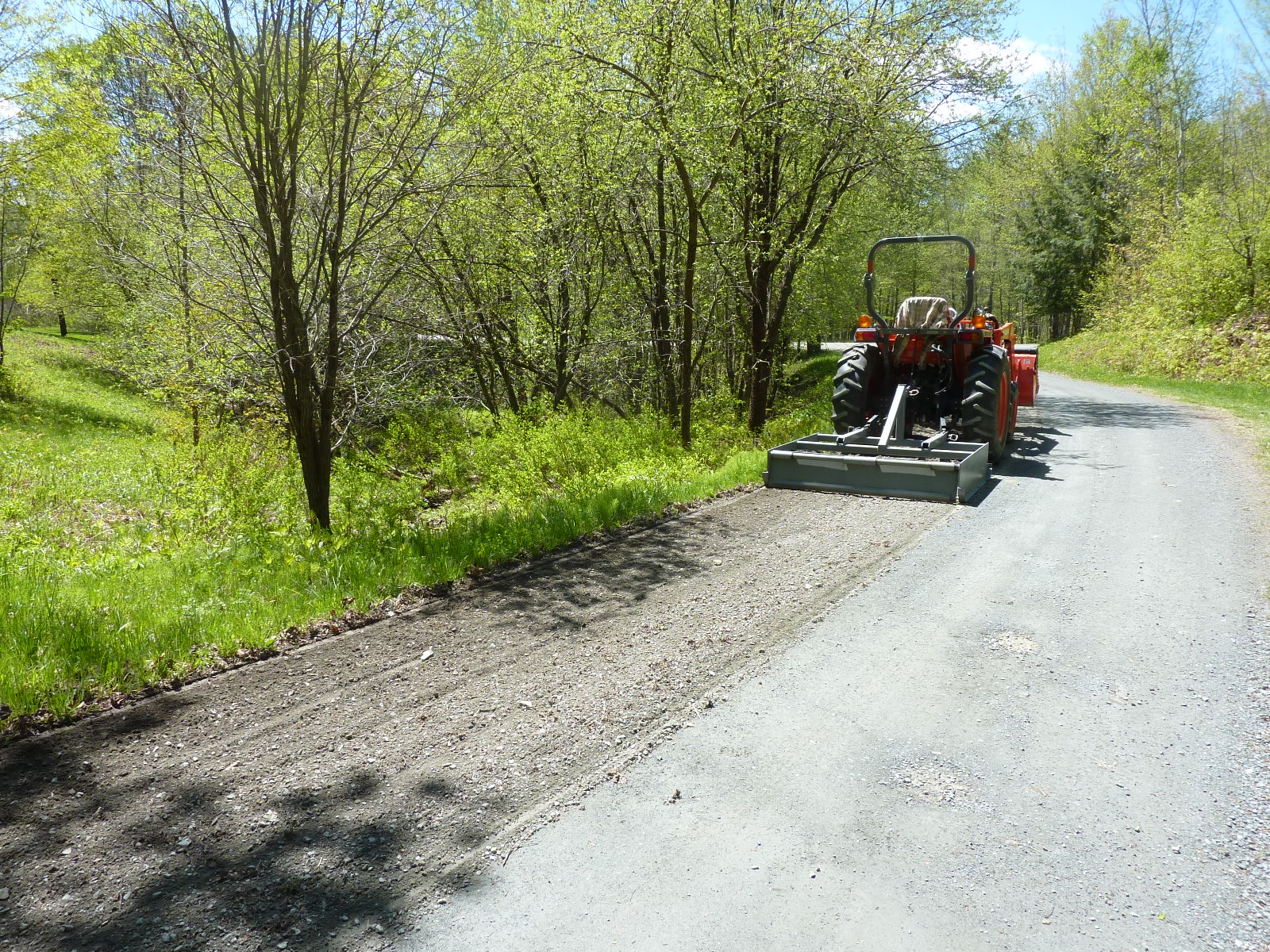

You can do I good job with a Land Plane Grading Scraper. From my experience I agree with Steve that adjustable blade height is does not seem all that important. My LPGS is 6 years old and sees a lot of use. My blades are straight across and fixed at 3/4" below the runners. Seems that there is a range of blade heights and angles that give good results. Here is the first pass on a packed pot holed road.
Here is how it cuts and fills.

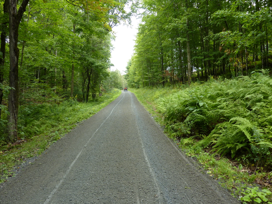

And some completed work.

What is that QH you have on there?
It's a Delta Hook QA System. A bit expensive but, works well with older equipment built to non-modern quick hitch standards.
