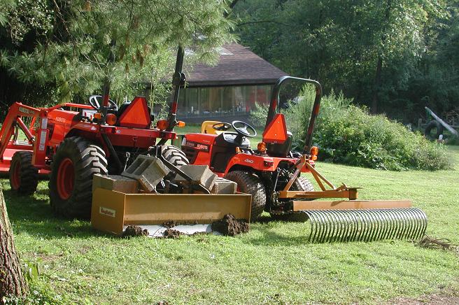

John,
Considering the expense of a good box blade, another option might be to buy a cheap KK box from TSC and try it out first. They can do a lot and give a very big bang for the buck. If you determined you needed more you could sell it to someone and not lose that much...
Attached is a shot of what I have. Not the greatest, but works pretty well for me. Well enough, that I may never need better...might put some gage wheels on the rake sometime though...
