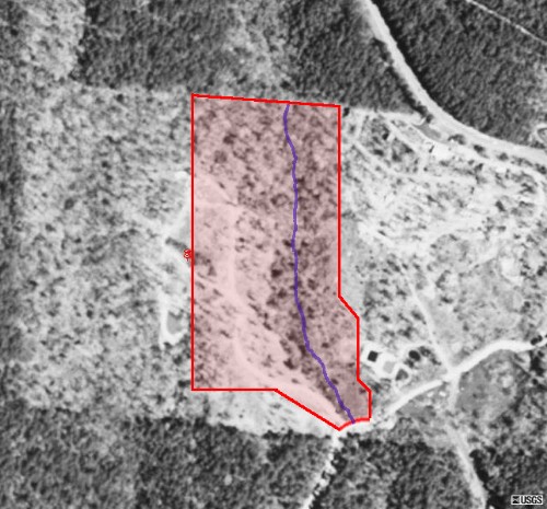

Here is picture of the USGS overhead of our land in Arkansas, which I overlayed with the approximate boundary lines from our sellers survey when we purchased the land. It's almost 16 acres. The blue line is an approximation of the creek. I could tell where most of the lines run on the ariel by some distinctive landmarks; a couple of ponds, and a cabin in the extreme northeast corner that I know is right on the property line.
I called the surveyor about a month ago asking him what he would charge to come out and walk it with me while I drove rebar pins on every corner, as right now, there are flags and orange tape up all over the place, but I cant distinguish any true property boundaries from these. He told he could send his crew out for $50 an hour. Maybe you could work out an hourly arrangement, if you already have a survey but just need help locating the lines.
