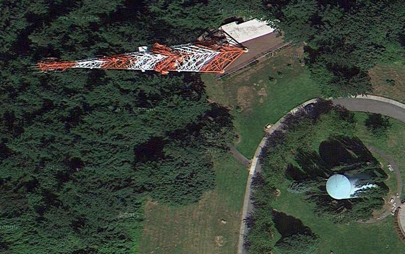

I think you will find that Google Earth is good down to maybe about 30 feet. Less that that, you are likely to find that you can't accurately replicate your coordinates from session to session. I have experienced differences of about 60 feet from one session to the next, keying off of a corner post each time.
   / Land Surveying Equipment Questions #16
And Google views are often not vertical, which complicates things, too.
This is with 45 degree view OFF
