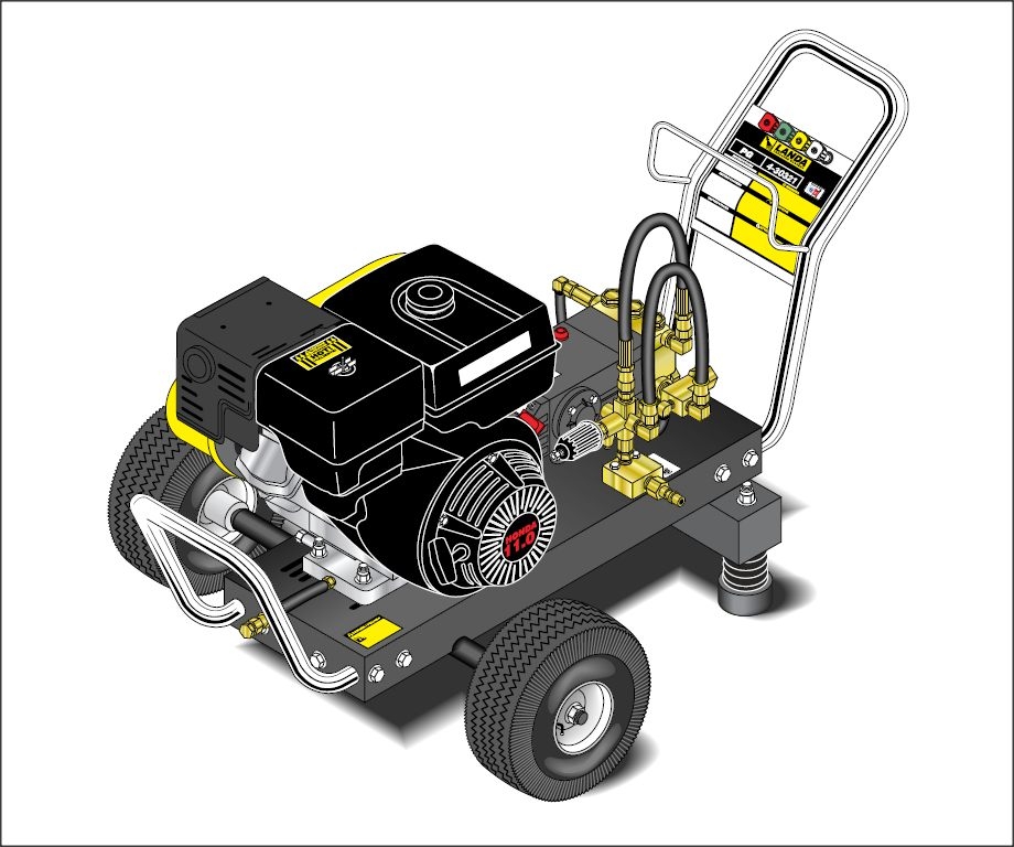

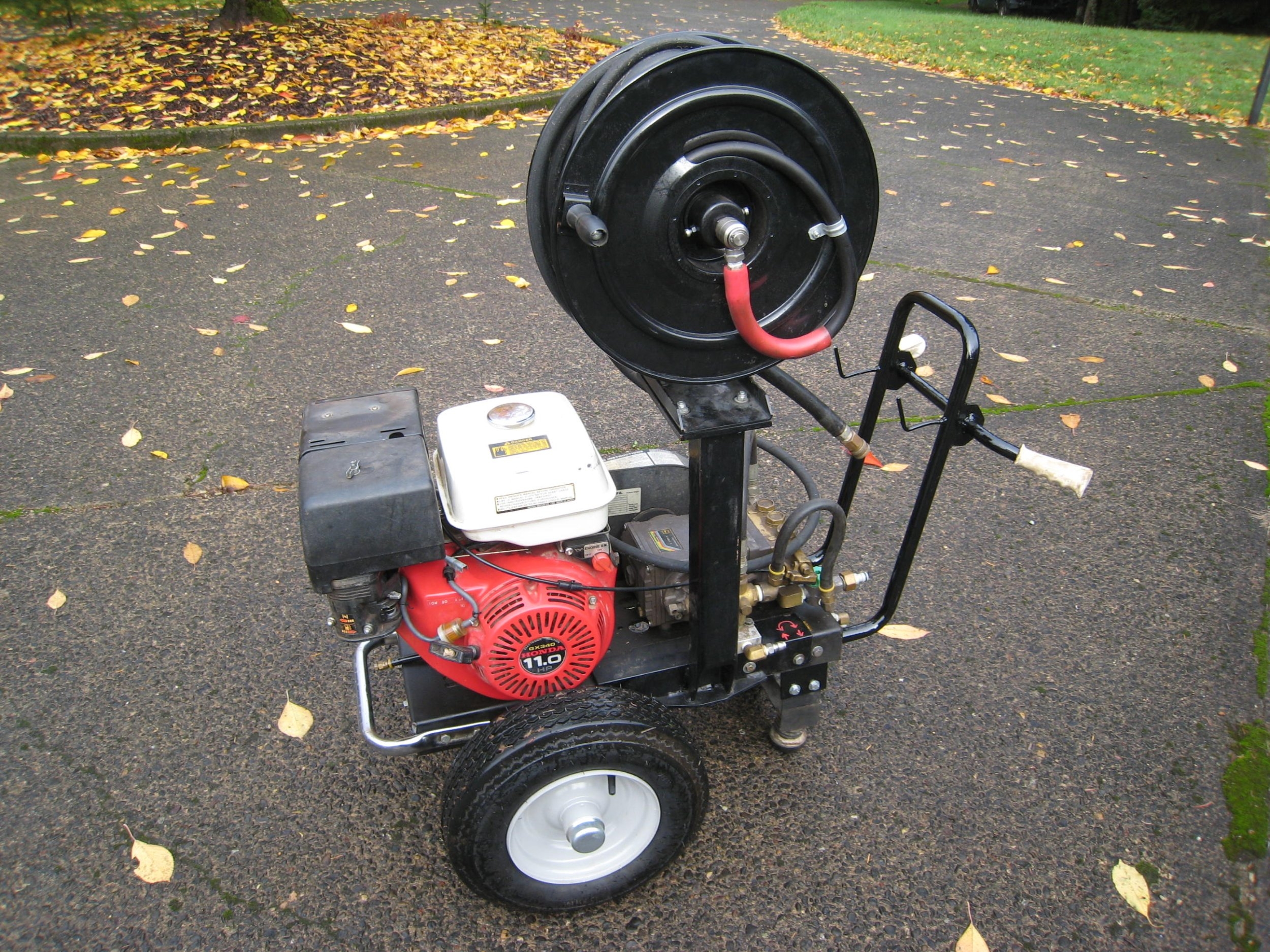

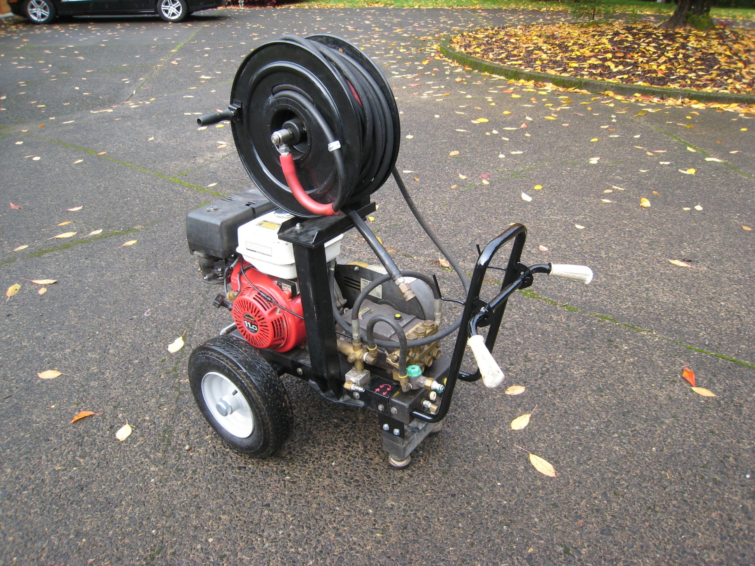

I bought a slightly used belt driven commercial pressure washer around 25 years ago and lived for many years with it's way too small wheels, lousy "handlebar" and no reel for the high pressure hose!
Made few modifications over the years and really like the way it works now, especially when sometimes pushing it on uneven grassy ground.
  • High pressure hose reel
  • New axle & log splitter wheels
  • Handlebar from an old exercise bike
This washer has unloader which drops the engine close to idle rpm when you release the wand "trigger".
Original:
Mods:

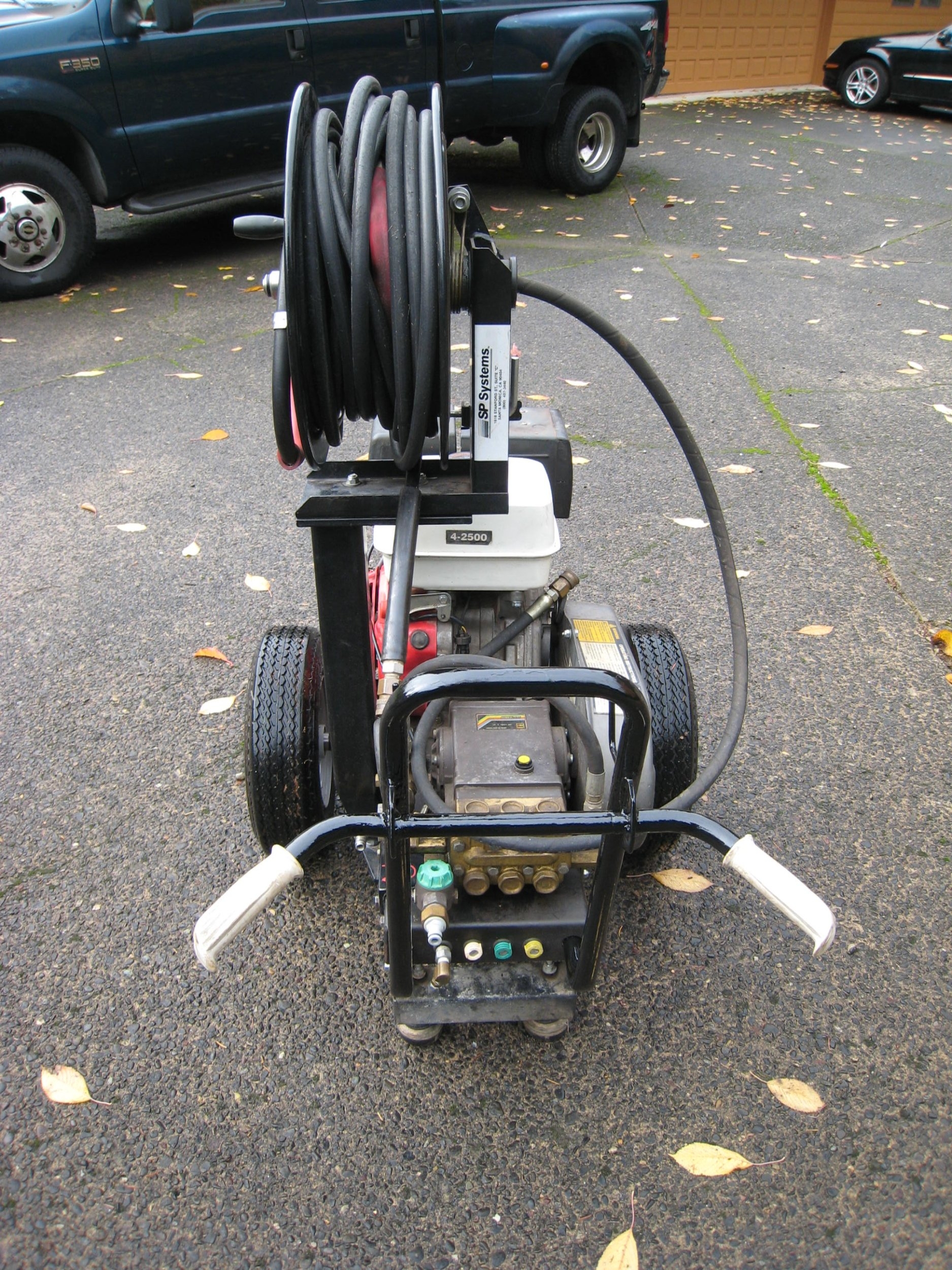

I like your hose reel. Much better than coiling up a wet dirty hose when the job is finished. Wish I had one on my sprayer.
   / Landa 4-2500 Pressure Washer Improvements
There is actually two long high pressure hoses on it!

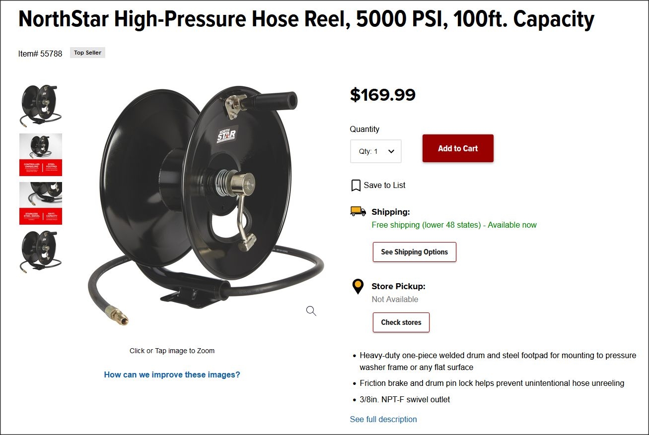

Arto.. What brand of reel did you buy?
It's SP Systems and I bought it long time ago, probably from Northern Tool (If you zoom in on the third photo you will see the logo).
Not sure if SP is still around, but looks like Northern has other options.
This may be the closest they have now:
