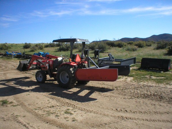

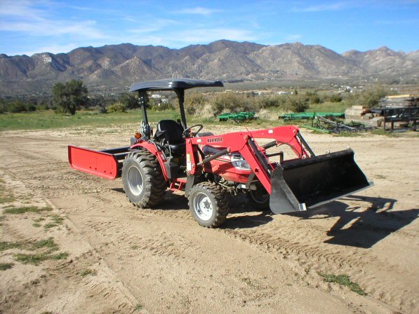

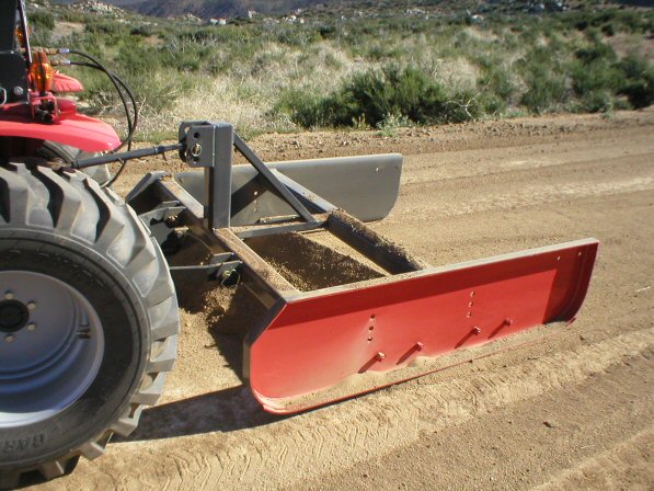

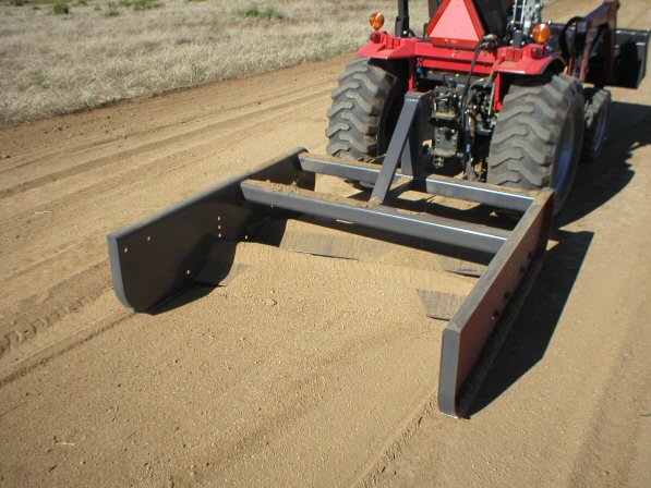

I have a 5000lb 32 HP turbo 4x4 HST tractor and pull a 5' wide 800lb LPGS. It works great. I would not want to pull a 6' wide unit that was as heavy, a lighter unit would probably be fine though, just would not work as well. Weight is king when it comes to grading.
With your elevation, you really need to find a tractor that has a turbo, other wise you will be loosing over 15% of your power with a naturally aspirated engine at your elevation.
What dealers do you have within a comfortable driving distance? Your $10K price jump sounds way off, should be $3-4K difference. Were you looking at economy 35hp models and deluxe cab 45hp units? :confused:
Let us know so that we can better help you. ;)

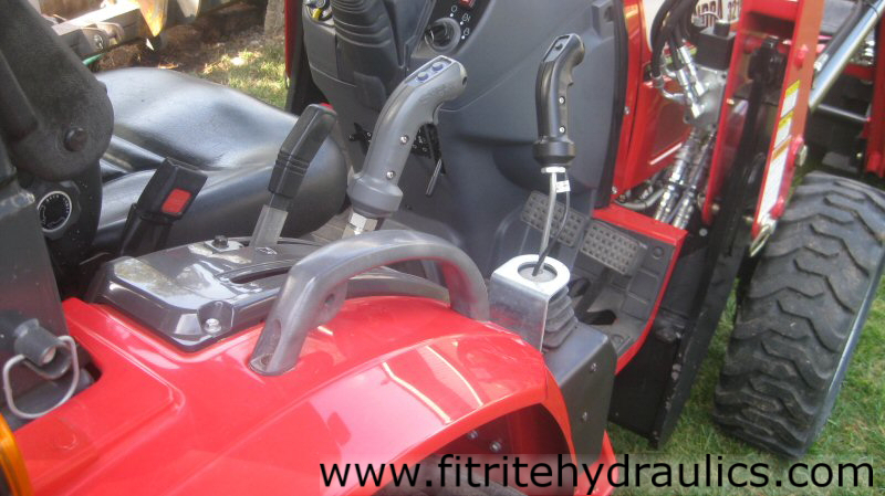

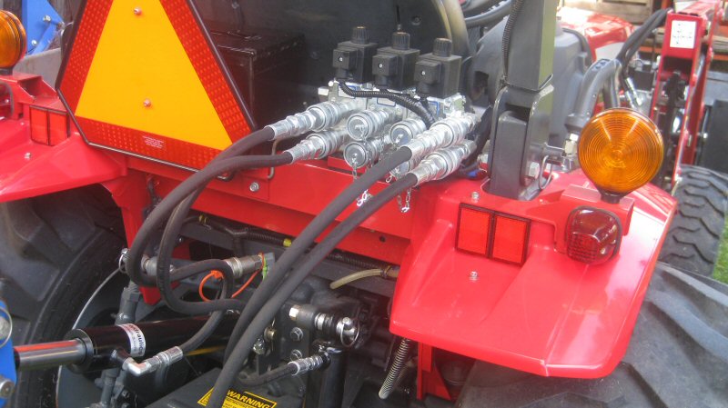

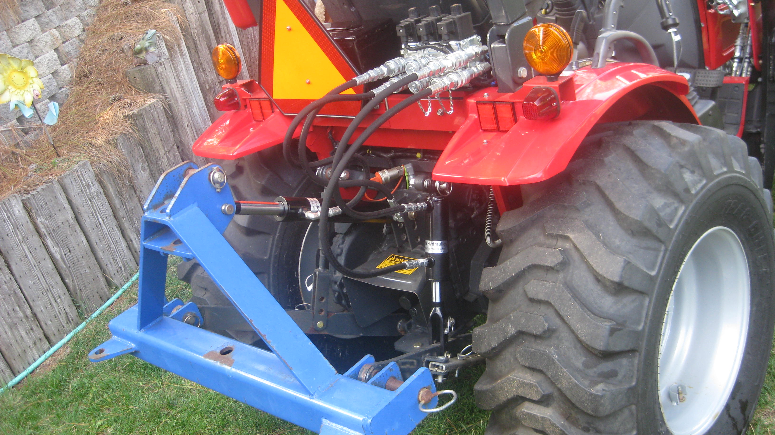

Those pictures are when I very first got that tractor, only a single rear remote was available on those models, still that way with the smaller 38hp and down Mahindras. I installed a 2 spool valve and used that for a couple of years and then needed 4 sets of remotes so went with 3 diverters. Controlled by the single OEM valve. Fairly clean installation I think. :thumbsup:
